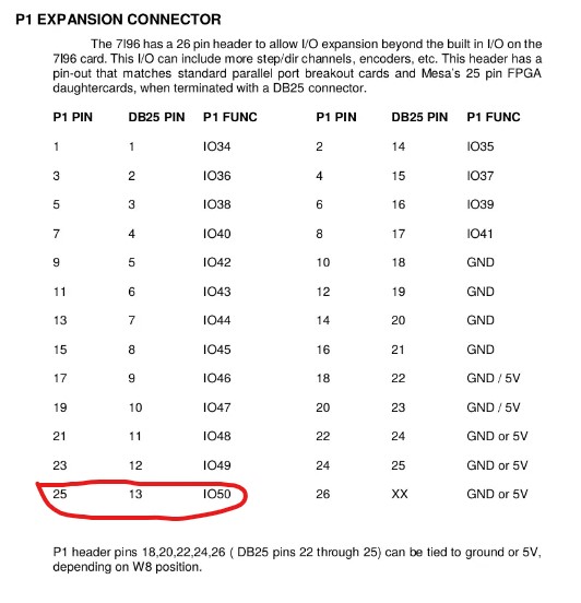

7i96 - P1 CONNECTOR - 15 mA for sink - it is not good

Replied by PCW on topic 7i96 - P1 CONNECTOR - 15 mA for sink - it is not good
OK its R38
It looks like it was a deliberate change to allow better operation with G540 drives (that need more high drive on the charge pump signal = DB25 pin16 =GPIO50)
I will fix the documentation

I have an application where I use a 7I37TA card to protect P1. Will this resistor not bother her?

It si not DB25 pin16. It is lucky 13.OK its R38
OK
It should not interfere with any Mesa daughter card but might cause issues
with some parallel port BOBs
I checked the BOM and its 300 Ohms there, not sure if it was done for a reason
or was just a mistake.
