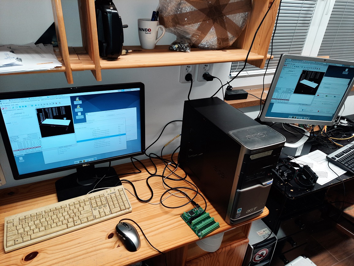

I then created a workplace to test this theory. At home I connected two 7i96 Mesa cards to two computers. I uploaded the same firmware to both cards, uploaded the same LCNC config to the computer and ran the same G-code as my friend had.
First, I ran the G-code with the same settings as my friend. Both computers stopped working after about an hour. I then increased the STEPGEN_MAXACCEL value to double the MAX_ACCELERATION value and now the two computers are running the second nine-hour G-code without error. I also made this change at my friend's, and his machine can now handle long programs as well.

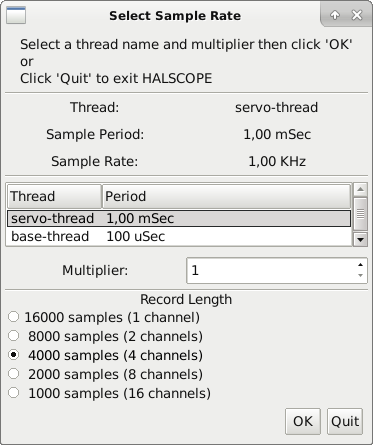

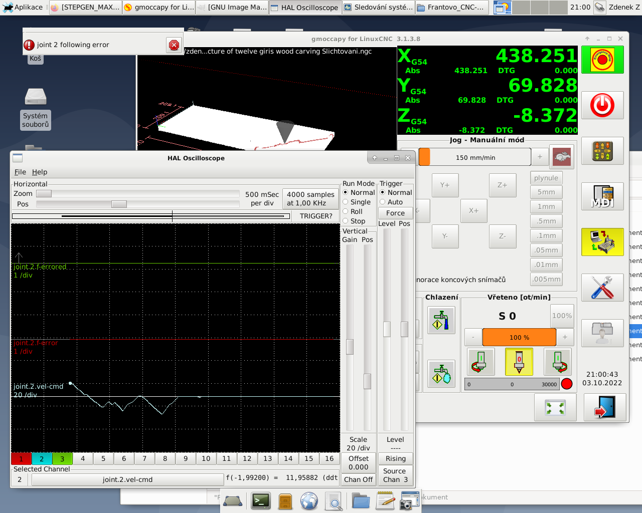

03 Oct 2022 16:15 - 03 Oct 2022 16:27 #253356
by zz912
Replied by zz912 on topic STEPGEN_MAXACCEL from PNCconf
Do I have the oscilloscope set up correctly?
The problem is that two computers are stuck on "joint 2 follow error" and one computer is stuck on "joint 0 follow error".
I don't remember which one it was on.
At the same time, the error appears sometimes in 1 hour, sometimes in 4 hours.
That's why I'm asking you to check the Oscilloscope.
Idealy, if you should send me config of HAL Scope.
Last edit: 03 Oct 2022 16:27 by zz912. Reason: I asked for config of HAL Scope.

03 Oct 2022 16:37 - 03 Oct 2022 17:45 #253357
Replied by PCW on topic STEPGEN_MAXACCEL from PNCconf
That looks about right except I would scale the following error so
the following error limit would be on screen.
Also could you post your current hal/ini files?

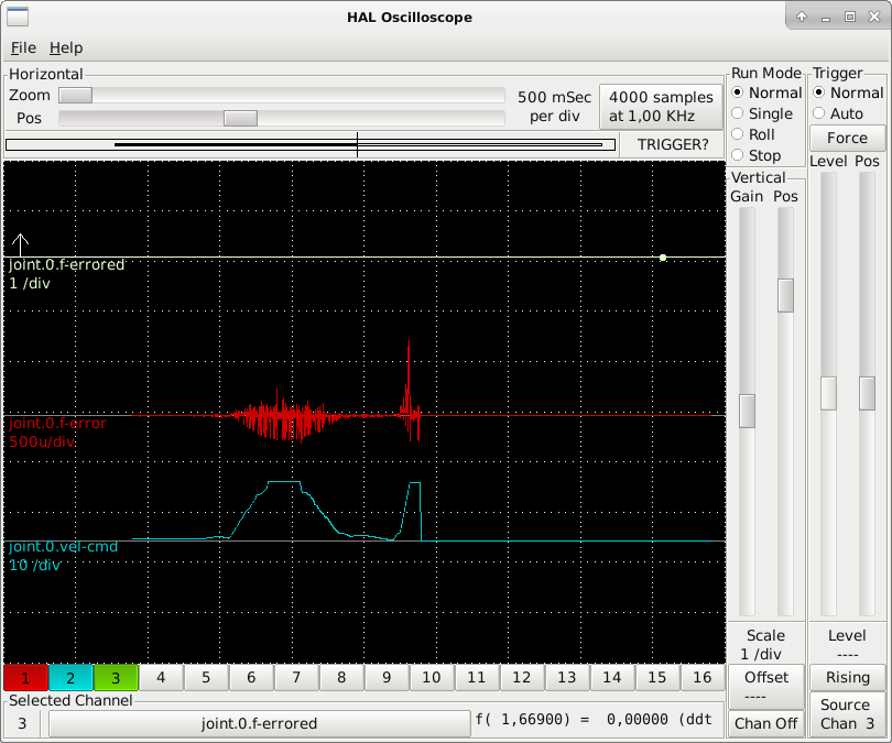

04 Oct 2022 04:14 - 04 Oct 2022 04:37 #253412
what are the ferror limits?
I would also use no slower than 100 ms per division
as you may lose samples at slower rates
(note there are only 4000 samples but 500 ms*10 divisions is
5000 servo thread cycles so you may miss details)
Last edit: 04 Oct 2022 04:37 by PCW.

04 Oct 2022 14:21 #253451
If you set the time per division to100 ms, can you see the ferrored signal?
Unless that can be captured, this will be difficult to debug
Can you set the scope to single sweep (so if you have a captured ferrored signal
its guaranteed that the scope captured it)
You might check the scope setup by deliberately generating a following error
(say by setting the PID maxoutput to 0.01)
