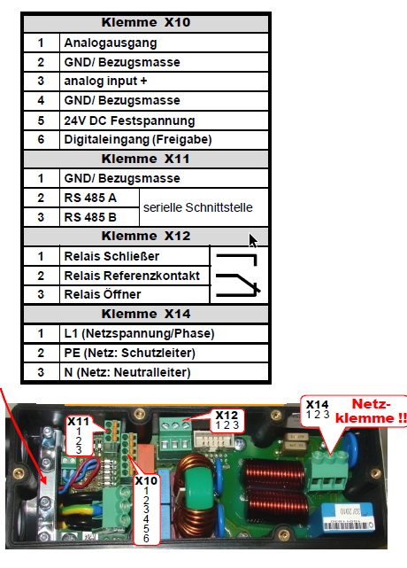

I got myself a vacuum pump which I now want to control with LCNC.
I have the following possibilities to connect it:
I have the following components:
- Mesa 7i76ED with 7i84D via RS422.
- Bit-file on the 7i76e is "7i76e_7i76x1_5abobpD".
- on P1 parallel expansion is connected a 7i75.
I need a 0-10V signal at the analog input (X10:3).
Can I do this with my Hardwear or do I need something additional?
TB4 of the 7i76ED is already occupied by the spindle!

Depending on whats connected to the 7I75, one possibility is to use
a "Mach 5 axis BOB" on P1, that would an additional analog output

Yes, you can connect a Mach 5 Axis BOB to one of the 7I76E expansion ports
and use 7i76e_7i76x1_5abobD.bit firmware.
