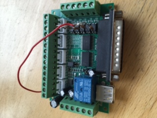

Replied by PCW on topic Control of a vacuum pump
The 5ABOB requires 12-24V for the inputs and analog out
and 5V for everything else, not sure about your input
modifications...
You don't need to use the USB connector that's just for 5V
I would use a 5V terminal instead
modifications...
