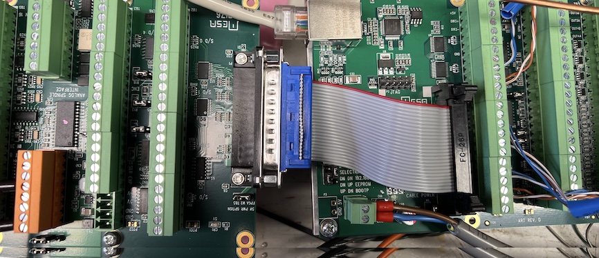

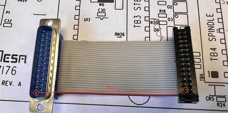

I've got my daughter board connected with a custom DB25->26 pin cable but I can't seem to talk to it.  I'm a bit suspect of the cable, this is the second one I;ve made.  I've tested the pins and they have connections and I'm pretty sure they're correct otherwise I'm pretty sure the pwr wouldn't work.
The 5V pwr LED is on, it's powered from the DB25 cable from the 26pin P1 expansion connection of the 7i96.  I've got field pwr (24v) to the TB1 field pwr, and the field pwr LED is lit (I know it's not needed).
I've flashed the 7i96s via MesaCT with 7i96s_7i76d.bin.
If I do a mesaflash read HMID it seems to only show the 7i96 pins.
I've tried to load it in HALRUN to see what it can see but I'm pretty sure I'm only seeing pins for the 7i96s as I would expect(hope) to see something like: hm2_7i96s.0.7i76.....
So I'm not sure if it's cable or a config issue.
I've looked at a post from PCW here, and I've read the man pages but I'm lost as to what the config string should look like (I've tried a few different variants from none to spelling out 3 of them to what's below).
Any tips on how to test my setup to isolate where I've missed something (or cable) would be appreciated.

17 Jun 2023 01:00 #273729 by camb0
I've bench tested the continuity of the pins with my volt meter, they're all connected.
I've checked pin 1 against the diagrams and I think I've got it correct but I might have misread it.
Here's a pic of the cable with pin 1's aligned (note the 26pin end has a socket on it to make it easier to test) the 26 pin locating boss is on the left (first pic).
Last pic is of the cable installed.
17 Jun 2023 02:47 #273730 by PCW
W1 must be in the left position
The following user(s) said Thank You: camb0
17 Jun 2023 05:15 #273733 by camb0
Yahtzee!!!!
I see the 7i76 now, thx a bunch for your assistance and patience.
