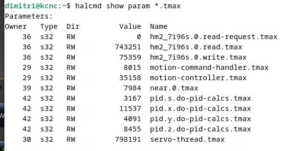

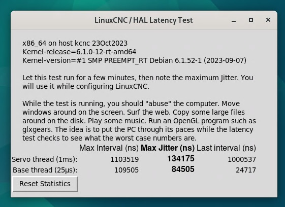

Hello all,
I am using a Mesa 7i96S coupled with a mini PC for LinuxCNC but I am facing what seem to be latency problem.
Sometime, I get a error at startup complaining about a abnormal task delay of over 1000000.
Sometime, it start and work normally but after a few minutes the machine stop with a error like "Error finishing read iter : xxxx".
I really don't know what to look at ?
Here are data that I think will be required to help me :

- Posts: 18115
- Thank you received: 5334
23 Oct 2023 18:09 #283628
Replied by PCW on topic Mesa 7i96S - Error finishing read iter ...
Interpreting the max jitter values requires the CPU clock speed
(as those value are in CPU clocks)
Assuming a ~2 or ~3 GHz CPU those numbers look OK
(but I suspect they were taken before you got an error...)

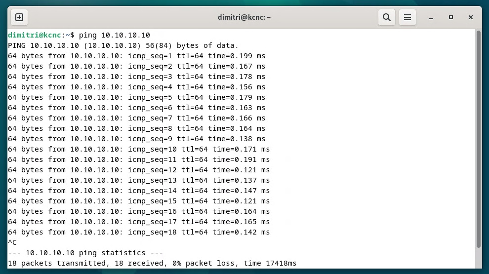

A couple other things that help network latency are
1. If you have an Intel Ethernet chip, turn off IRQ coalescing
(man hm2_eth)
2. Pin the Ethernet IRQ to the last CPU ( setting the Ethernet IRQs smp_affinity to 8 does this on a 4 core CPU)
(man hm2_eth)

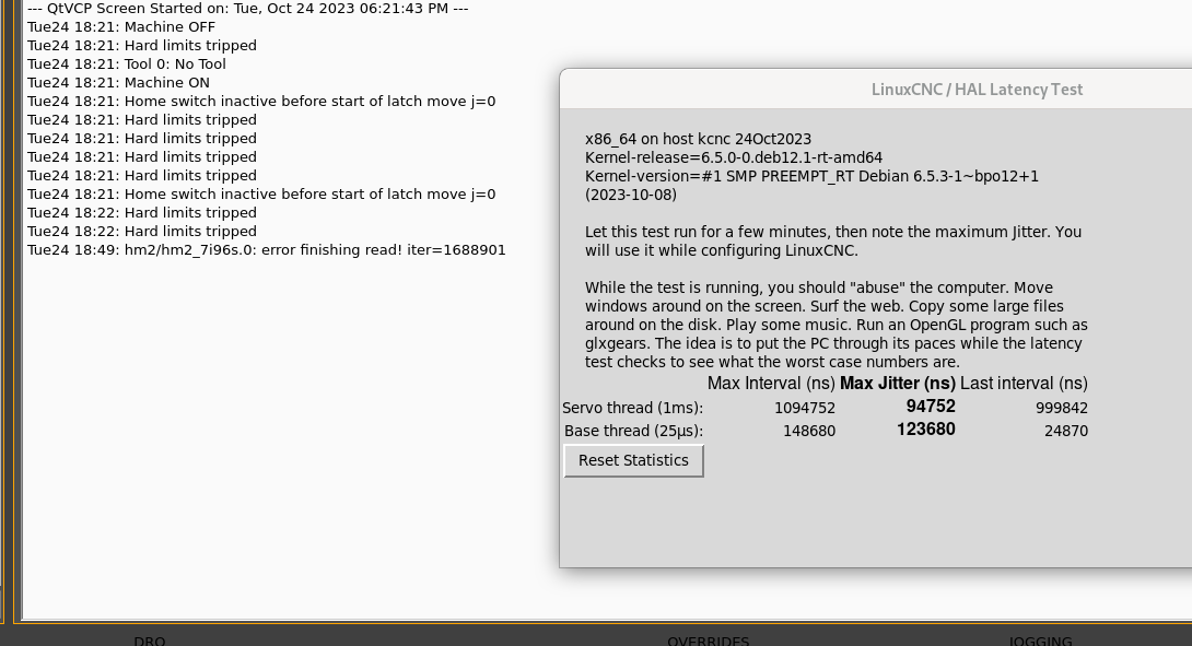

24 Oct 2023 17:27 #283731
by karnalta
I checked the NIC in that mini computer, it's realtek chip.
What is strange is that error happen out of nowhere while idle. As you can see on this screenshot, I have turned on the machine at 18h20 and have homed the axis. Then I have leave the machine alone while eating and when I come back I see that error has happened at 18h49 while doing nothing.
Replied by karnalta on topic Mesa 7i96S - Error finishing read iter ...
I switched to kernel 6.5 but don't really have improvement.
When you get the error, do you have a red LED illuminated on the 7I96S?
Did you try a 2 ms servo thread?

24 Oct 2023 18:55 #283744
by karnalta
Not yet with 2ms thread, is there any negative effect ? I guest if my machine is quite slow it should not induce tracking error ?
I am not sure but it's possible that there is a red led, I have to check again. Does it mean a specific problem ?When you get the error, do you have a red LED illuminated on the 7I96S?
