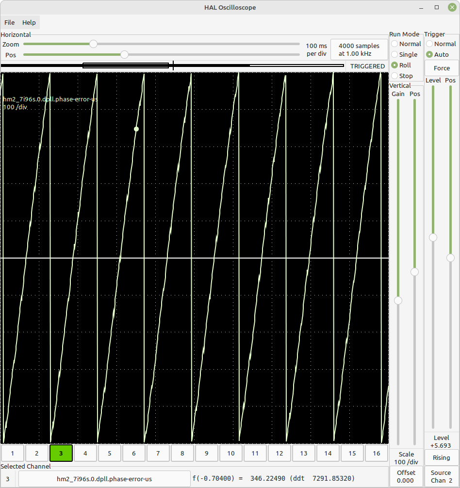

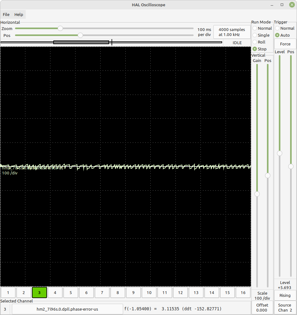

#setp hm2_7i95.0.dpll.base-freq-khz 1.007
setp hm2_7i95.0.ssi.00.frequency-khz 800
#setp hm2_7i95.0.ssi.00.timer-number 1
setp hm2_7i95.0.dpll.01.timer-us -100
Without the timer specified you are guaranteed to get
a data transmission not complete error.
Also you should never have to change the DPLL base frequency
since it's set to the servo thread frequency as the default.
If not a clock or data polarity issue, my guess is that you do not have
DPLL lock for some reason. I would check this by either watching
or halscope plotting hm2_7i95.0.dpll.phase-error-us
Here is an normal plot of the DPLL error (at 100 usec per division) when locked:
Here is a plot (also 100 usec per division) where DPLL lock has been lost:
