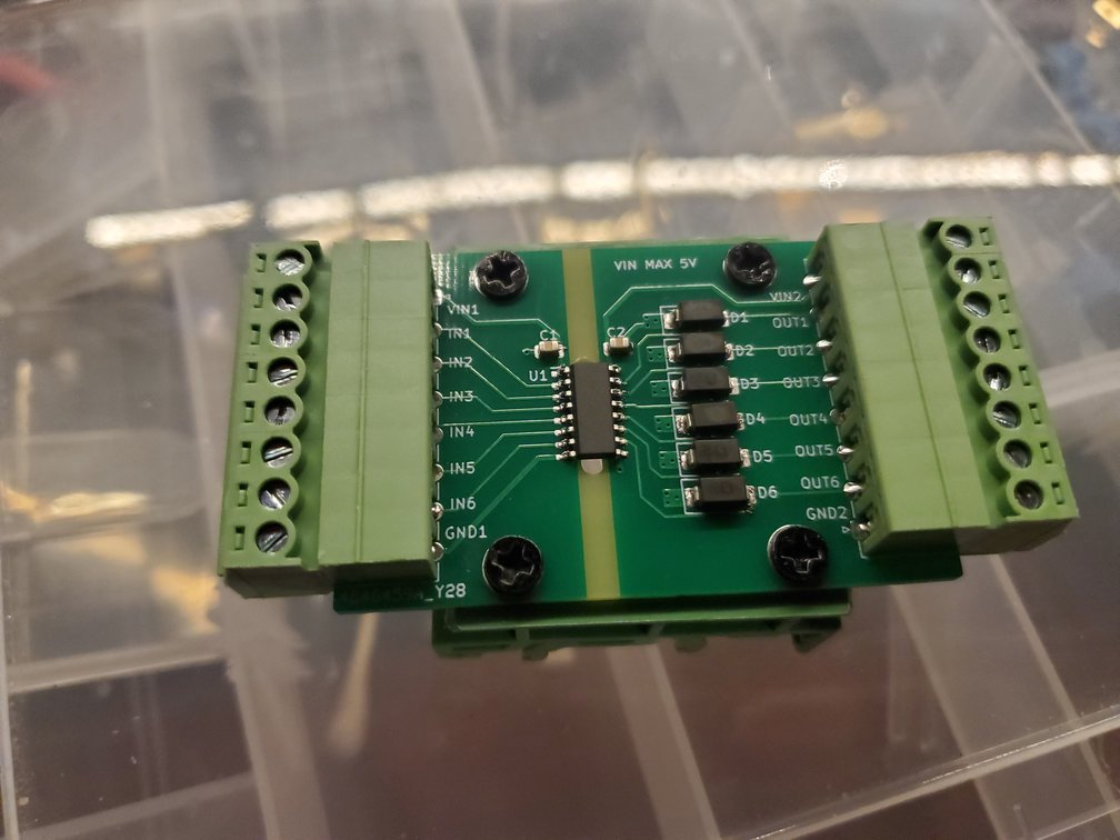

18 May 2024 23:47 #300942
by blazini36
If you actually need isolation on the encoder you might try looking for a magnetic or "digital" isolator. I think they'd be fast enough to handle differential inputs directly, pd is <8ns. I whipped up a few in case I ever needed them, don't think I've bothered to test them for that. I use the same family of isolator for a bunch of serial stuff since they work as simple 3v-5v level shifters as well.
Replied by blazini36 on topic 7i77 encoder split to amp and servo
I don't fully understand your setup but i've never considered sharing a single encoder between 2 devices as a particularly good idea, it's probably espescially bad if one is single ended as the load on the inverting and non-inverting outputs will be different besides however it affects RS422 termination.blazini36,
