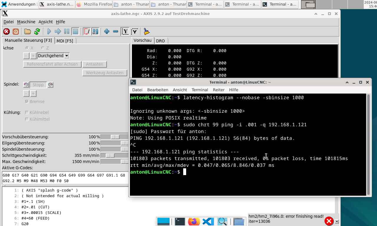

I have run the long ping test 3 times. Here are the 3 results for max:
First ping test: 4.2ms
Second ping test : 3.4ms
Third ping test: 15.9ms
So it didn't get any better.
Above in the attachment I had shown file /etc/network/interfaces.
There I had inserted lines for eth0 as described in man hm2_eth. Do I have to replace eth0 with enp5s0?
Greetings Anton
Greetings Anton

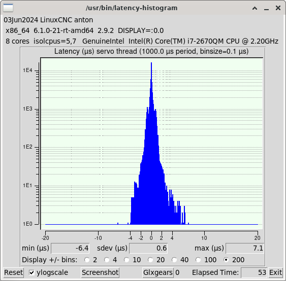

03 Jun 2024 06:44 #302235
by Anton
Replied by Anton on topic error finishing read!
Unfortunately, the behaviour has deteriorated again. After starting LinuxCNC, the finishing read error now appears immediately. The motors can no longer be moved at all. Perhaps this laptop is simply not suitable.
Attached is the histogram and the ping with isolcpus=5.7.

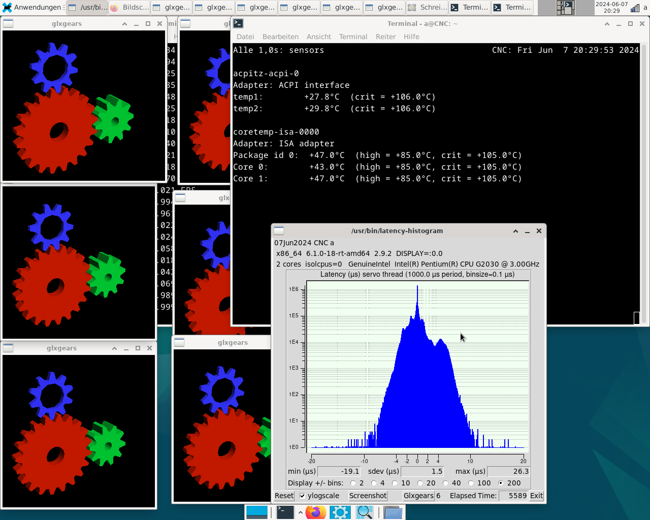

I have installed LinuxCNC on 3 computers so far.
1) Laptop i7: Very good latency times, very poor ping times - > unusable
2) Esprimo Q956 Mini PC with i5: poor latency, good ping - > unusable
3) DELL Optiplex 7010 Mini PC with Intel Celeron G2030 (by far the weakest processor): good latency, good ping (see appendix) -> usable
So the worst of the 3 processors is the best for real-time Linux in terms of latency and ping!!!???
So it must also be due to the mainboard, possibly the memory, ... !?
sunny greetings
sunny greetings

08 Jun 2024 10:51 #302634
Replied by PCW on topic error finishing read!
Most common cause of really terrible network latency
(ping times > 1 ms) is power management setup
Pining the IRQ can help if you are close but if you have 4 ms ping times
the host most likely has power management/speed switching still enabled
