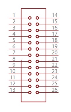

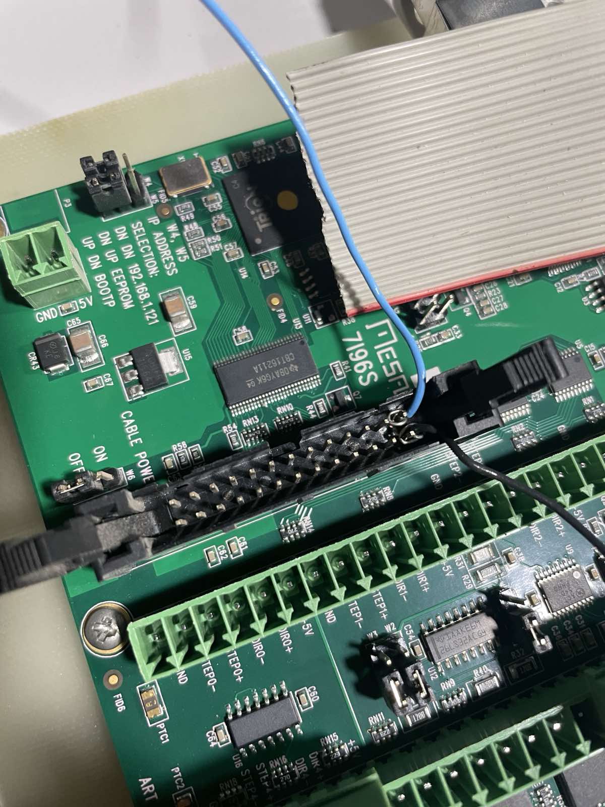

11 Sep 2024 22:33 #309945
by Masiwood123
Replied by Masiwood123 on topic 7i96s +7i83 trough 7i44 is it possible?
- Posts: 18115
- Thank you received: 5334
11 Sep 2024 22:54 #309947
Replied by PCW on topic 7i96s +7i83 trough 7i44 is it possible?
Yes, that looks like IDC 26 pin 1.
Its marked with a square pad on the back of the 7I96S card.
Its also the pin closest to the large white square near P1 on the top of the 7I96S card.
This is also DB25 pin 1
(the rest of the DB25 pinout will be correct if you use an IDC DB25M connector)
- Masiwood123
- Posts: 423
- Thank you received: 93
11 Sep 2024 23:04 #309949
by Masiwood123
- Posts: 18115
11 Sep 2024 23:07 #309950
Both...
Its pin 2 on a HDR26 but ends up being pin 14 of a DB25
(if you use standard IDC connectors on a 1-1 flat cable)

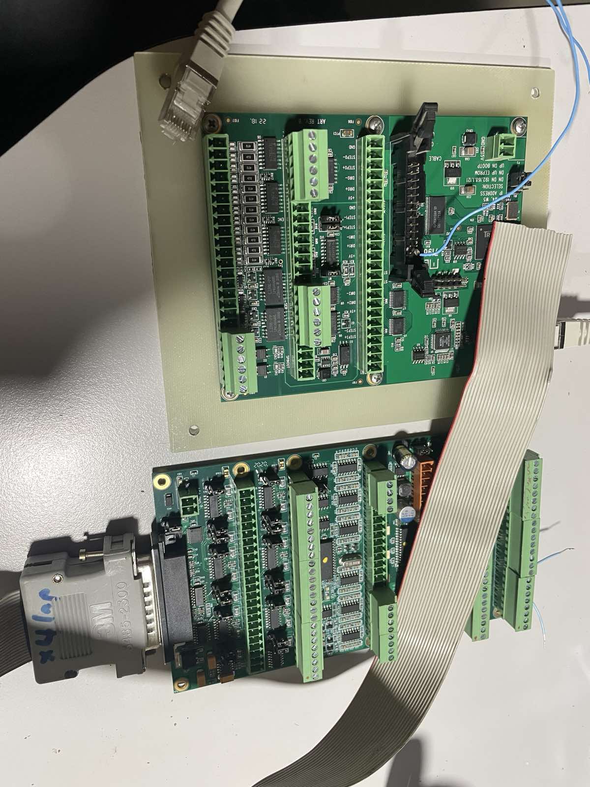

11 Sep 2024 23:12 #309951
by Masiwood123
ok now I understand the logic, I made a mistake, I ordered idc26female but db25 also female, so now, since there are no ready-made cables here, only connectors, I will have to use crimping pliers to make the cables myself.
