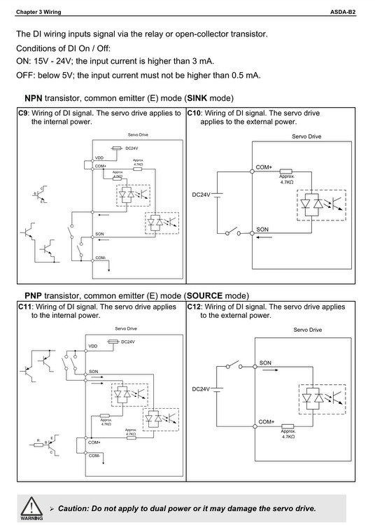

That leaves only the Delta B2 servo drives and the question of what type of input they need. I mentioned I thought the B2s could be setup for either. But I'd love if one of you more savvy guys can take a look at the wiring diagram and tell me if they can and if one is easier to do than the other. So, basically, which type has the least risk of me screwing it up:).

The docs show either sink or source, and each opto coupler has diode going each way (which puts these ones in the "dumb" category with the relay) , so what they show looks right.
They both have the same chance of you screwing up and the same chance of getting it right. It's basically 50/50.

This should mean either daughterboard would be fine as the servo drive DIs were really the only thing left I can think off that would have impacted what to choose. The others were some signals to relays, air solenoids but they don't care, either, it seems.
Anything else I am missing? Any reason left to go with one over the other if the hardware is agnostic?

Thanks man but I don't like my chances then, haha. I guess I'm a glass half empty kinda guy;)The docs show either sink or source, and each opto coupler has diode going each way (which puts these ones in the "dumb" category with the relay) , so what they show looks right.
