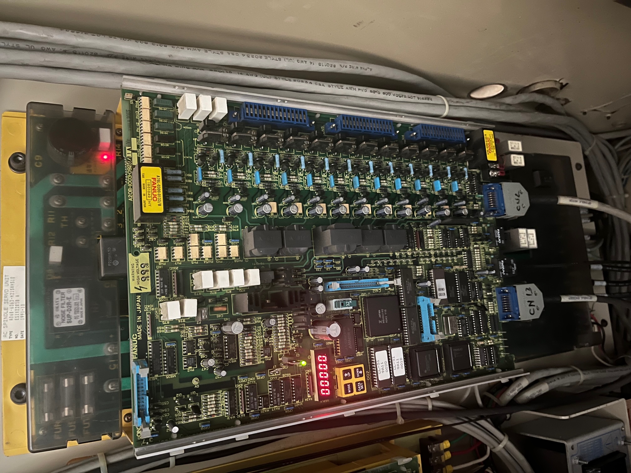

I have attached a photo of the spindle drive currently installed [Fanuc A06B-6063-H215#510]. Does anyone have any experience controlling this type of drive with LinuxCNC?

It's hard to find anything clear on Fanuc stuff, but I think the spindle amp uses serial communication to/from the Fanuc control.  So while it may be possible... it'd be non-trivial unless you can find someone who's done it already.

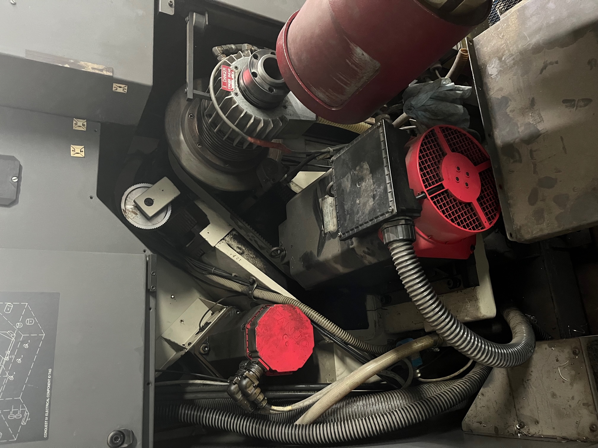

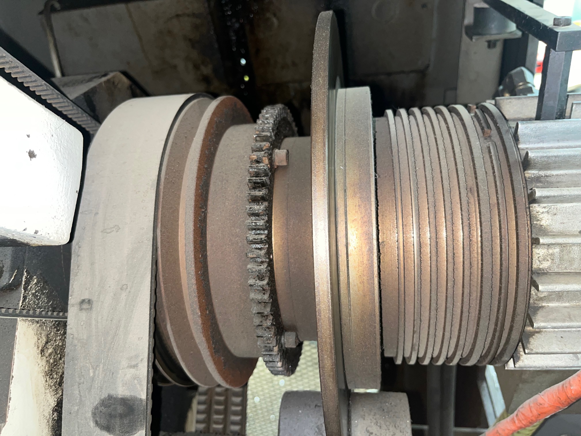

Some photos of the Hardinge Conquest spindle for those interested. This machine has an epoxy/granite base that you can see a little chunk broken off of in one of the photos. There is a gear-looking ring on the spindle that two separate pins can engage with (odd/even labels in documentation, maybe that stands for odd/even degrees based on their offset). Makes me think that a retractable worm drive could be fitted there in place of this system but that definitely seems more mechanically involved as it would have to be all custom. I wonder how Hardinge did their Conquests with full C axis..

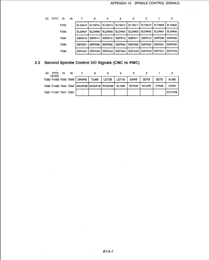

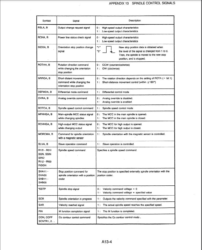

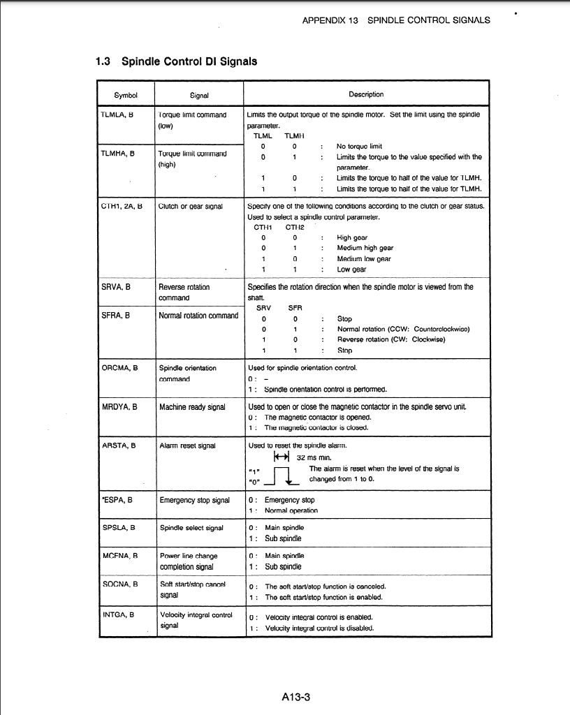

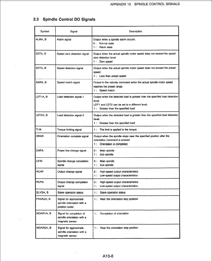

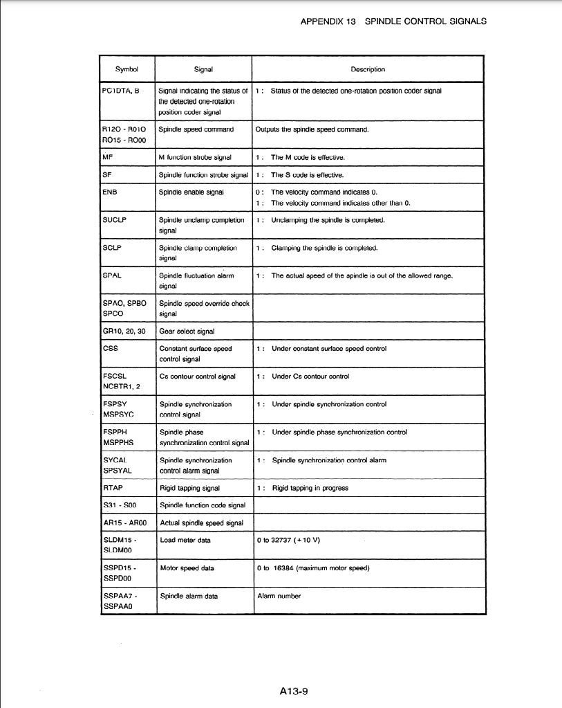

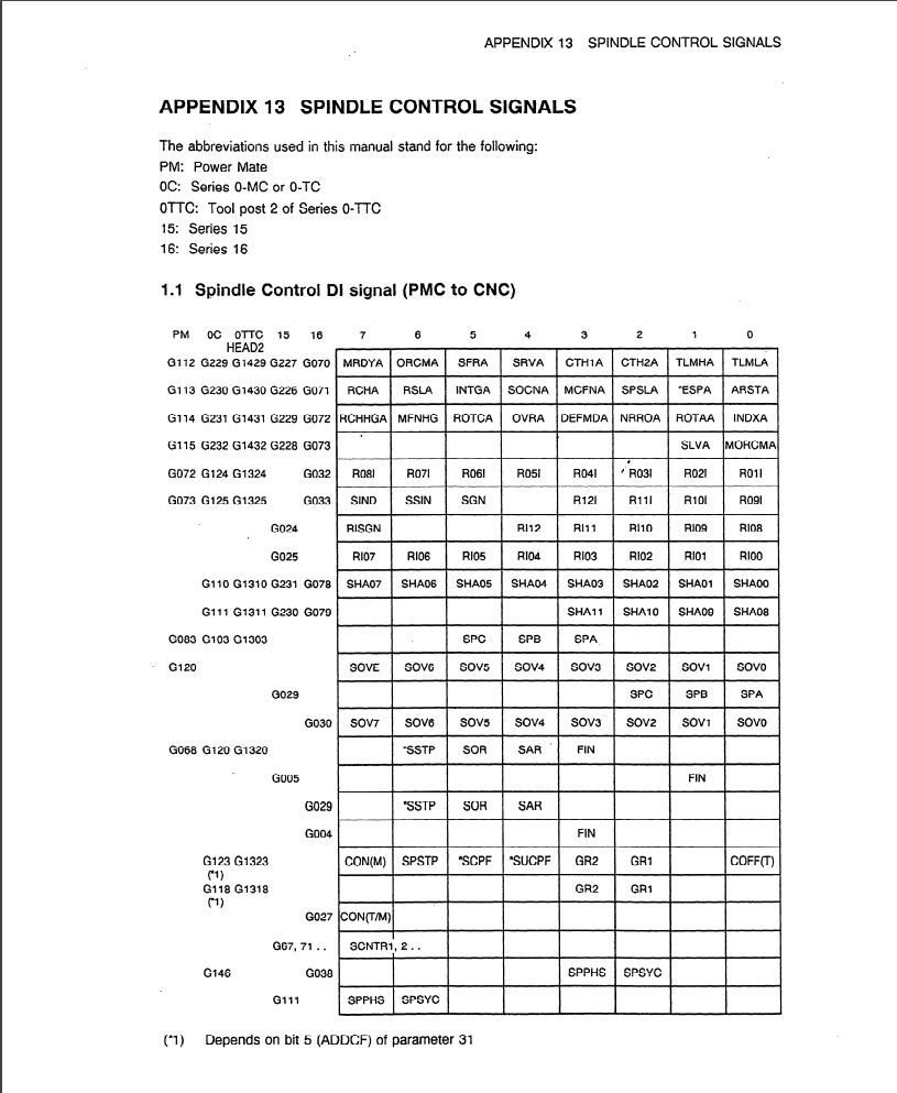

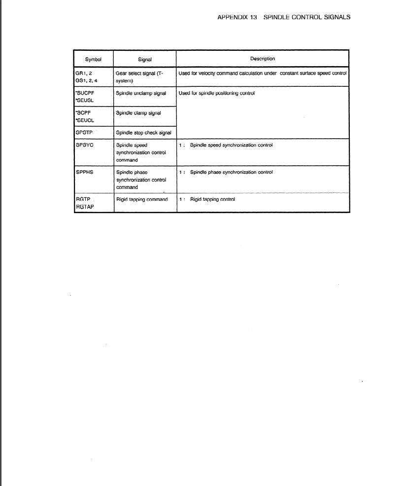

For those with any experience with this kind of serial control, here are some pages from the service manual describing the control commands. Does anyone having any experience interpreting this kind of data and maybe finding a way to link this up with linux cnc? Might be in over my head but worth a look anyway.

05 Aug 2024 19:50 #307029 by bnet

I'd bet decent money that the gear looking thing the pins engage IS the C-axis gear.  It's painted, but shows no real signs of wear... because your lathe didn't have the C-axis option.
The pins are strange.  Pneumatic lines to actuators, and proxy sensors if the pins are retracted... fishy.  No idea what they do, other than maybe they're part of an alignment mechanism.
Hypothesis: Perhaps when C-axis is commanded, the main spindle rotates slowly to the encoder index, then one of the pins drops in place (indicating gear alignment with axis servo), then is retracted with the air after the C-axis servo is swung in to engage the bull gear.  That way the gear alignment isn't dependent on the encoder index pulse if the belt is replaced.
If you can find a pic of another lathe I bet you'll see a servo and some sort of swing-arm bracket so a spur gear on the servo can be brought in to mesh with the spindle gear using an air or hydraulic cylinder.  Just like the miniature version on my lathe.
I think asking on Practical Machinist would be your best bet, or call Hardinge and see if they've got any older repair/parts manuals.

06 Aug 2024 01:48 #307052 by bnet

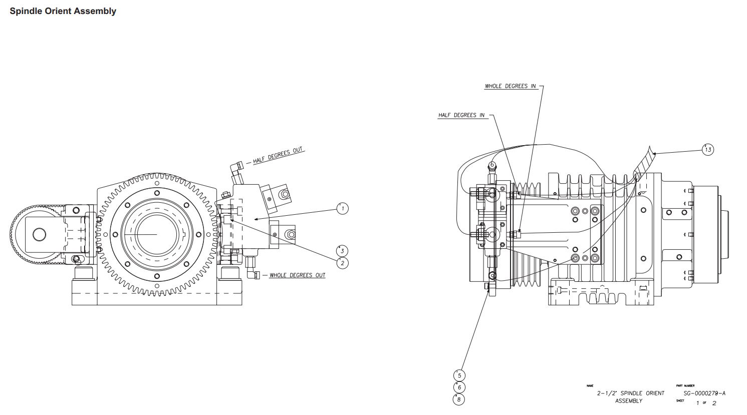

Could be the case! I'm thinking that it is mostly just a hard-index system for the C-positioning feature. Maybe it could be used for full C though, will have to look into the type of geometry that is usually used for that kind of worm gear.

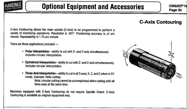

Here's what the parts manual has to say about the indexing system we speak of:
The parts diagrams can be viewed here:
shop.hardinge.com/medias/sys_master/imag...PLA-0009500-0060.pdf
Strangely, the component list/diagrams that Hardinge offers do not say anything about the original equipment used in the c-axis contouring option, yet it outlines parts for every other optional add-on.
Maybe I'll give Hardinge a call or ask on Practical Machinist. Either way my implementation will have to be something I can pull off and integrate into the LinuxCNC environment.
