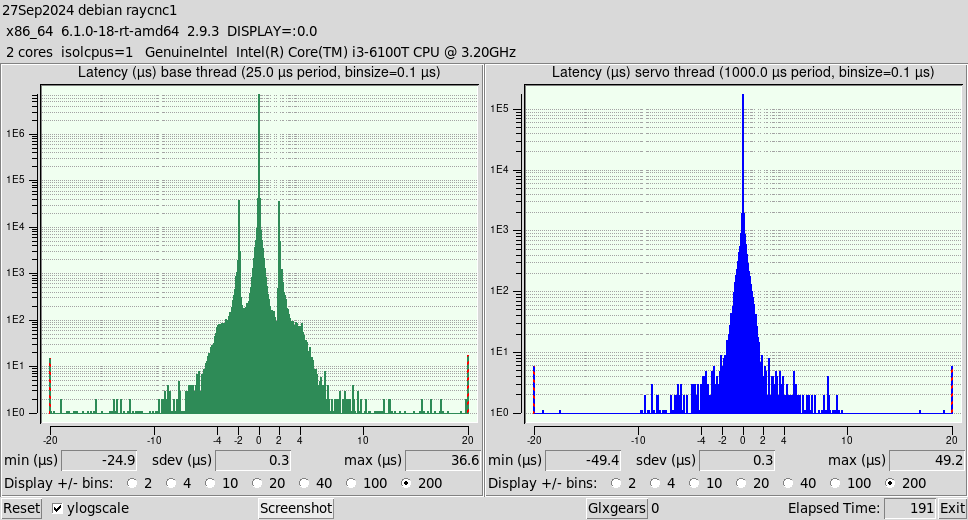

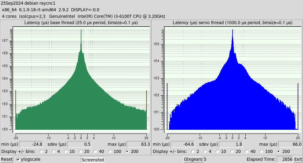

One confusion I could not clear..My CPU is Intel i3 6100T.
www.intel.com/content/www/us/en/products.../specifications.html
As per this link, it has 2 core. The "lscpu" result is just in above post.
But in latency histogram, core=4. (attached)
Why??
Why??
- Todd Zuercher
- Posts: 4792
- Thank you received: 1479
25 Sep 2024 12:57 #310767
Replied by Todd Zuercher on topic Error while Running Linuxcnc
Do you have Hyper-threading enabled? Hyper-threading creates two virtual cores for each real core, so that a 2 core CPU is seen as 4. Hyperthreading gives poor latency results with real time, turn it off or disable it in your bios.
The following user(s) said Thank You: rajsekhar
- rajsekhar
- Posts: 206
- Thank you received: 12
25 Sep 2024 16:38 #310790
by rajsekhar
Replied by rajsekhar on topic Error while Running Linuxcnc
Yes, hyper threading was on. I disabled it. Also turbo boost was on, now disabled. But there is very negligible improvement in latency.

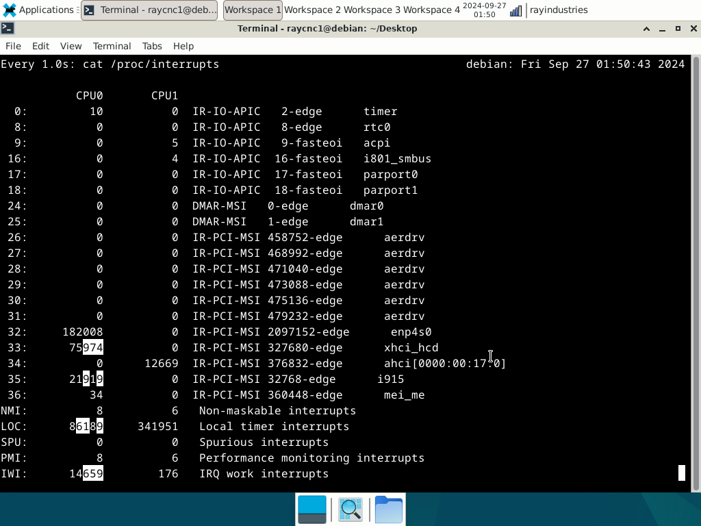

Now as per my last post above today (ip a result) , I assumed that my ethernet card is "enp4s0". I am not sure whether I am right, if wrong , please reply.
And I set the IRQ affinity as per this post of course:
forum.linuxcnc.org/38-general-linuxcnc-q...ead-and-irq-affinity
The "journalct1 -b -u irqbalance.service" resulted some command error.
But "watch -n1 -d cat /proc/interrupts" resulted output which is attached in photo (as irq number changes continuously, not possible to copy/paste).
In that result CPU0 is handling all the Interrupts while running LCNC(182008 in exact in photo) for "enp4s0". Is that correct? I was expecting exactly opposite, interrupts to be in CPU1. I have done isolcpu=1. histogram attached.
