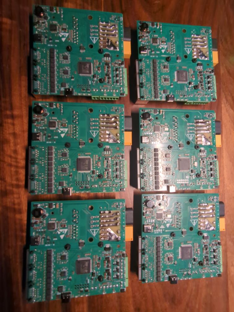

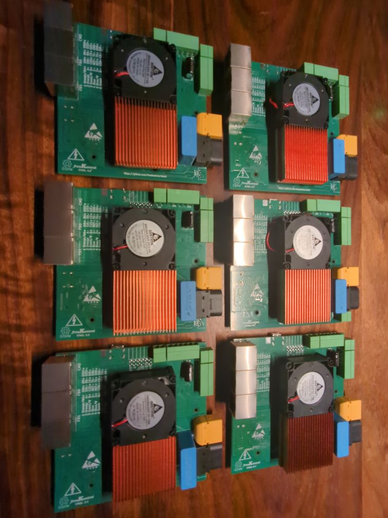

Here are some boards I finished assembling and tested, they seems to perform very well, I will share the video of a big robotic arm (3 ton) running with these. The motion is smooth and very quiet.

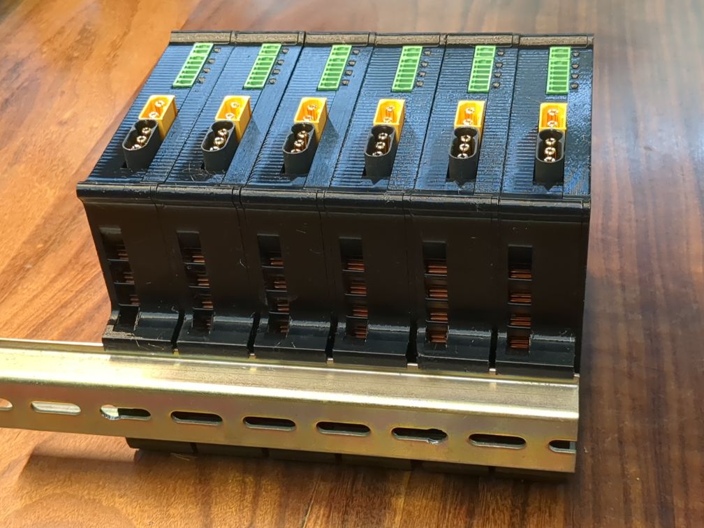

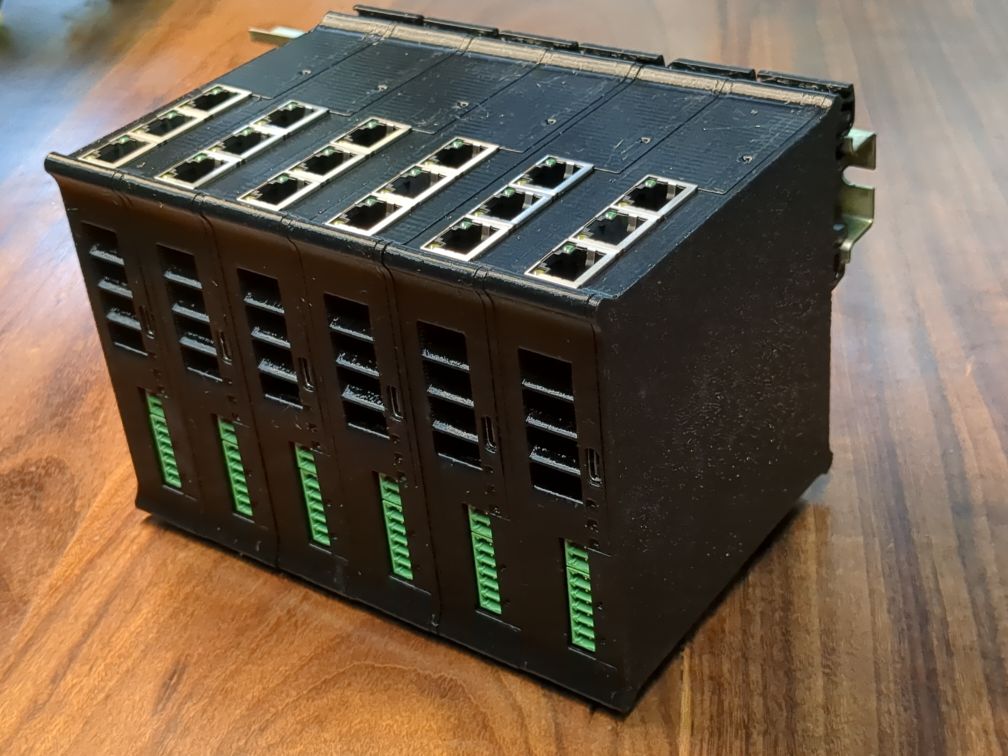

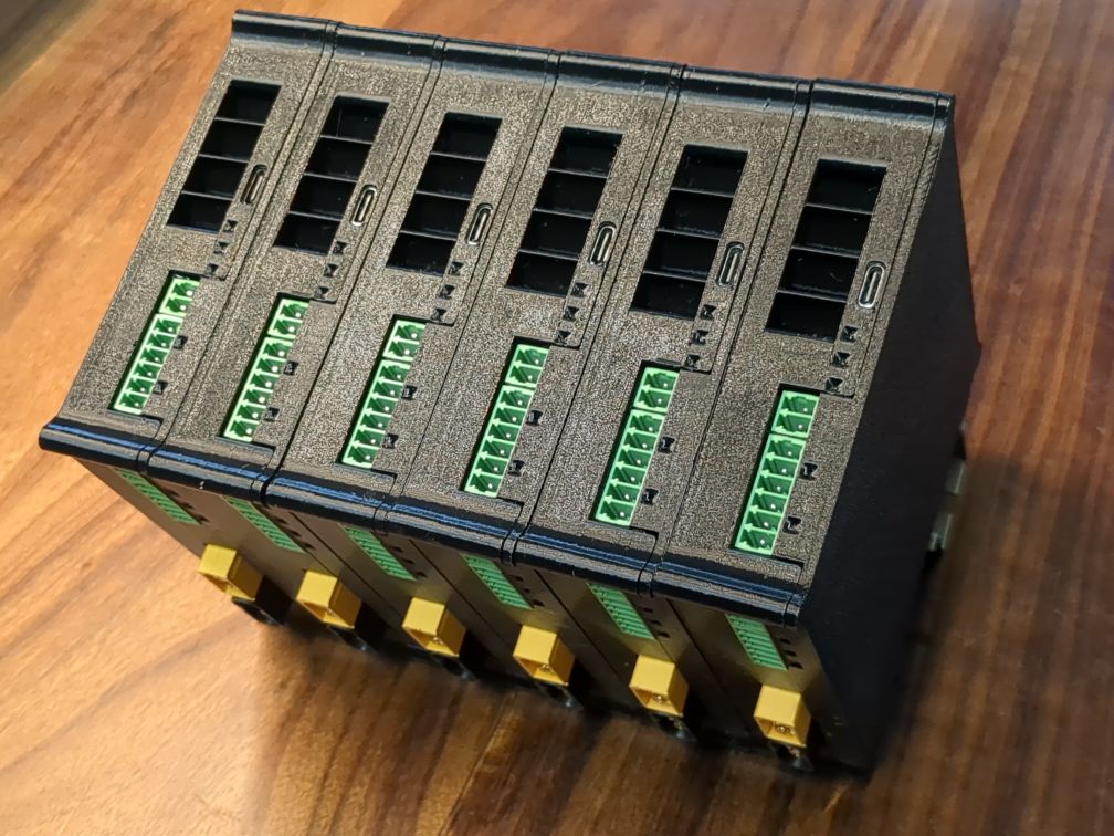

Here some pic assembled with the case.
Much more space in the cabinet now

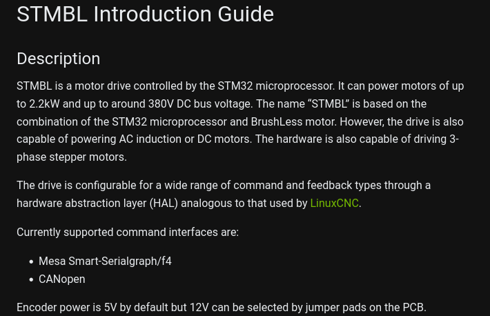

I have a Kuka kr200 robot and its motors are brake motors between 1.5~kw and 4.5kw. My robot does not have its own board. I want to make it with STMBL. I need a guide. Probably via Mach3.
17 Mar 2025 08:12 #324097 by Aciera
Replied by Aciera on topic New update on STMBL
You might want to start by looking at the documentation:
freakontrol.github.io/stmbl/docs/introduction/
Seems it's max power output is 2.2kW and apparently does not provide a command interface that is compatible with Mach3:
17 Mar 2025 13:08 #324110 by Overspeed
Replied by Overspeed on topic New update on STMBL
but how is that possible there are a lot of sample videos with mach3 stmbl v4
