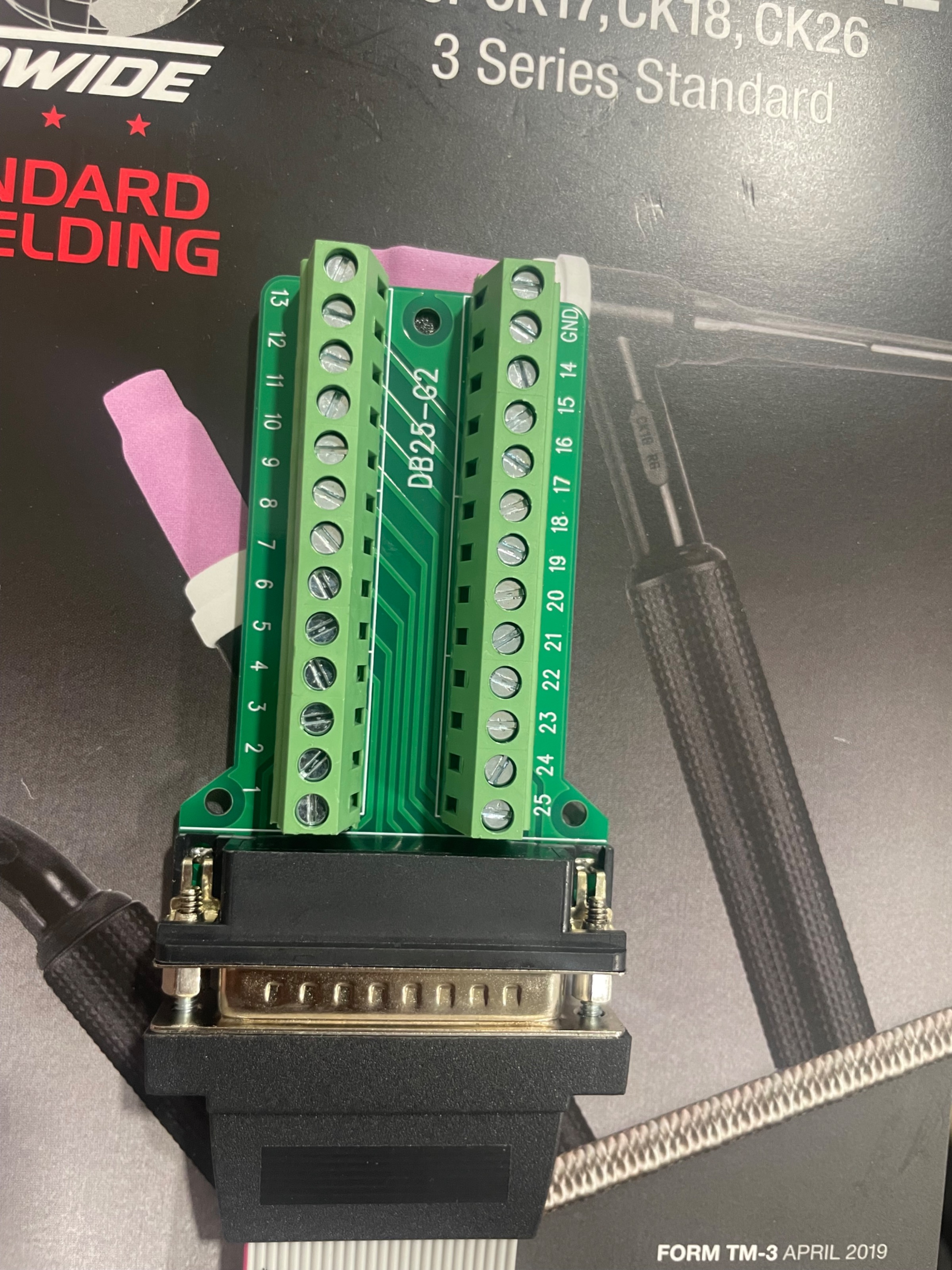

I can’t figure out how to set up a bob on the 7i97t.
It’s just a simple pass through breakout.
Can I use the idc26/bob with normal 7i97t firmware?
I was trying to set it up using my existing hal file, but I don’t know what the idc pins are. Like the equivalent of hm2_7197.0.ssr.00.out-1 or hm2_7197.0.inmux.00.input-1.
Ive tried setting it up in mesact with both 7i97t_d.bin and 7i97t_5abobd.bin, but inputs/outputs 16+ are grayed out.
I also tried with pncconf. If I use the inputs/outputs in the io3 tab, then linuxcnc won’t launch saying they don’t exist.

Well, it's likely to depend on the pinout of the BoB.
So the first thing to try would be to find which firmware suits the BoB, as the pin assignment of the 7i97 is fixed by the firmware.
(Whilst you could switch it by rewiring the cable between the BoB and the 7i97, doing that with ribbon cables is fiddly at best)
If you start linuxcnc from the command-line then as soon as the Mesa card loads it will print out the pinout (even if the startup of LinuxCNC subsequently fails)
Start with the config tool that gets closest, and then accept that you are probably going to have to do some hand-editing of the HAL file later.
(The initial concept of HAL was for it to be entirely hand-generated, you shouldn't be scared of it)

Picture?It’s just a simple pass through breakout.

If you just need GPIO all 17 P1 I/O pins are available as GPIO
with the default firmware.
The GPIO numbers vs P1 pins are listed in the .pin file:

Each GPIO pin (GPIO 50 = DB25-13 shown here)
Will have three hal pins available for connections
in your hal file:
hm2_7i97.0.gpio.050.in
hm2_7i97.0.gpio.050.in_not
hm2_7i97.0.gpio.050.out
and three parameters that need to be set
appropriately if the GPIO pin is an outrput
hm2_7i97.0.gpio.050.is_output
hm2_7i97.0.gpio.050.invert_output
hm2_7i97.0.gpio.050.is_opendrain
All GPIO pins startup as inputs so the "is_output"
parameter must be set "true" for any GPIO pin you wish
to use as an output

What I’m trying to do is to hook up a bts7690 h bridge to drive a dc motor.
So i think need more than just gpio. I was under the impression I could treat it like a parallel port using pwmgen/stepgen.
If i load the firmware 7i97t_5abobd.bin(the only choice I see in mesact for bob) linuxcnc fails to load with the message-
hm2_7i97.0.pwmgen.00.dither not found.
Which is for my servos that are connected to the 7i97, not the bob.
If I just ignore that for now, I see
Io pin 036 (p-1-04/DB25-15): StepGen #0, pin Step (output)
How would that look in Hal?
hm2_7197.0.stepgen.00?
If I wanted to use a pwm, I’d need a firmware that starts at pwmgen #07? since pwmgen.00-.06 are already used for the 9t97?

Try this incantation at the command-line. It will give you a full set of pin and parameter names, without the complication of the rest of LinuxCNC.
Everything that is in the HAL file can be run interactively at the command line. Which is often very useful when debugging.
halrun
loadrt hostmot2
loadrt hm2_eth board_ip=192.168.1.121 (or whatever you are actually using)
show pin
show param

Here is firmware that includes the PWM dither option:
This also brings out the PWM direction pin (It was left as GPIO
on the previous firmware)
Note when connecting 7I97T P1 pins to a power device
(that will likely have large negative switching spikes)
Its a good idea to add a say 100 Ohm series resistor
to all P1 interface pins used to avoid damage to the
input clamp diodes

I tried to use the files you sent, but I’m still having the dither not found error.
I replaced both the .bin and .vhd files in the file directory.
I then used mesact to flash.
I assume I’m skipping a step.

Yep. Tried reload in mesact, tried restarting the computer, power cycled the 7i97t, in every combination, together and separate.
but I also tried flashing 7i97t_d.bin and linuxcnc starts without the error every time.
Then I’ll try 7i97t_5abobd.bin and it I get the same error.
