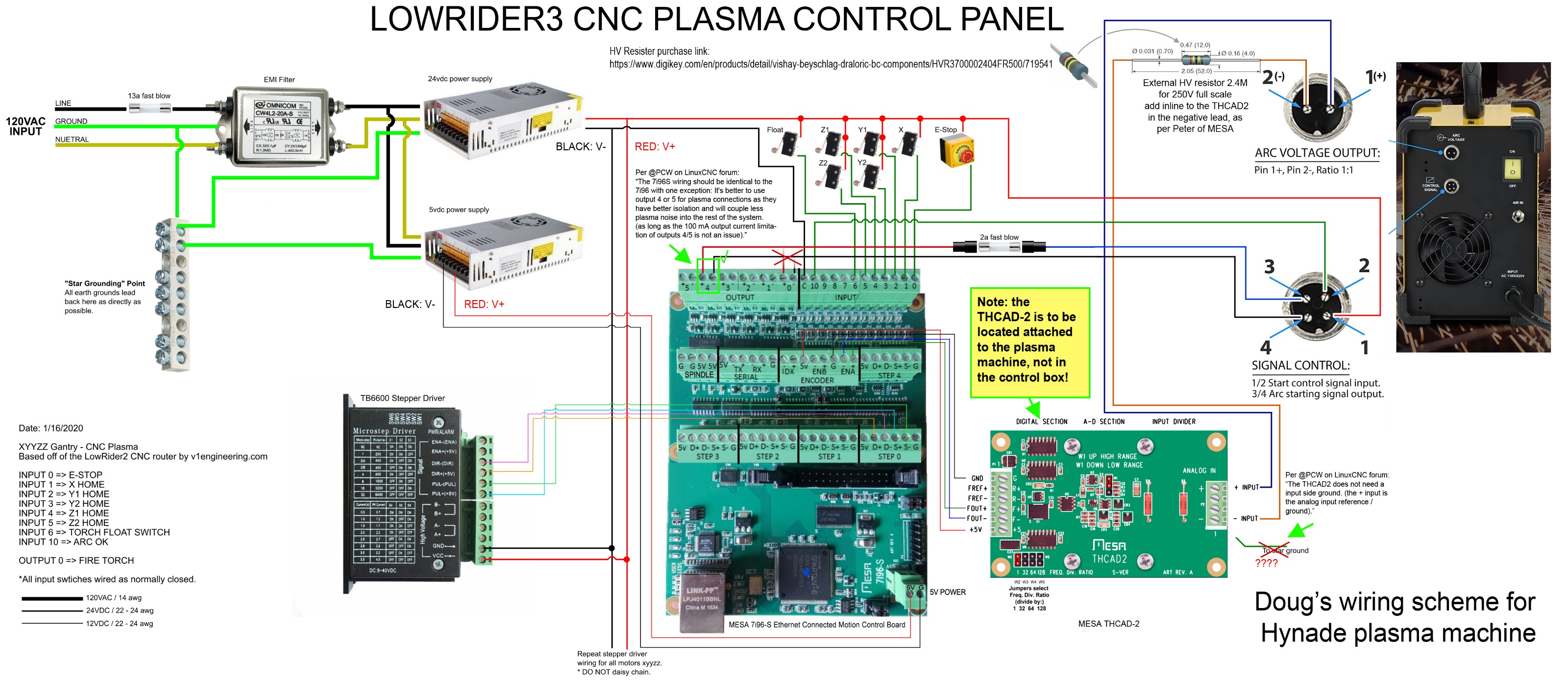

I am building a CNC plasma table and I am going to use QtplasmaC. I am trying to find out the correct pin out for Torch on/off and Arc OK. I am using the Mesa 7i96S board with a THCAD - 10. I have attached the wiring diagram I am using but it is for a plasma cutter with external connectors. The plasma cutter I am using is older and does not have any of those.

That would require opening the plasma source and wiring in the torch on, voltage, and optionally arc ok signals.
That is also very dangerous and requires some electrical experience, do you have anyone to help with that?

Doesnt QtplasmaC have the option to read voltage for the arc ok? It reads the voltage from the THCAD - 10 for the THC

Yes it does, and it works perfectly well with most plasma sources, so you can skip that.

As Tom has indicated you need to open your plasma cutter and wire a voltage divider inside the cutter. I have attached diagram with an example for cutter with 250V, yours might be different you may need to determine the proper resistors values. (Please use high voltage resistors in kilo-volts range).
For Arc OK signal we need to know the make of your cutter or even better a wiring diagram to determine the wiring points if they exist.
The plasma cutter I am using is older and does not have any of those (external connectors).

From my research on the forum I have been able to determine that I can either Set PlasmaC to Mode 0 and set Arc OK Low in the Config Panel to around half the expected arc voltage or use a reed relay on the torch lead. Which will eliminate any need to wire an arc on because the machine belongs to a makerspace I am building a plasma table for. I have not been able to find a pin out for the 7i96s mesa board showing the torch on/ off connection. I am planning on using a relay for the torch. I do have a voltage divider that I will wire up to the machine that was made specifically for a plasma machine. I am sorry for all the questions. I am completely new to mesa cards. Upgrading from GRBL and Arduino.

Take some pictures of the plasma source and upload them here, so at least we have a direction to point to.
Again, do you have anyone to help you with wiring, with electric/electronic experience?

Does your plasma make flames in mid air without touching material when you press the trigger?
Replied by tommylight on topic Mesa 7i96s torch on/off connection
Plasma source without pilot start can not be used for cnc cutting, it can not start an arc in mid air, it has to be touched to the material to start cutting.It is an Everlast Supercut 50 (w/o a pilot arc)
