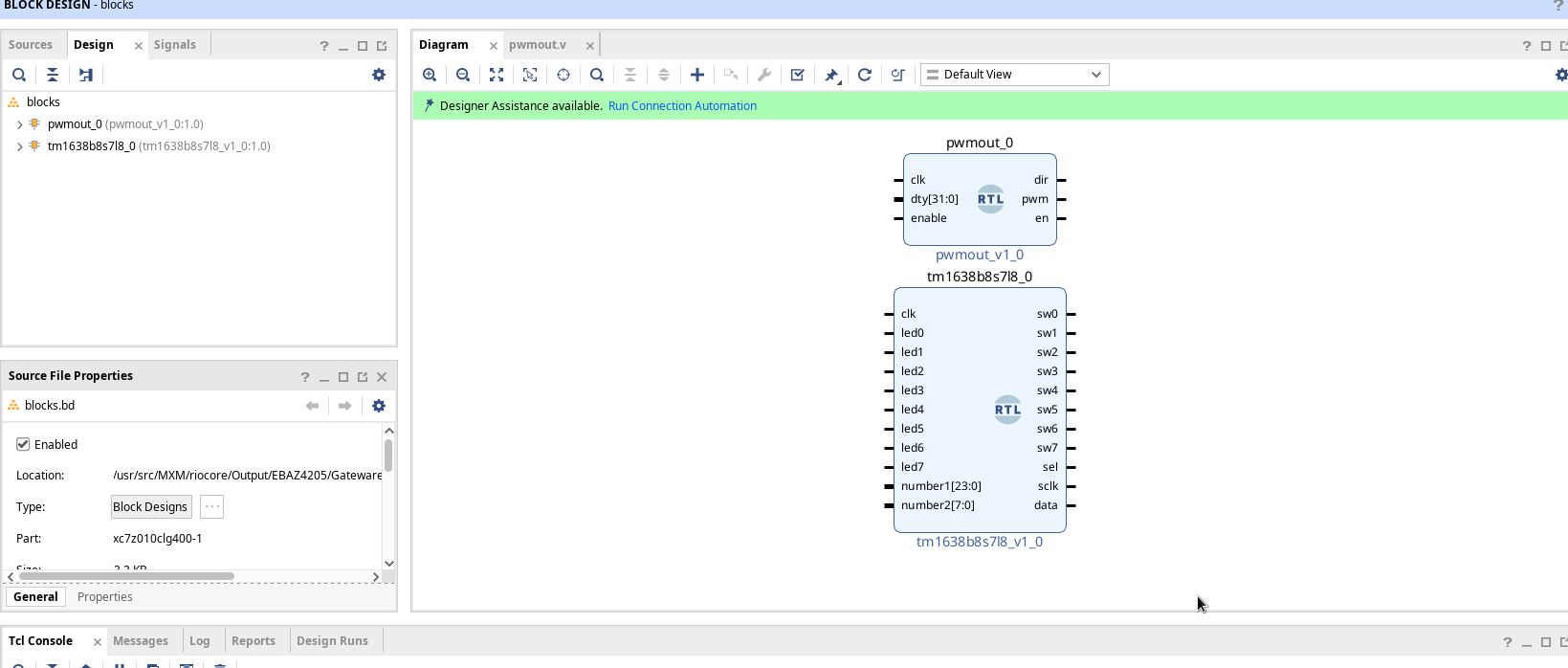

this waveshare thing working fine with vivado:
www.amazon.de/dp/B00KM70UFG?ref=ppx_yo2ov_dt_b_fed_asin_title
if you only need to load the bitfile, you can use the installed linux-system.
i know that someone in this forum has running linuxcnc on an raspberry-zero 2 with sdl gui,
this is not so fare away from this cores.
## I actually like vivado. wouldn't it be nice to have cnc modules (step gens, counters, pwm etc) set as ip blocks in vivado so it can be just visual drug and drop to create configuration you need. File Attachment:
hmmm, maybe we can convert some rio plugins into vivado blocks
at the moment the complete rio part is shown as one block in vivado.

11 Jul 2025 12:56 #331699
by meister
Replied by meister on topic Xilinx Zynq 7010 fpga crypto windfall boards
blocks.tcl
[/code]
[code]set projectname "rio-rtl"
set part xc7z010clg400-1
set outputdir "./$projectname"
file mkdir $outputdir
create_project -part $part $projectname $outputdir
create_bd_design "blocks"
add_files -norecurse pwmout.v
set module_pwmout [create_bd_cell -type module -reference pwmout pwmout_0]
add_files -norecurse tm1638b8s7l8.v
set module_tm1638b8s7l8 [create_bd_cell -type module -reference tm1638b8s7l8 tm1638b8s7l8_0]
regenerate_bd_layout
save_bd_design
set bdpath [file dirname [get_files [get_property FILE_NAME [current_bd_design]]]]
easier than expected :)

11 Jul 2025 13:48 #331703
by meister
but rio is much more than the bitfile generation, it creates the interfaces and linuxcnc configuration.
it would be nice to have a visual editor in rio-setup like the vivado block designer

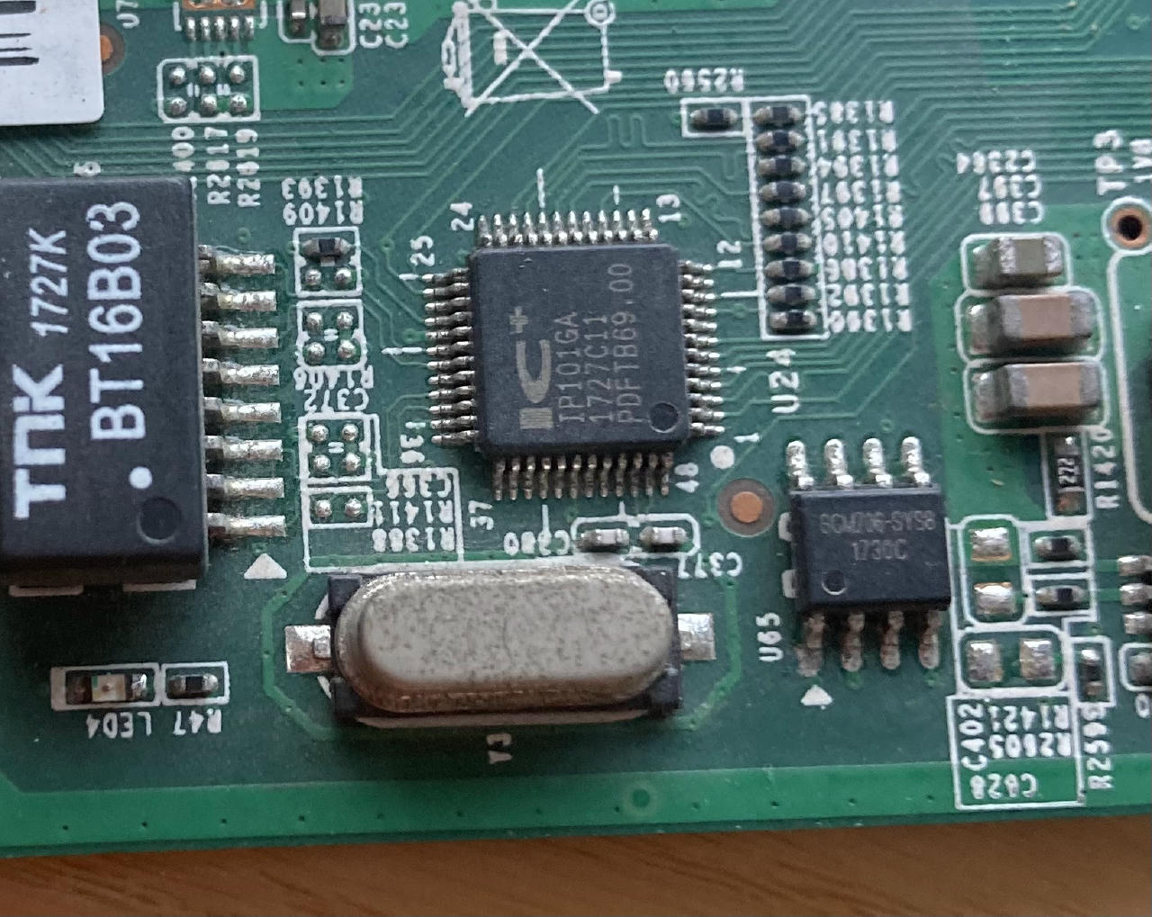

12 Jul 2025 08:53 #331722
by DMNZ
Replied by DMNZ on topic Xilinx Zynq 7010 fpga crypto windfall boards
- DMNZ
- Posts: 25
- Thank you received: 8
12 Jul 2025 08:55 #331723
by DMNZ
i can see you configured its zynq ethernet GMII module in vivado, does it work? have you tried it with lwIP examples to check if udp transport works?
