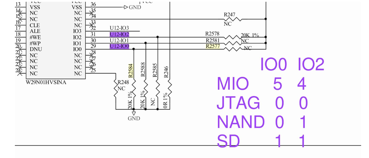

The w5500 plugin already works, you can use RIO on this board without the ARM core. Only problem is, i don't know how to write the bitfile permanently to the flash.
JTAG can only write to RAM

"Only problem is, i don't know how to write the bitfile permanently to the flash."
i have seen somewhere that to write to nand on this board you need to pull IO2 (R2578) next to flash to ground to boot in JTAG mode, flash nand, then release it up to boot from nand as default. some people install a switch there but damn, those resistors and pads are tiny.
