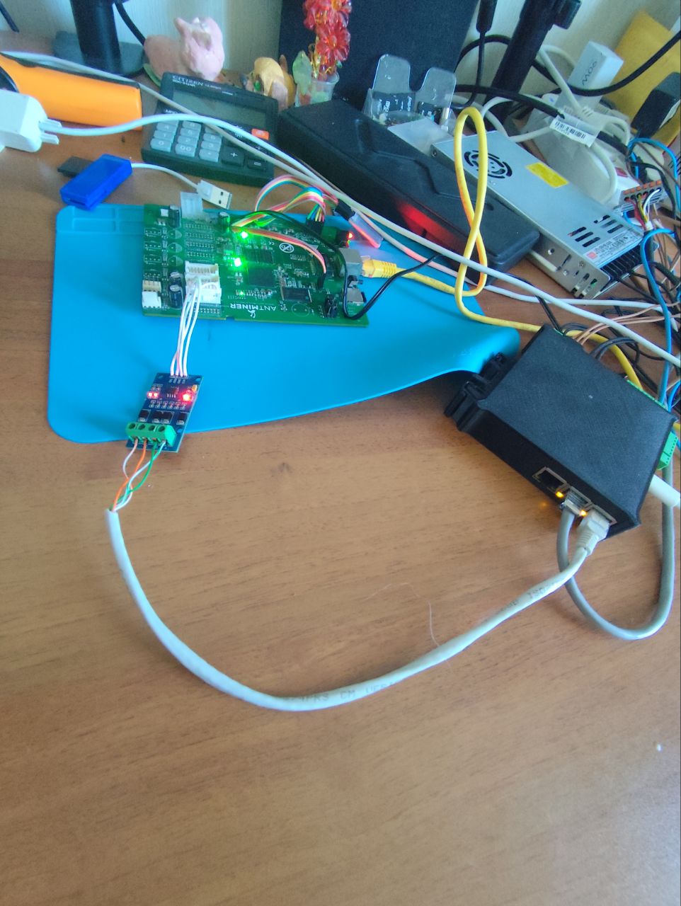

I am compiling kernel with RT patch and hostmot2 bitstream for board. Install linuxCNC in headless config, all main modules works, except smartserial, now working on it. LinuxCNC 2.9 , hostmot2 FPGA from Zboard .. If interesting can share Vivado 2025.2 project and SD card image.

BTW: In the meantime, I’d also carried on working with the board and had a bare-metal LwIP bridge up and running, via the built-in network / bootable via.
but need more testing

disk.yandex.ru/d/wWys1FiCtXp55w hre is vivado project and so on

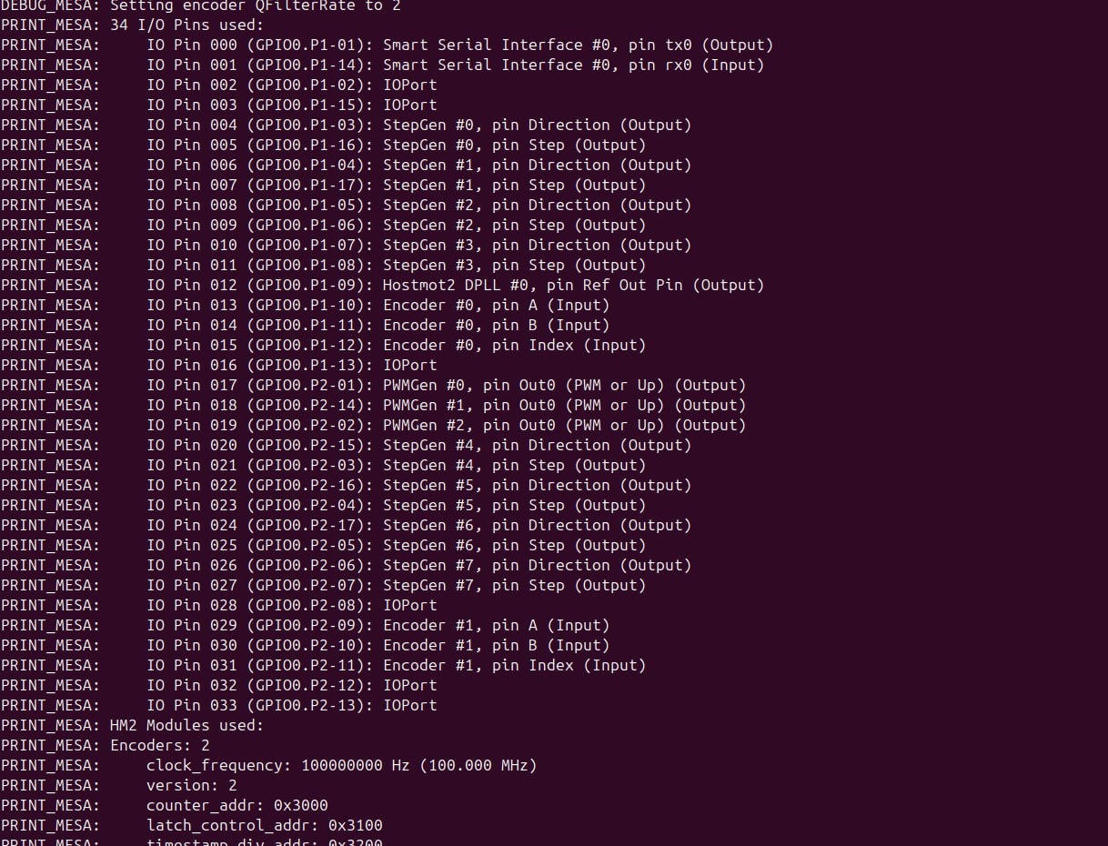

Pins for smart serial is in Pin descriptor from IDROM of ZYNQ hostmot2 FPGA, but in usag it show as just IOPort, why it is can happens? I doing some mistake , or it is some logic of work when nothink findout on smart serial?
ubuntu@arm:~$ ./start_linuxcnc.sh
This script only needs to be run once per shell session.

hm2/hm2_soc_ol: Smart Serial Firmware Version 43
hm2/hm2_soc_ol: 34 I/O Pins used:

Replied by PCW on topic Xilinx Zynq 7010 fpga crypto windfall boards
If the driver does not find a Sserial remote, it reverts the pins to GPIO
so that's expected if there is no remote connected/discovered.
- murdemon
- Posts: 10
- Thank you received: 12
26 Aug 2026 07:48 - 26 Aug 2026 07:49 #349020
by murdemon
Replied by murdemon on topic Xilinx Zynq 7010 fpga crypto windfall boards
It all working now. Have to change tri-state block in vivad. Will be update on cloud project Vivado and so on

- murdemon
- Posts: 10
27 Aug 2026 09:07 #349037
by murdemon
In really already have IOs on stmbl drive , now add webui interface, all work on board
