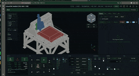

27 Aug 2026 09:45 #349043
by murdemon
Replied by murdemon on topic Xilinx Zynq 7010 fpga crypto windfall boards
here is web based interface

- murdemon
- Posts: 10
- Thank you received: 12
27 Aug 2026 15:12 #349052
by murdemon
github.com/bildobodo/lcnc-suite
This repo for web GUI, linuxCNC on isolated core arm CPU working without problem , another one for linux and web GUI on ZYNQ 7010

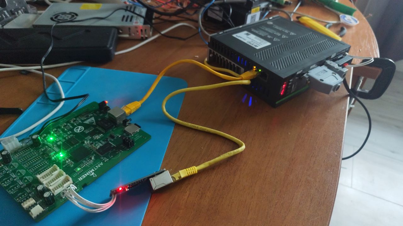

03 Sep 2026 10:02 #349274
by murdemon
Add W5500 spi Ethernet, and setting up main Ethernet port to ethercat master and connect to linuxcnc-ethercat

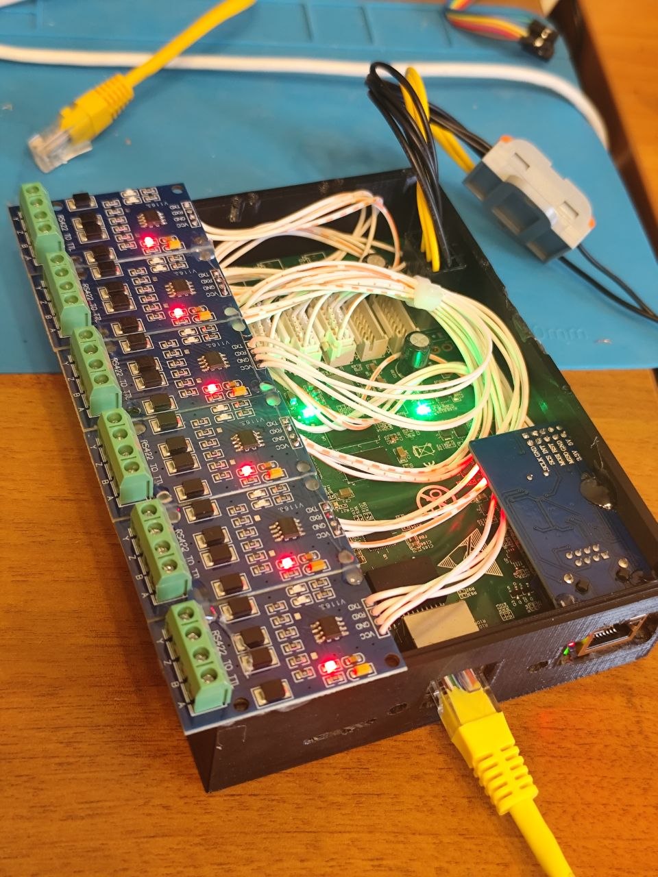

18 Sep 2026 06:53 #349702
by murdemon
6 SmartSerial interfaces with ZYNQ 7010 and SPI Ethernet , on first one ethernet port Ethercat is configured
