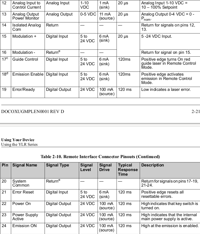

Can (which?) pins on the 7i95T be used to control an IPG laser (please see attached image of pinouts from laser specifications) or is another card needed?
