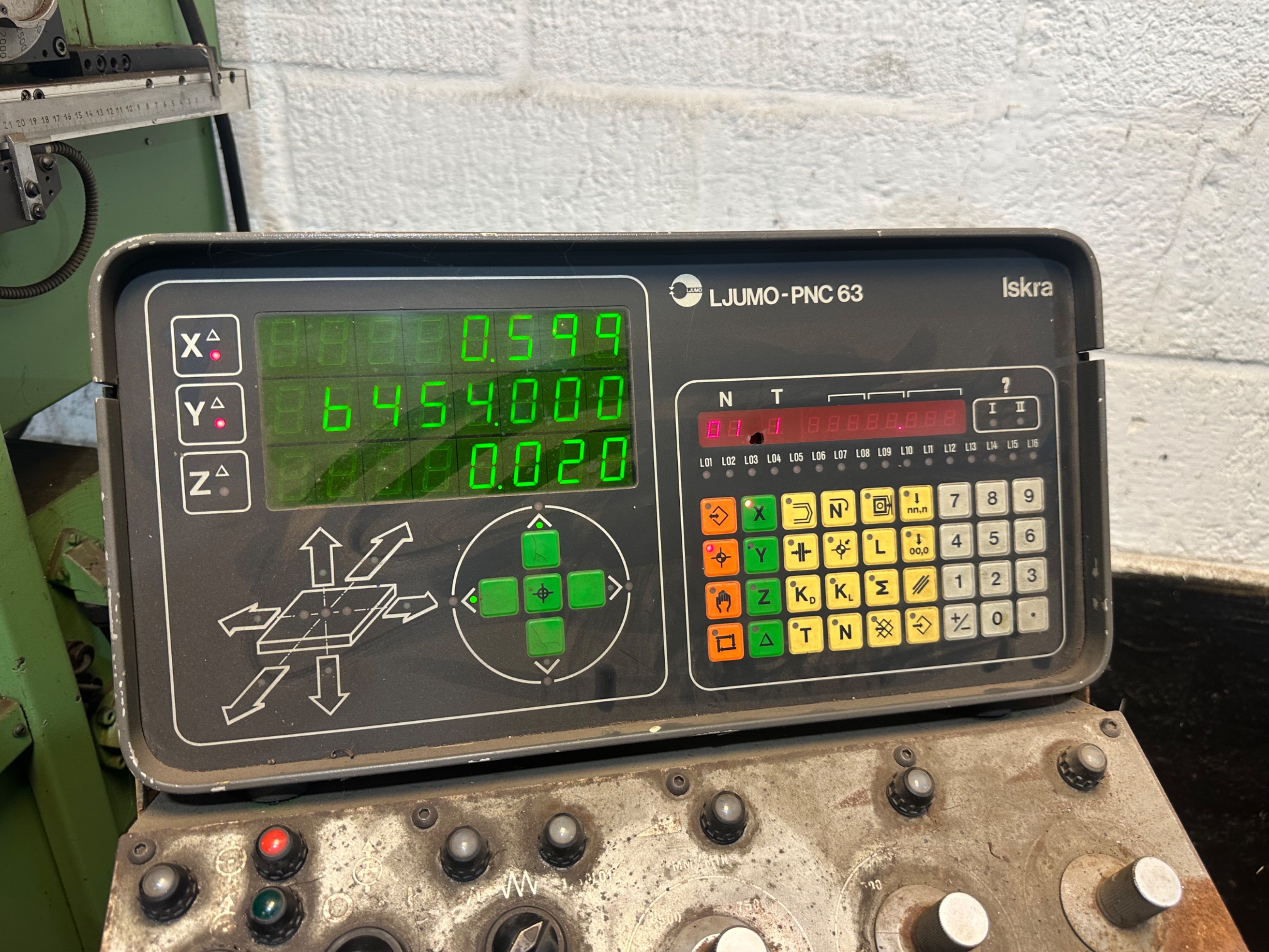

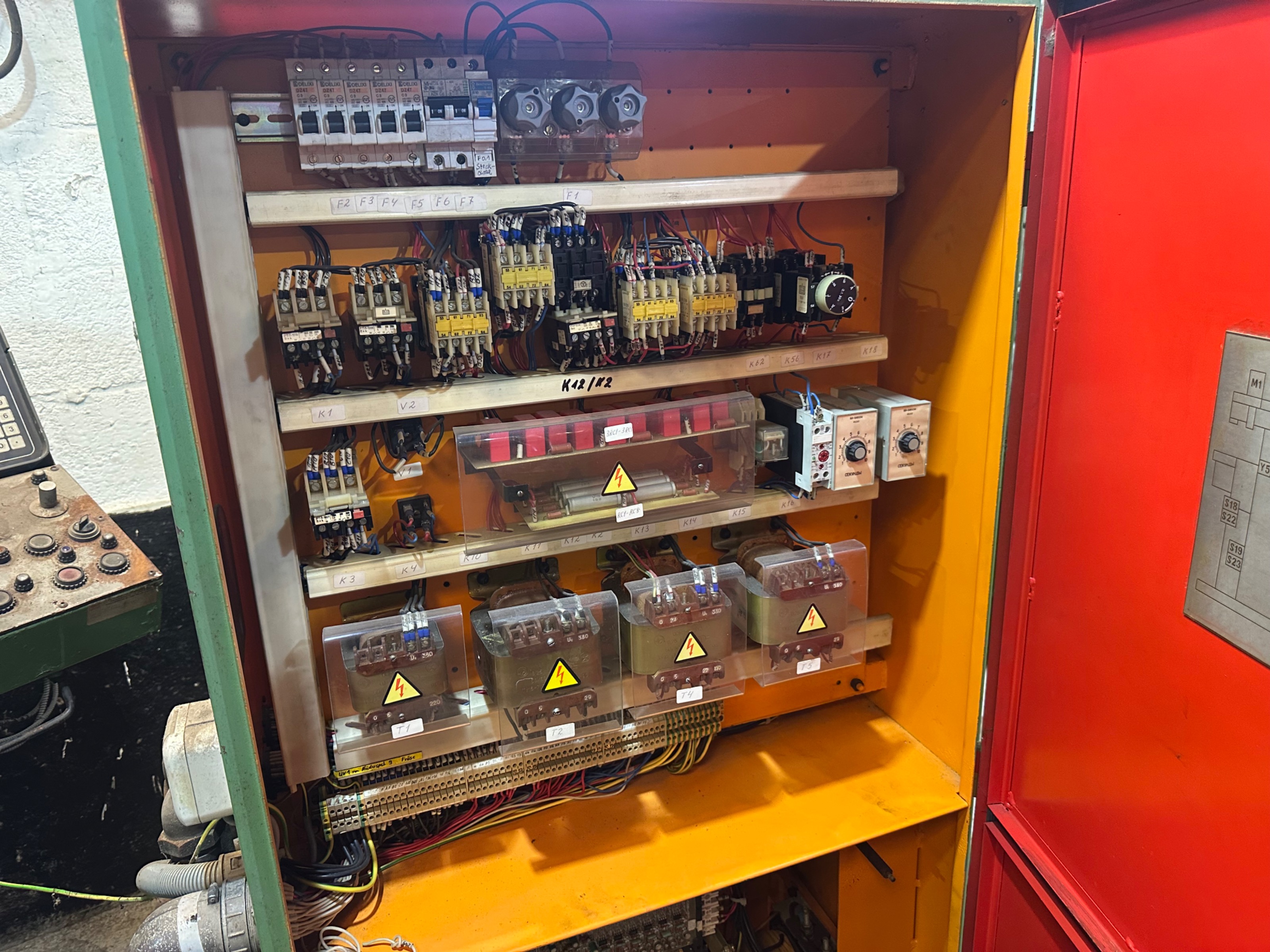

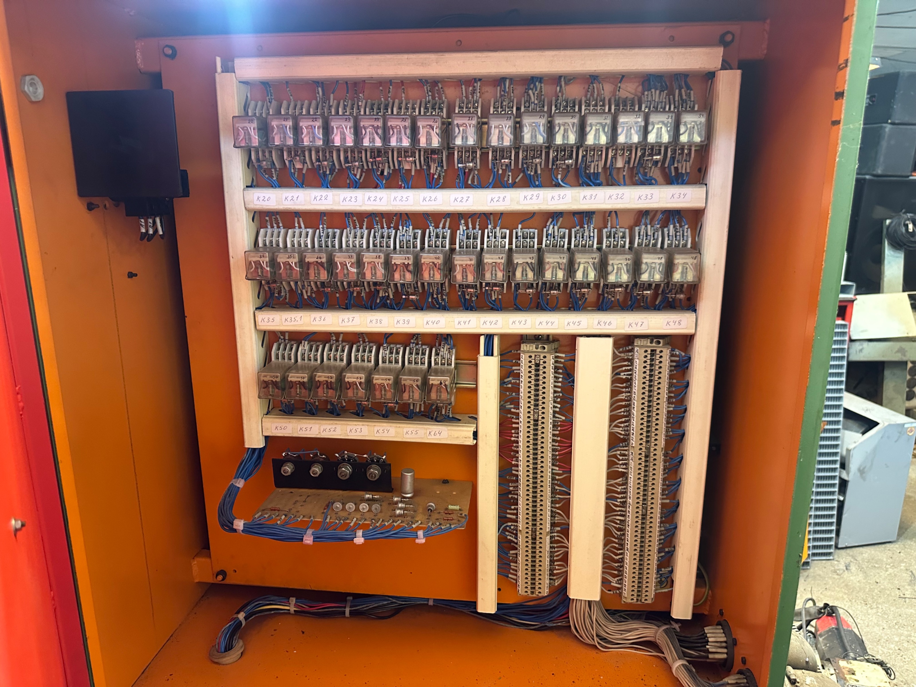

hey all!im in the market for a decent mill that i want to retrofit with Mesa/linuxCnC. its a Knüth WF 5 NC, a hydrolic controlled mill with currently a Ljumo-PNC 63 controller. currently the mill isnt operational, but even with the full schematics we cant seem to figure out the current issue.i have done a retrofit before using mesa on a Vermano r170 which used some big servos, but i cant seem to find much info regarding retrofitting mesa hardware on a hydrolic controlled mill.is this even possible, and where can i find some more info on how to tackle this?best regards,steers

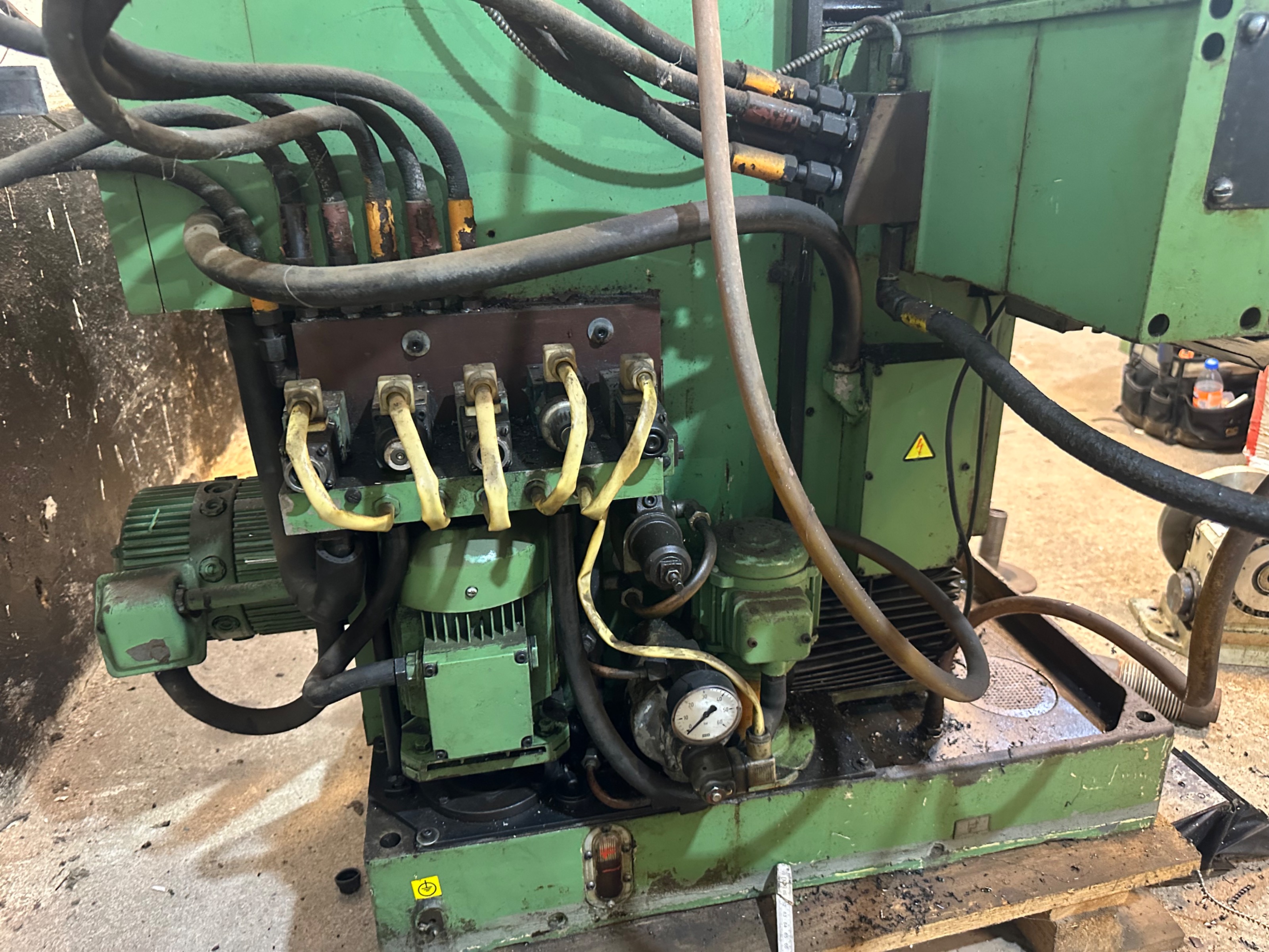

If you are retaining the hydraulics, the question would be how are the hydraulic valves
that control position controlled and what is the position feedback method.

Are the axes moved by hydraulic motors or cylinders? Or, are there electric motors for the axes? Is it really an NC mill, or is that Ljumo just a digital readout?
Driving a machine with proportional hydraulic valves requires "dither" to be added to keep the valve freely floating.

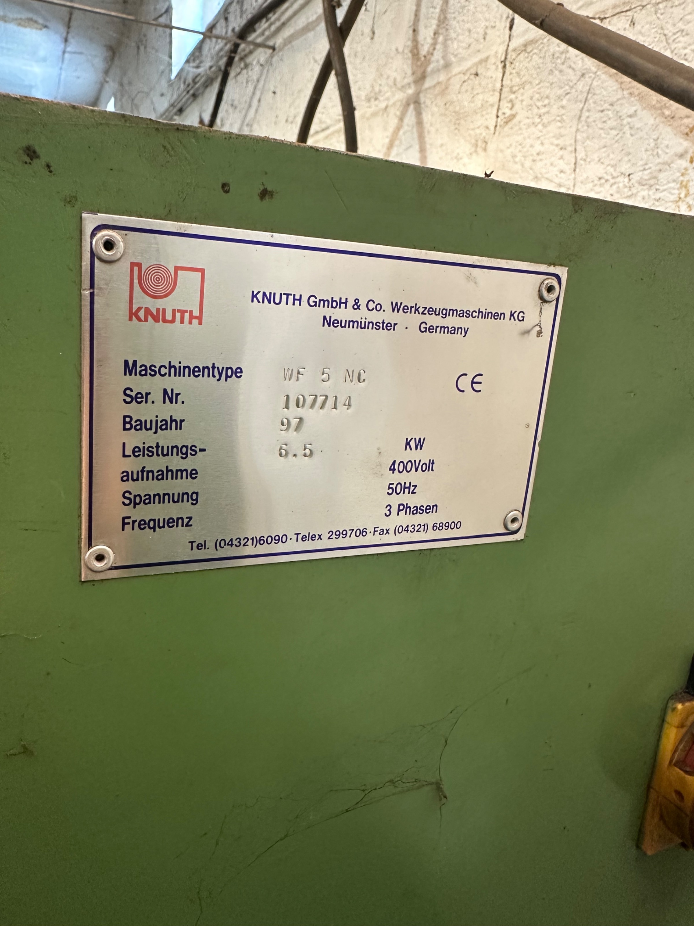

The attached picture of the original post clearly says WF5 NC on the machine tag.
It says "punkt-strecken-gesteuert", I guess that means it can move one axis from a given position to another given position at a time?

Servo Zentralantrieb in allen drei richtungen
means
central (single) servo drive for all 3 directions
So not hydraulic, but the tool lock is hydraulic, both for horizontal and vertical head.
In short, retrofitting to full CNC would require removing the central drive and gearbox and adding motors to each axis on the hand crank, most probably.
Also, normally, this type of machine uses trapezoidal screws and brass nuts, so have a lot of backlash, that can be fixed in software to a certain degree, but do not expect much precision.
