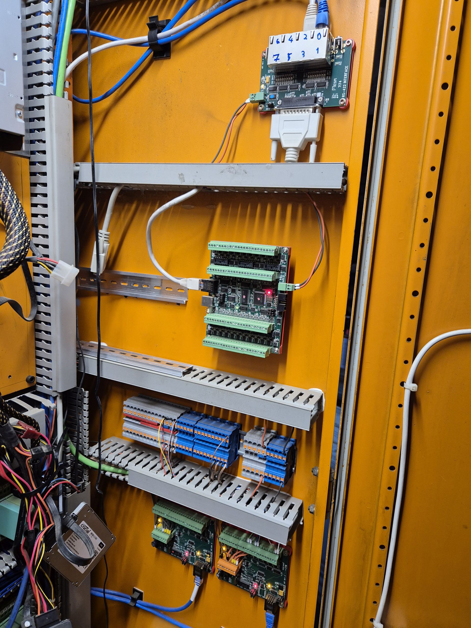

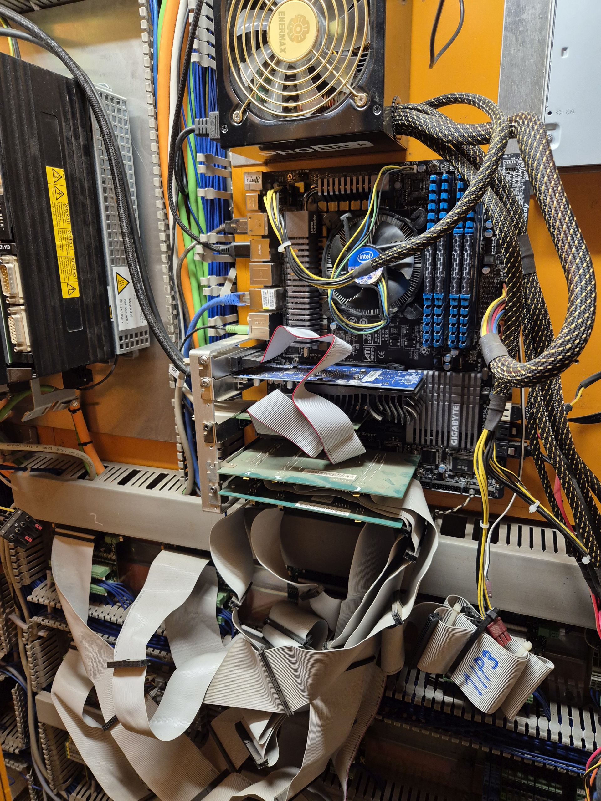

I would need a Bitfile for the 6i25, the 7i74 is on P3 and the 7i85 is on P2, if that possiple ?

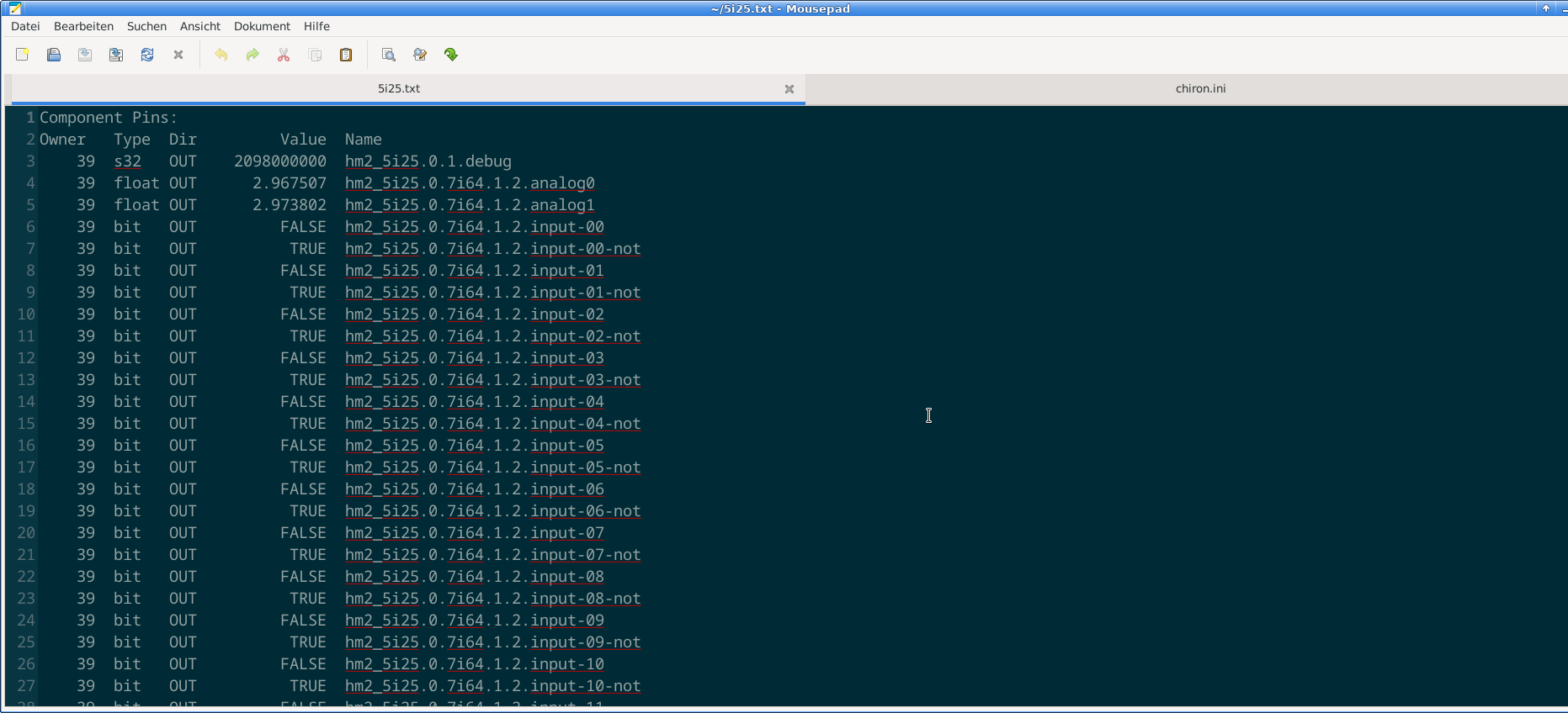

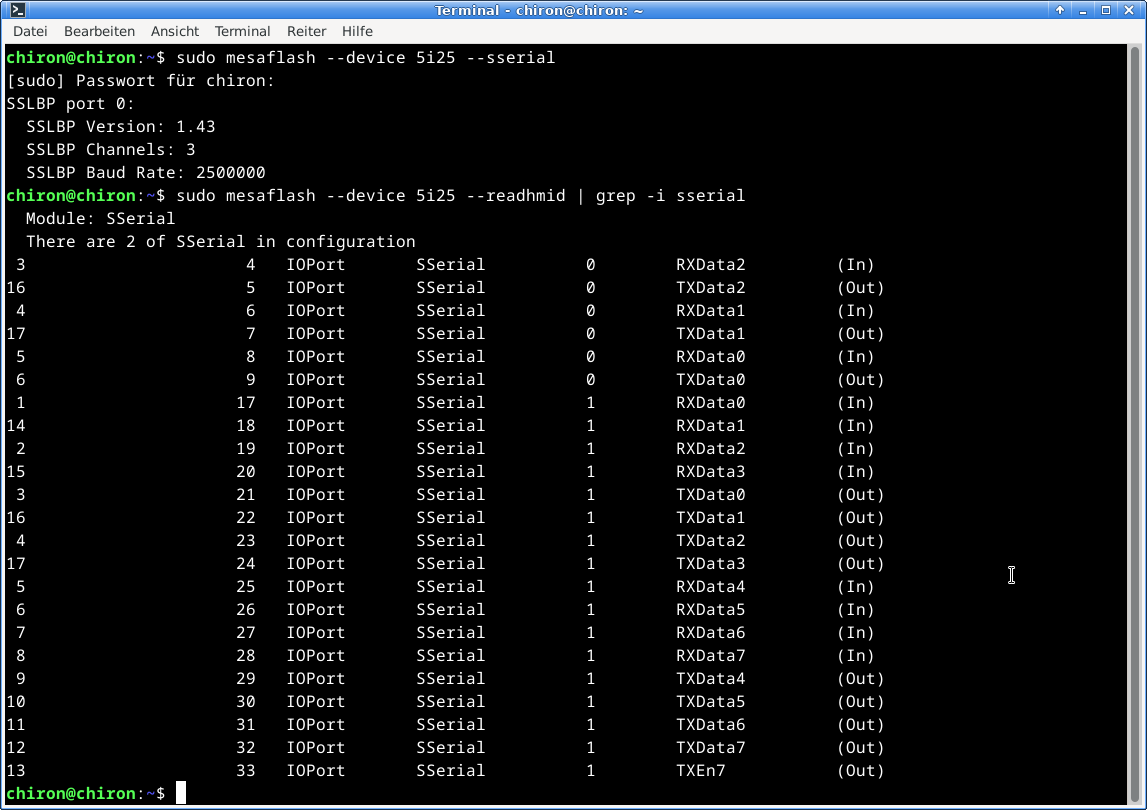

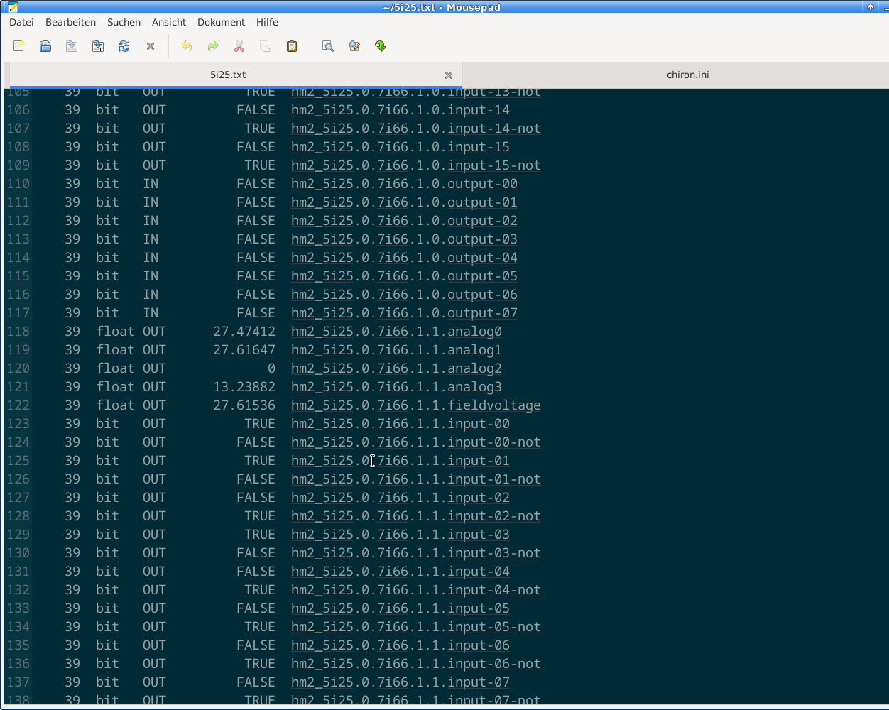

The next question is how do I get this activated, I still have two 7i66 and a 7i64 connected to the 7i74, which I can no longer see
The old config :

  Module: SSerial
  There are 2 of SSerial in configuration
  Version: 0
  Registers: 6
  BaseAddress: 5B00
  ClockFrequency: 33.333 MHz
  Register Stride: 256 bytes
  Instance Stride: 64 bytes
  Module: LED
  There are 1 of LED in configuration
  Version: 0
  Registers: 1
  BaseAddress: 0200
  Instance Stride: 4 bytes
Configuration pin-out:
IO Connections for P3
DB25 pin#             I/O   Pri. func    Sec. func        Chan     Sec. Pin func   Sec. Pin Dir
 1                      0   IOPort       None
14                      1   IOPort       None
 2                      2   IOPort       None
15                      3   IOPort       None
 3                      4   IOPort       SSerial          0        RXData2         (In)
16                      5   IOPort       SSerial          0        TXData2         (Out)
 4                      6   IOPort       SSerial          0        RXData1         (In)
17                      7   IOPort       SSerial          0        TXData1         (Out)
 5                      8   IOPort       SSerial          0        RXData0         (In)
 6                      9   IOPort       SSerial          0        TXData0         (Out)
 7                     10   IOPort       MuxedQCountSel   0        MuxSel0         (Out)
 8                     11   IOPort       MuxedQCount      0        MuxQ-A          (In)
 9                     12   IOPort       MuxedQCount      0        MuxQ-B          (In)
10                     13   IOPort       MuxedQCount      0        MuxQ-IDX        (In)
11                     14   IOPort       MuxedQCount      1        MuxQ-A          (In)
12                     15   IOPort       MuxedQCount      1        MuxQ-B          (In)
13                     16   IOPort       MuxedQCount      1        MuxQ-IDX        (In)
IO Connections for P2
 1                     17   IOPort       SSerial          1        RXData0         (In)
14                     18   IOPort       SSerial          1        RXData1         (In)
 2                     19   IOPort       SSerial          1        RXData2         (In)
15                     20   IOPort       SSerial          1        RXData3         (In)
 3                     21   IOPort       SSerial          1        TXData0         (Out)
16                     22   IOPort       SSerial          1        TXData1         (Out)
 4                     23   IOPort       SSerial          1        TXData2         (Out)
17                     24   IOPort       SSerial          1        TXData3         (Out)
 5                     25   IOPort       SSerial          1        RXData4         (In)
 6                     26   IOPort       SSerial          1        RXData5         (In)
 7                     27   IOPort       SSerial          1        RXData6         (In)
 8                     28   IOPort       SSerial          1        RXData7         (In)
 9                     29   IOPort       SSerial          1        TXData4         (Out)
10                     30   IOPort       SSerial          1        TXData5         (Out)
11                     31   IOPort       SSerial          1        TXData6         (Out)
12                     32   IOPort       SSerial          1        TXData7         (Out)
13                     33   IOPort       SSerial          1        TXEn7           (Out)

10 Aug 2025 13:29 #333158 by PCW
Replied by PCW on topic Bitfile for 6i25+7i74+7i85
What was the previous configuration?
That is, what changed?
  • ChironFZ16
  • ChironFZ16's Avatar Topic Author
  • Offline
  • Senior Member
  • Senior Member
10 Aug 2025 23:38 #333188 by ChironFZ16
Replied by ChironFZ16 on topic Bitfile for 6i25+7i74+7i85
That was 5i25_7i74x2.bit, sserial_port_1=021xxx
10 Aug 2025 23:44 #333190 by PCW
Odd, do the 7I85 encoders work?
Maybe there's some meta-problem of some kind.
