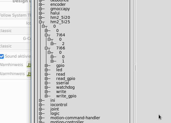

No, the 6i25 was operated with only one 7i74; the second slot remained empty. The new 7i85 will not arrive until Wednesday.

I tested the bitfile and it works for me on LinuxCNC 2.9.4 (all sserial ports on the 7I74 work)
(the 7I74 is on 6I25 P2 = HDR26)
Since it looks like you have and older installation, you may have been bitten by this bug:
github.com/LinuxCNC/linuxcnc/commit/24b9...d5ef156b4282f6191158
If so, you could update to something newer, or I could make firmware with no sserial on the 7I85
and on the 7I74 change the port to 0

Thanks for your efforts, my card 7i85 will arrive tomorrow and I will then try everything out at my leisure.During an update, I encountered another problem with special comp files that no longer work with the new software.
