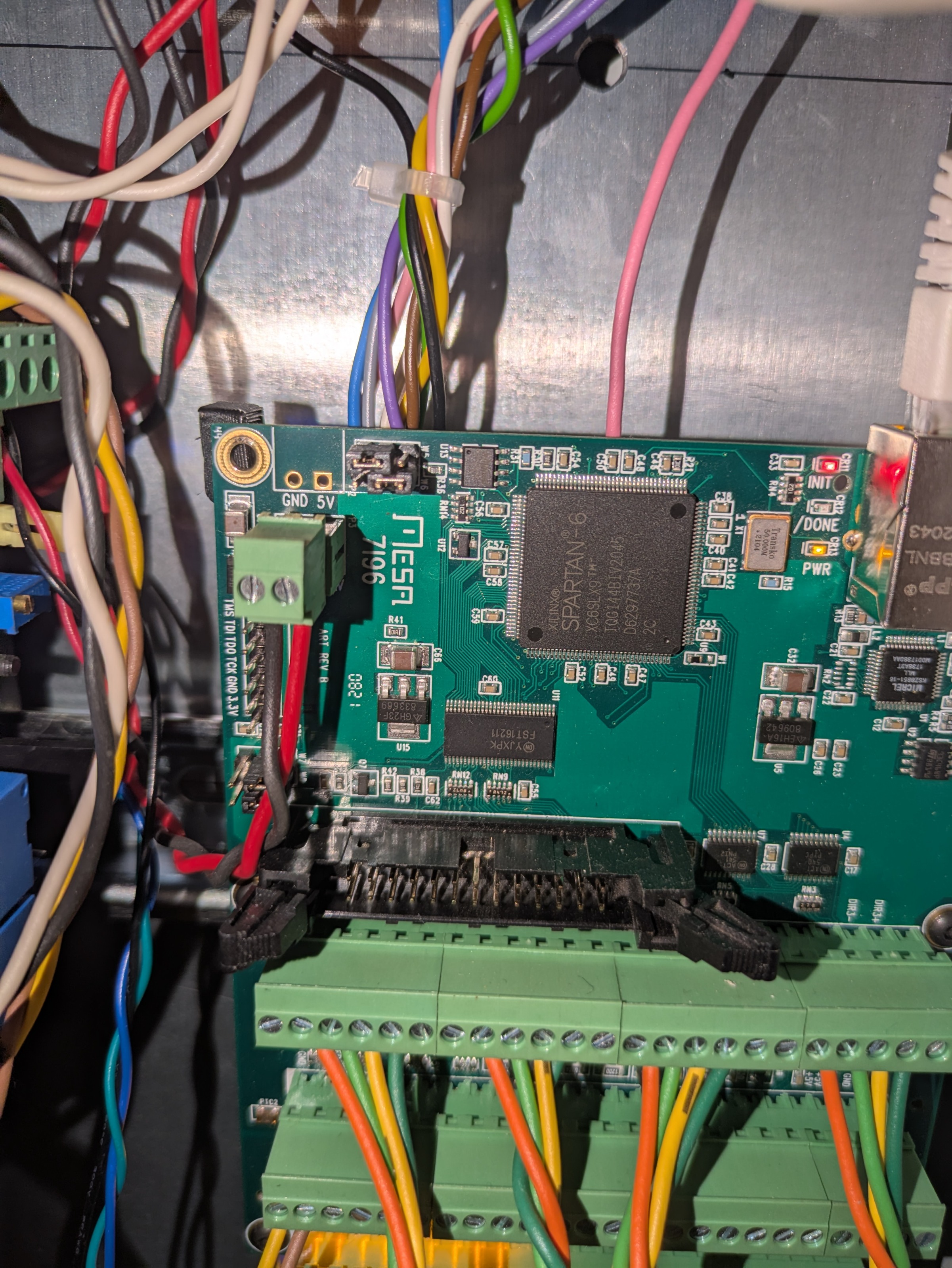

w5 and W6 are set as such :
ip a reports :
ip a
1: lo: <LOOPBACK,UP,LOWER_UP> mtu 65536 qdisc noqueue state UNKNOWN group default qlen 1000
link/loopback 00:00:00:00:00:00 brd 00:00:00:00:00:00
inet 127.0.0.1/8 scope host lo
valid_lft forever preferred_lft forever
inet6 ::1/128 scope host
2: eno1: <BROADCAST,MULTICAST,UP,LOWER_UP> mtu 1500 qdisc pfifo_fast state UP group default qlen 1000
link/ether 00:23:24:b5:80:2a brd ff:ff:ff:ff:ff:ff
inet 10.10.10.8/24 brd 10.10.10.255 scope global noprefixroute eno1
3: wlp1s0: <NO-CARRIER,BROADCAST,MULTICAST,UP> mtu 1500 qdisc mq state DOWN group default qlen 1000
link/ether 22:6b:6c:9f:f3:51 brd ff:ff:ff:ff:ff:ff

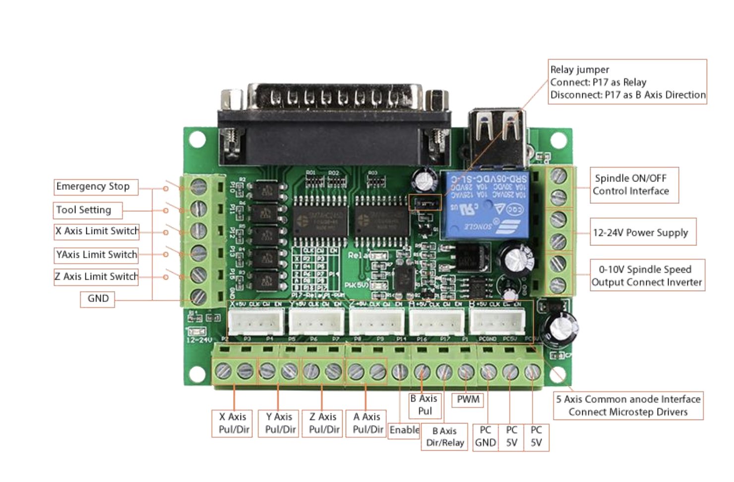

thank you for the help, I did a fresh install using the latest image and got mesaflash to work, the proper firmware is now on the board.
I have a few more questions before I fry my card
when connecting the bob o the 7i96 in what position should W8 be?
what is the correct adress for the P1/PWM pin on the bob?

30 Aug 2025 14:08 #334147
Replied by PCW on topic extra axis on 7i96 with bob
W8 must be down
To see the 5ABOB specific pinout:
mesaflash --device 7i96 --addr 10.10.10.10 --dbname3 5abob --readhmid
