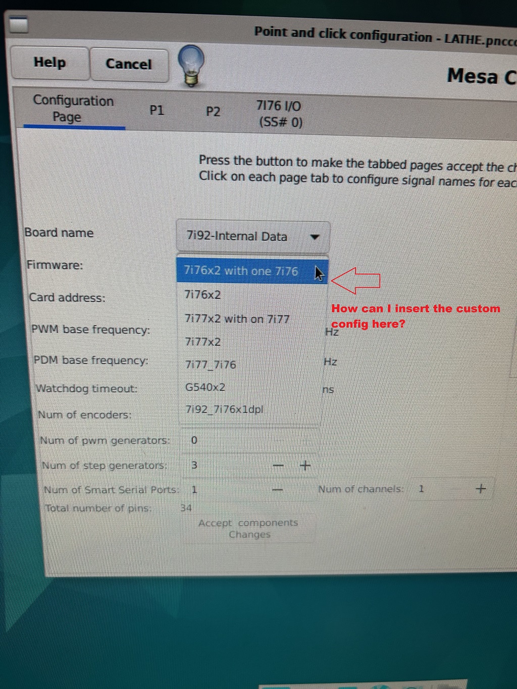

- TJ
- Posts: 13
30 Oct 2025 19:12 #337510
by TJ
Replied by TJ on topic MESA 7I92 programming
Hi
I installed the received **.bit file on the card from the command line.
When I read it back from the card, everything is fine.
How can I insert the custom config into Pncconf?
- Posts: 18100
- Thank you received: 5326
30 Oct 2025 19:34 #337514
Replied by PCW on topic MESA 7I92 programming
The easiest way is to use pncconfs "Discovery" option
You need to select "Show Advanced Option Pages"
on the first pncconf page for the discovery option
to be available.
to be available.
The following user(s) said Thank You: TJ

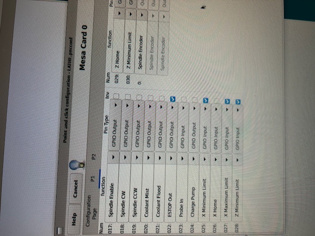

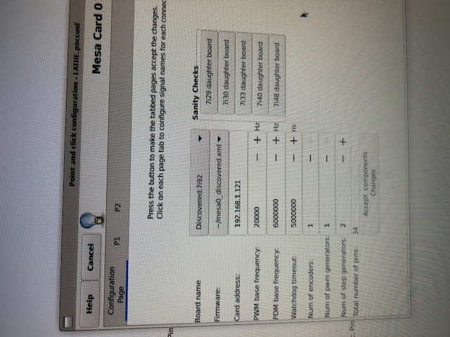

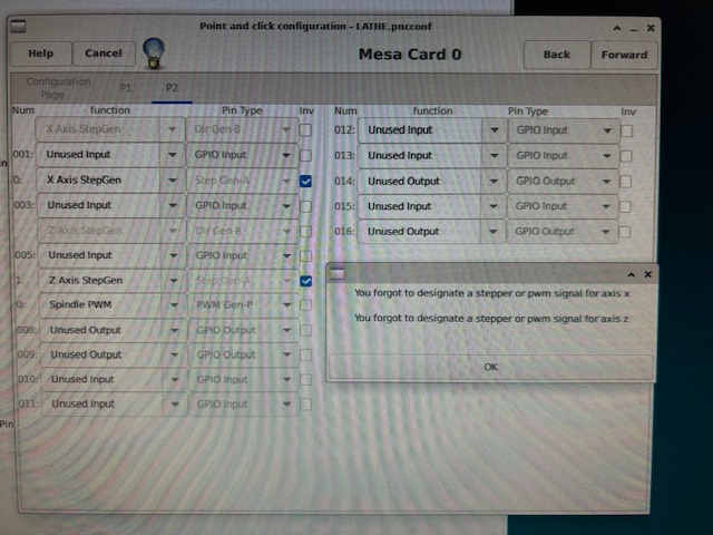

- Posts: 13
30 Oct 2025 22:18 #337545
by TJ
Pncconf found the card, read the settings and they are displayed.
I chose a lathe X-Z axis for the test.
I configured the X-Z spindle PWM and the Charge pump encoder end positions etc...
It doesn't let me proceed, it says no axis or PWM is configured.
What did you do wrong?
A few pictures of the settings.
- Posts: 21959
- Thank you received: 7478
30 Oct 2025 22:44 #337547
Replied by tommylight on topic MESA 7I92 programming
You have 1 active PWM generator but no pin out for it chosen, so either set the PWM number to 0 or select a pin for spindle PWM
