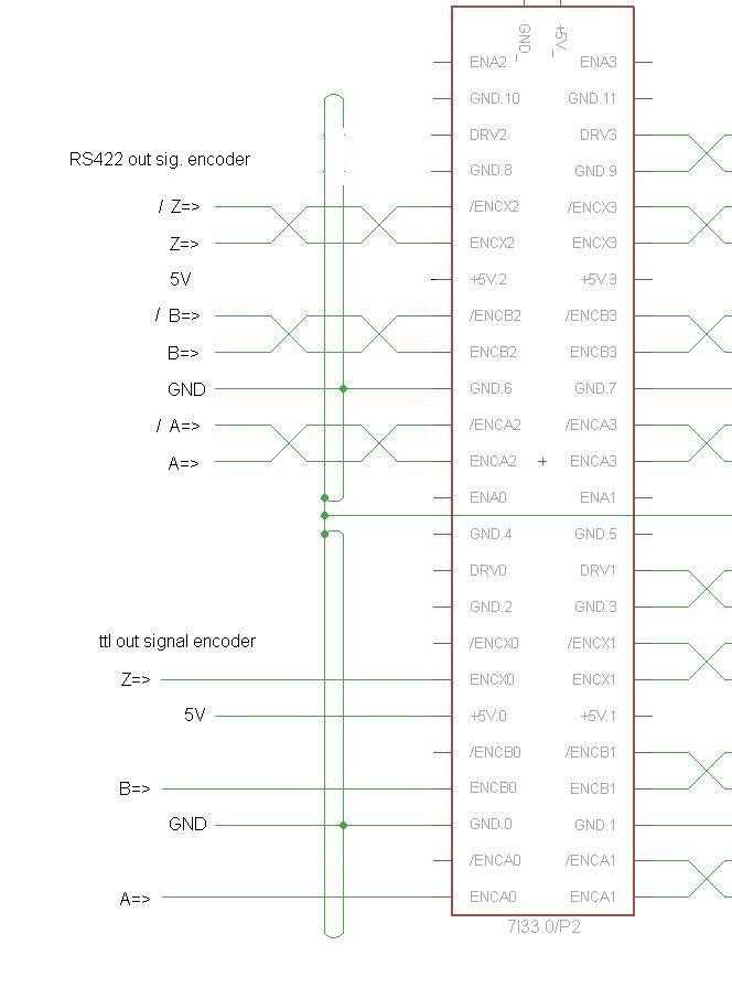

I am trying to hook up 4 encoders to a mesa 7i33, after researching I am more confused than when I started. Hopefully I can get atleast some guidance.
The encoder employs a 5 wire TTL signal:
Signal wires as follows: OV, A, +5V, B, Z
I have read many web sites and posts on forums mentioning using signal wires ENCA0, /ENCA0; ENCA1, /ENCA1; ENCA2, /ENCA2; ENCA3, /ENCA3, from the 7i33, but no idication to which wires they connect to on the encoders, with that, this only covers 2 of the 5 wires on each of the encoders.
Any help would be greatly appreciated.

Set the Wx svitch for the TTL signal input on a 7i33 board !!! Read the manual page for 7i33 board.

13 Mar 2011 11:03 #7778 by andypugh
Replied by andypugh on topic Re:Encoder wiring - Mesa 7i33
That is three signals and power. 0V is GND (or Earth). The quadrature signals are A and B and the Index (one pulse per rev) is called Z.
That is for a "differential" wiring scheme, where each phase has two wires (so A and /A, B and /B, Z and /Z) You are using TTL so need to ignore the /A /B and /Z pins. (and probably set a jumper on the board). The numbers on the signal names above refer to the encoder number.
If you look at the picture that Radek posted, you need to follow the scheme in the bottom left quarter, and ignore the rest.
19 Mar 2011 00:10 #7925 by Fordperf393W
Replied by Fordperf393W on topic Re:Encoder wiring - Mesa 7i33
Well, I got everything hooked up per the provided diagrams. I used pin 49 for +5 to the 7i33 and the encoders, is this ok or should I tap off the computers PSU?
I launched emc using the provided 5i20 sample file, but I get no readout. are there any other drivers I need?

19 Mar 2011 02:32 #7931 by PCW
Replied by PCW on topic Re:Encoder wiring - Mesa 7i33
Using the cable power is ok up to around 400 mA (about 75 mA per encoder plus 100 mA for the 7I33 card)
if the encoder draw more power you may want to supply 5V to the 7I33. The easiest way with a 5I20 is to take 5V power from the terminal block on the 5I20, this can supply up to 2.5 A or so and is protected by a PTC so you wont fry any wiring or PCI sockets if you short out the 5V.
If you do not get any encoder counts, I would check that:
1. The 7I33 has power (three LEDs on)
2. With the original HM2-servo config, you have the 7I33 connected to P2 (I/0 0..23)
3. That you have your encoders properly connected ( the voltage measured on the A or B lines should change alternately from high (3-5V) to low (close to 0V) if you move the motor shaft
4. You have the 7I33 jumpered for TTL mode

23 Mar 2011 02:05 #8016 by Fordperf393W
Well, I would just like to thank everyone that helped me out. Finally ended up taking apart the DB9 connector supplied on the encoder wiring to find out the mfg swapped the GND and 0V from what their pinout showed. Works like a champ.
