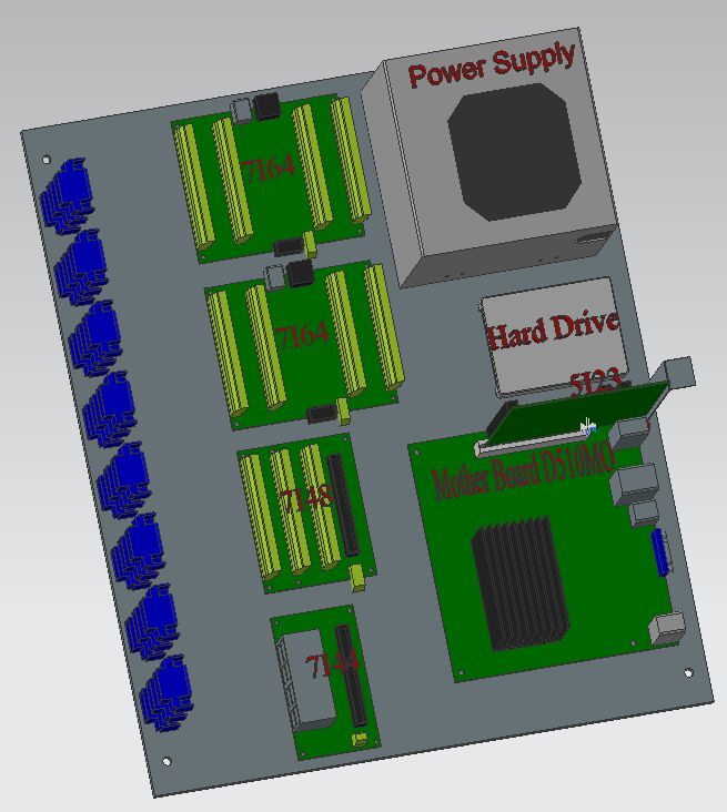

For anyone that wants it, here is a cad file in parasolid format of the cards and chassis.
I didn't end up using the chassis exactly as drawn here because the boards were too close together to connect the RJ45. But the boards are useful for you to mock-up your own design layout.
Enjoy.
www.schmidtmotorworks.com/mesa_assembly.zip
