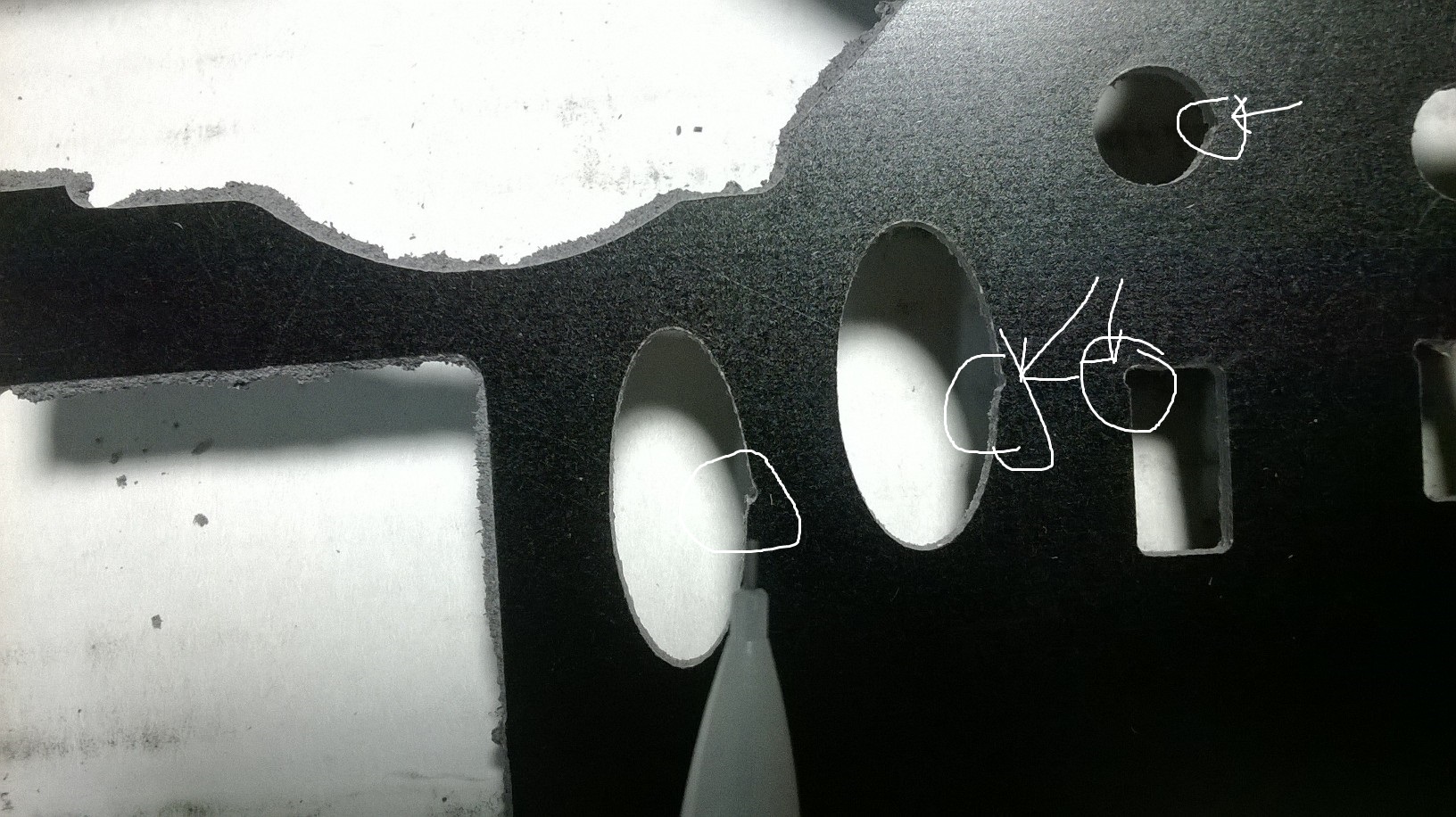

Rick,
Help Please. Having problem especially with circles. See attached photo. Thanks
23 Mar 2014 22:07 #45165 by ArcEye
Replied by ArcEye on topic Re:G540 + EMC2 = missing steps
Are you using cutter offsets and removing before retraction, would look similar :laugh:

26 Mar 2014 03:45 #45266 by Fredasiong
Replied by Fredasiong on topic Re:G540 + EMC2 = missing steps
Arceye,
No.
My parameters;
1/16 end mill
cut2d prog.
K2cnc machine
This are cuts of circle and eclipse with no tabs. The bigger the diameter the more emphasis on the notch and is happening at the start of the cut. I have played with the velocity and accel no luck.
26 Mar 2014 09:35 #45269 by ArcEye
Hi
Can you attach some code (complete) that is doing this.
I presume the code is generated, seems unlikely that losing steps is going to cause the cutter to go outside the radius of a circle, especially at the start of the run.
This does look just like what would happen if you only applied cutter compensation after plunging or took it off before retraction.
The point is the same for all the circles and ellipses and so far as I can see from a slightly tilted workpiece, equates to a runout of approx half the cutter width.
regards
