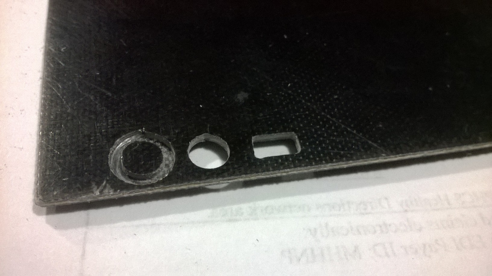

I have seen two cases of step loss when using simultaneous motion over multiple axes:
- Case 1: the problem was the switch mode power supply. Although it was a hefty 48V/10Amp supply, it was not capable of running 3 motors at the same time. Switch mode power supplies are not good motor supplies unless grossly overdimensioned; they have problems coping with regenerative energy. Solution: I had the guy add a second power supply and power one of the axes from that one.
- Case 2: The problem was some deformation in the machine frame. When the X axis was moving the Y axis was binding and vice versa. Alignment and stiffening solved the problems.
Not sure if this is the problem here, but checking it doesn't hurt.

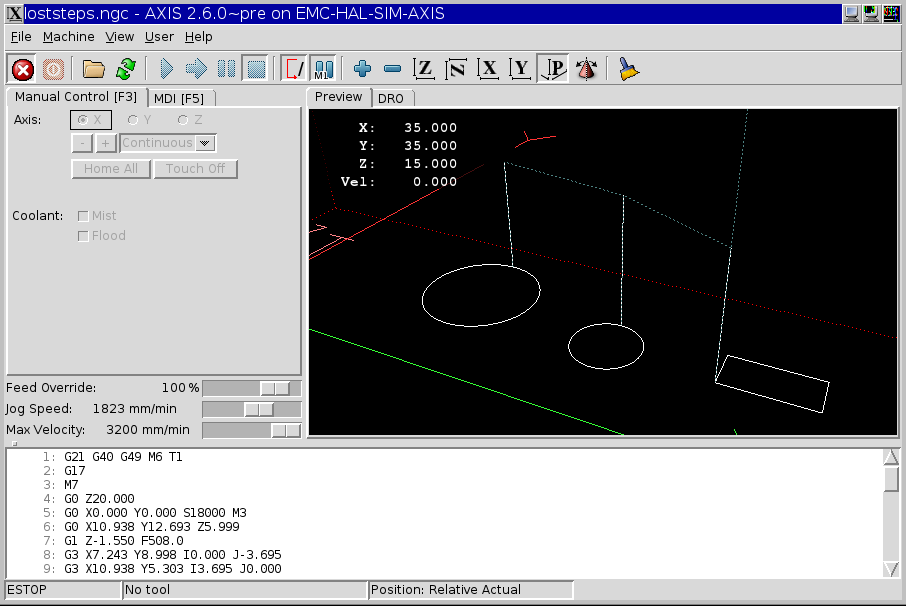

Sorry, I forgot to mention the controller is by Xylotex. See attached emc2 code.

Hi
The code is typical generated, no spacing, unnecessary repeats etc but no use of cutter compensation, so that is out.
The points by DaBit are good ones, his first point was my next gambit.
The overcuts correspond exactly with the entry plunges at the start of the cut (and the retraction). The entry is preceeded by a 3 axis move to co-ordinates and the exit is a XY moving into Z
I have amended the code as per below.
I have introduced G61 to force exact path mode, broken the 3 axis moves with included spindle startup into a S18000 M3, then XY followed by a Z,
reduced the seemingly suicidal F508 feed for the Z plunge to F100 (this is used thereafter for cutting for now)
and spaced the code so you can read it!
Give it a try and see if it cuts properly.
If so you can add things back until it errors and you will get a good idea what is causing problems.
regards
regards

27 Mar 2014 02:20 #45296
Tangential arc lead-in moves would be nicer.
Replied by andypugh on topic Re:G540 + EMC2 = missing steps
How does the hole size compare to what is being requested? I could imagine what you see being due to machine flex. (especially if the Z rocks during a plunge)Sorry, I forgot to mention the controller is by Xylotex. See attached emc2 code.

by Fredasiong
Replied by Fredasiong on topic Re:G540 + EMC2 = missing steps
Arceye,
Thank you very much. Perfect outcome on circles and square. Now that you have solved the problem, how do I do this if I have 3000 lines of code ?
Regards
Regards

27 Mar 2014 22:20 #45323
by ArcEye
Replied by ArcEye on topic Re:G540 + EMC2 = missing steps
Hi
The gcode takes the strain off the PSU by only having a max of two axes at once operating.
The answer is not to change your gcode but to beef up your power supply.
As an experiment I ran my big mill with a 24v 350W PSU covering all 3 axes, the results were diabolical, could hardly move without losing steps.
My normal setup is a 76v 14A PSU for X and Y and 56v toroidal 8A PSU for Z
Difference, next to impossible to lose steps with the latter
regards
regards

- Posts: 19908
- Thank you received: 4656
28 Mar 2014 01:05 #45325
If you are running at 24V then 125W is only 1.7A per motor. If you are running at a higher voltage than that, then you have even less current.
350W is enough for your motors if you are running at less than 40V.
would it be okay if I change my power supply to 350 watt from 125. ( I am using xylotex (3) 269 oz stepper @ 2.8amp each.
