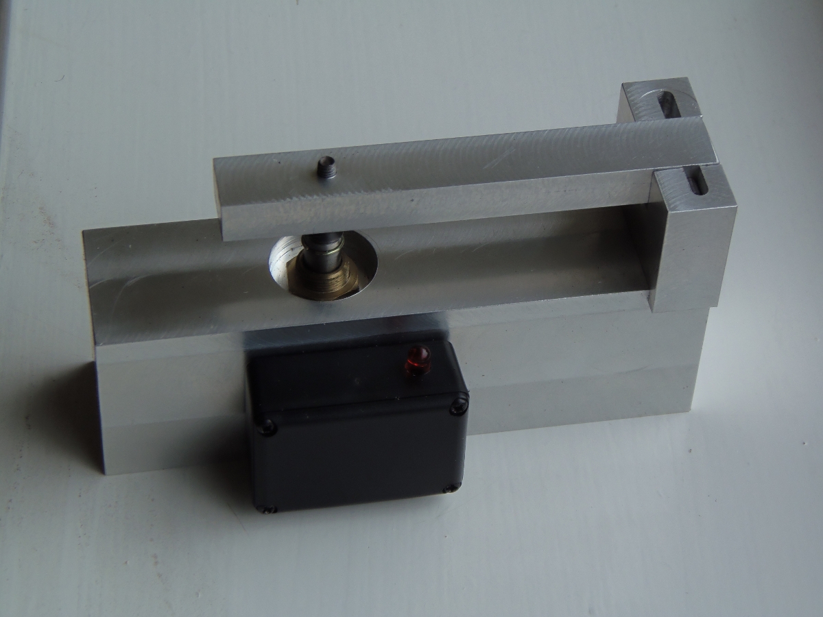

Hi
I made a couple of Z touch off tools last year.
The first is mechanical, an adjustable arm actuating a very sensitive limit switch.
The arm is adjusted so that it is dead level at point of actuation, so that where precisely the tool touches is not important.
The second is electrical, two pieces of aluminium separated by a plastic and epoxy sandwich are connected by the tool touch.
I have found these repeatable to within a couple of hundredths of a millimetre (0.01mm) which is better or at least comparable to your requirements.
Cost me time and bits from scrap bin.
Could easily be changed to trigger signal to LinuxCNC rather than just optical LED
regards

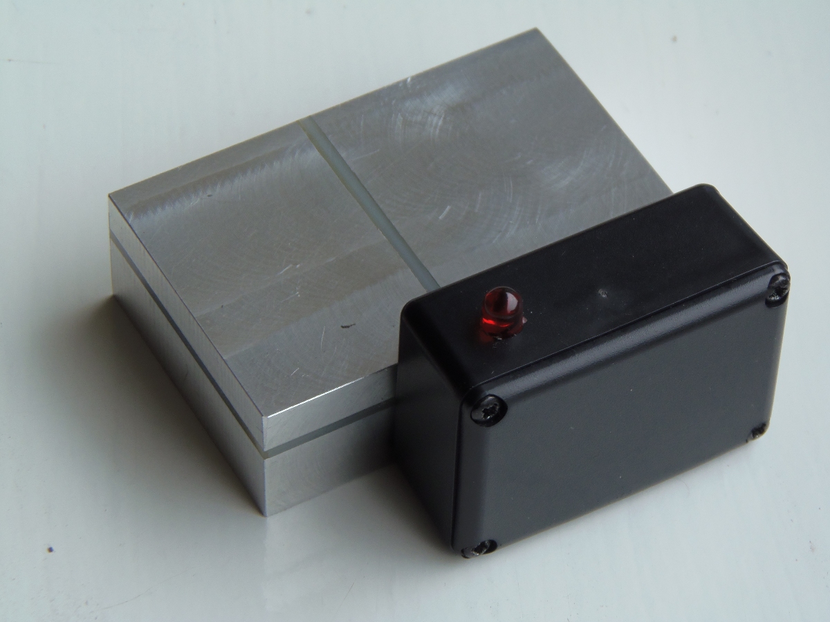

18 May 2012 09:01 - 18 May 2012 09:03 #20197 by ArcEye
Replied by ArcEye on topic Re:Mechanical Touch Off Tool Recommendation
Never did manage to get 2 pics in one post
This is the electrical one
Last edit: 18 May 2012 09:03 by ArcEye.
