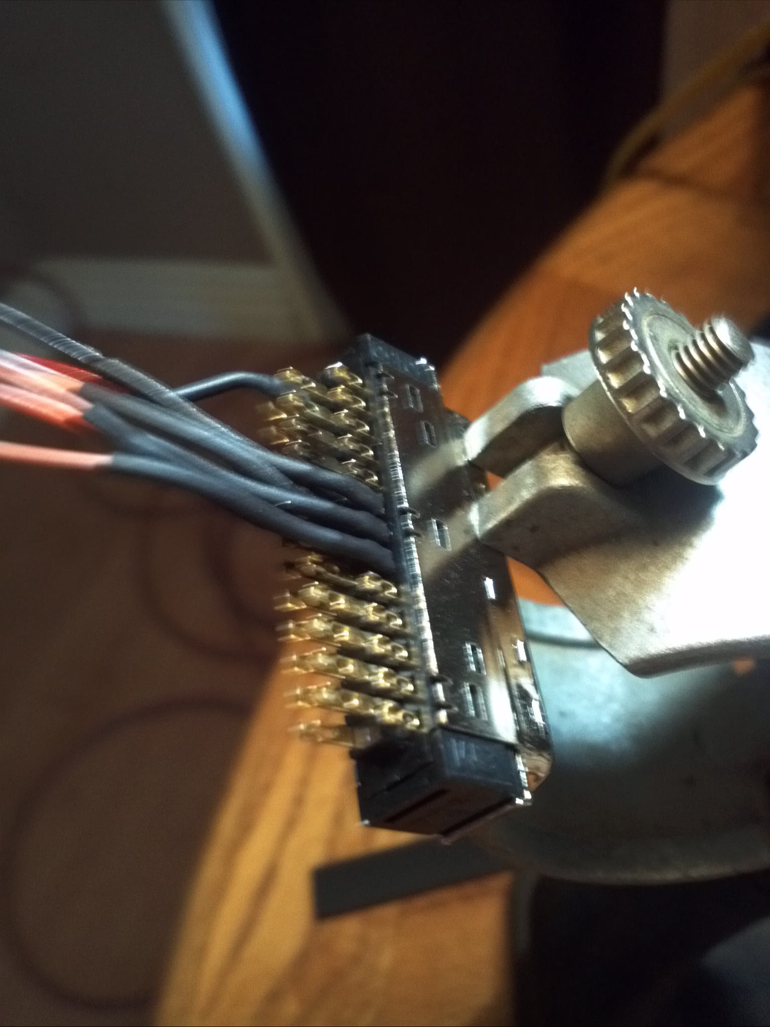

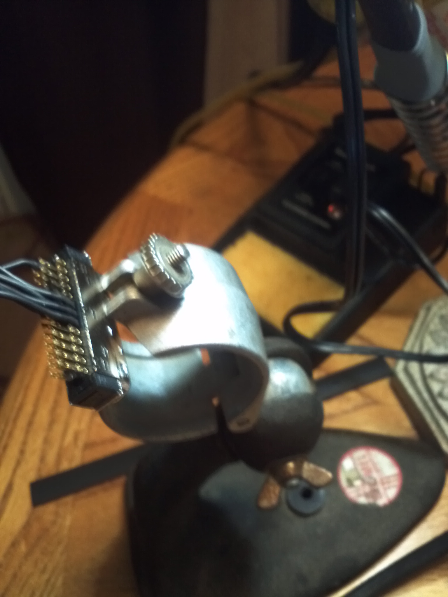

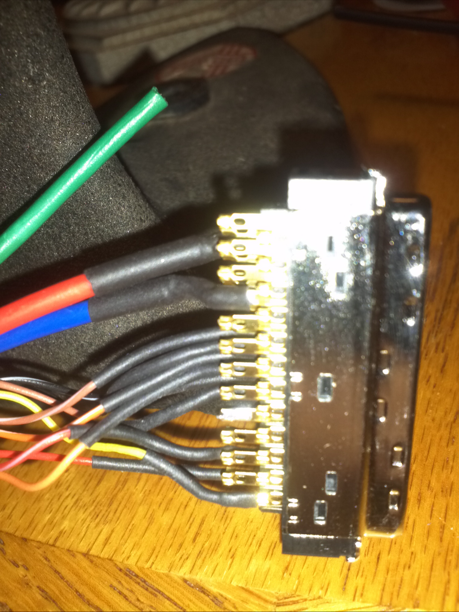

Hey guys,
Well I spent a LOT of time today working on my harnesses for the axis drives. The connector is called the CN1 on the teco drives and I have gotten almost all three done. I am now working on the Z axis harness. The only real difference between the Z axis and the others is that the Z axis brake is wired into this connector here. I called Machmotion today about it and asked them the proper way to wire their brake system up. Basically the system has a small 110v powered 24v power supply that is din rail mountable and there is a 24v mechanical relay that is also din rail mountable in the system. They have the relay supplying power from the power supply to the brake thru the relay and it is triggered by a 24v coil circuit going from pin 20 which is the zero speed pin to the pin 47 which is the DCIM pin. This apparently works such that once the drive is at servo off the brake is enabled. We are jumpering the pin 45 to pin47 so that the 24v power circuit is energized throughout the drives system.
Here is my pin arrangement:
pin1.......servo on
pin35.....Encoder A
pin36.... Encoder /A
pin37.....Encoder B
pin38.....Encoder /B
pin39.....Encoder Z
pin40.....Encoder /Z
pin 26....Analog +/-10vdc
pin29.....Analog GND
pin19.....Alarm signal
pin45.....jumpered to pin 47
pin48.....Ground
pin47.....Servo Brake+(only on Z axis)
pin20.....Servo Brake-(only on Z axis)
There is a green wire remaining and while I think we have everything we need wired up I left it there for now in case we missed any important pins...
I hope we got this right I think it is correct after reading the manual and the pinout several times now. Anyways we are using a brand new SVGA cable which is shielded nicely for these signals and fits the cover for the connectors nicely as well. I am unclear as to whether or not I should secure the cable's shield wire to pin50 at the drive or not I have heard it both ways but most seem to say that I should only ground the shielding at the 7I77 card. Any input on this would be appreciated. Once I get these finished and buttoned up we should be ready to test motors very soon. I am going to need to wait for my 24v relays that will be for the power circuits to arrive before I can apply power to the drives for testing purposes. I am looking forward to seeing motors turn on a test bench soon.
Anyways here are some pictures of todays work....peace
Pete
