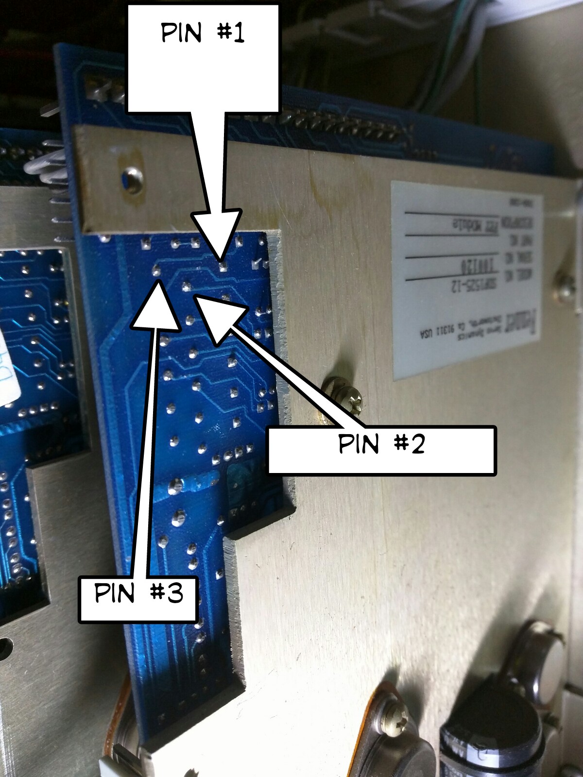

While I was checking I noticed that the drive cards are mounted to a metal card. The backside of the drive cards are covered by the metal card except for the area right underneath the potentiometers/trimmers. That got me thinking that maybe I can turn the pots while using an ohm meter (with the power turn off) to find out when I'm at a "stop".
Since a potentiometer is a length of coiled wire with a "wiper" that travels across the coiled wire (pins 1 and 3 are connected to each end of the wire and pin 2 is connected to the wiper): by rotating the pot CCW the resistive reading between pins 1 and 2 or 2 and 3 should go to 0. When it does I know that the pot is in the fully CCW position.
Shouldn't take long to test this theory out....

10 years 10 months ago #66610
by drembedded
Replied by drembedded on topic Servo Dynamics brushed dc servo (sd1525) tuning
Here's several of the pages showing the potentiometer description and tuning process
