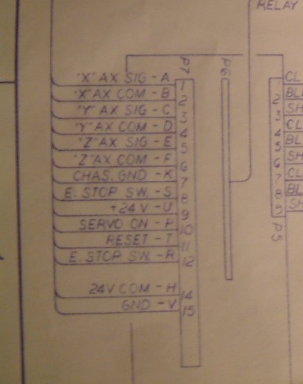

Hey, on the drive to town I started thinking about the connections going into the Anilam Control Box. In the picture below I will be taking the first (6) wires "AX SIG and AX COM and rerouteing them to the TB5 connections on the 7i77. How hard would it be to take all the connections and route them through the 7i77's TB8 and completely remove the Anilam Control Box.
Jim
Jim

I jury rigged another wire from the A-B in the picture above to the ENA0 - COM on TB5. And X axis jogs back and forth in continuous and also moves 1.000 on the linuxcnc readout in increment 1.0. But there is the dreaded dither while holding location. The readout moves back and forth between 1.0002 and 0.9998 while the hand wheel moves slightly back and forth..
Should I test with the current setup moving the A-B feed into the other axis and try jogging them?

Tried it with all 3 axis wire in.
X slow drift in positive direction maybe a 1 in 10 min.
Y runaway in positive direction hits .5 ferror drifts to a halt. I think.
Z holding steady with slight dither.
X Z tested with Y disconnected.
Don't know where to go now. I've traced the wiring and don't see a problem but I may need to pull it apart and test each lead.
Jim

- Posts: 18113
- Thank you received: 5332
05 Feb 2016 21:05 #69668
Sounds like X analog out is not connected (or P term is 0)
Likely means you need to reverse the analog out sign on Y
( Remember my list of 4 things needed to get the servo system working )
Replied by PCW on topic Crusader II retrofit

Since you are running linuxCNC
Go up to tool bar and select machine>calibration
You'll se tune 0
Tune 1
Tune2
These are you axis'
These machines are running a pid (velocity) loop nested in a pid loop ( at least that the way I see it)
LinuxCNC allows us to fine tune the servos
P value on mine happen to be 45
I is 0
D is 0
Bias is 0
FF0 is 0
FF1 is 0.1
FF2 is 0
Try on all axis and see how it reacts
