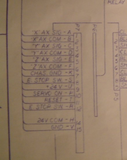

Hello again
Well I decided to continue in this post instead of opening a third in this series.
I am hoping some of the people who have done a retrofit on a Crusader II control before might have some ideas how I can take the Original Crusader Control out of my setup.
The machine is now working well with linuxcnc, mesa 5i25 & 7i77, and using the original control box that still has (8) connections to it through a Bendix 28-16 connector.
Numbering is from the P7 connection shown in the photo.
7) Chassis Ground
15) Electrical Ground
8) E-stop SW
11) Reset
12) E-stop SW
7) 24 volt common
9) +24 volt
10) Servo on
7,15
The first two grounds are self explanatory.
8,11,12
The E-stop has one leg in common with the Reset the other leg back to the 28-16 plug
Reset one leg in common with the E-stop the other leg back to the 28-16
The E-stop button is normally Closed when not set. If pushed it goes to Open.
With the E-stop closed the reset button closes and the main power cabinet comes on. Any time a limit switch is met the E-stop must be opened ( hit ) then released and the reset button pressed and released.
7,9,10
The 24 volt positive, common, and the Servo ON connect to the "Red" card in the anilam crusader II control. The "Red" card is the output card show HERE
Hopefully these connections can be changed to the IO of the Mesa 7i77 card using either HAL or ladder.
Jim

Jamby,
I can't tell from the last post w/ the connector picture as to what's going on? It appears you should be able to wire in the E-stop and servo ON to the 7i77.
Are you running the machine w/ the Crusader RED card powered on?
Also, my guess is that the e-stop wiring is 'logic' only and not e-stop shut-off for the drives. I can't tell from the schematic how that's powered, but it seems like it should be able to be connected to the 7i77. You need to find out what's on the other end of the e-stop wires, ie where's power and ground? GUESSING, maybe the RED Crusader card supplies ground and power and then you can simply move those to a 24vdc power supply on one end and the mesa 7i77 on the other??
Need to confirm via the schematics or tracing the wiring in the control box.
Mark
Mark

Mark
Sorry I've been away awhile working either with or on my backhoe. Anyway, Yes the "Red Card" is controlling both the E-stop, reset of the servos, and the limit switches. Linuxcnc is powering the amp cards and reading the scales.
I looked at some DC-DC transformers . I assume thats what would be required to power the E-stop and limits but I am real fuzzy on where the power would be connected to the 7i77 board. Also developing a hal file to operate the E-stop, limit switches, and reset button are all new to me. I did some reading and there was an example of a hal set up for a test E-stop / reset that look like it could be adapted.
Another knot in my head is caused by readings of 36 volts at the limit switches. With matching 36 volt called out in the schematic. Would 24 volts operate the system with no problems??
Jim
Jim
