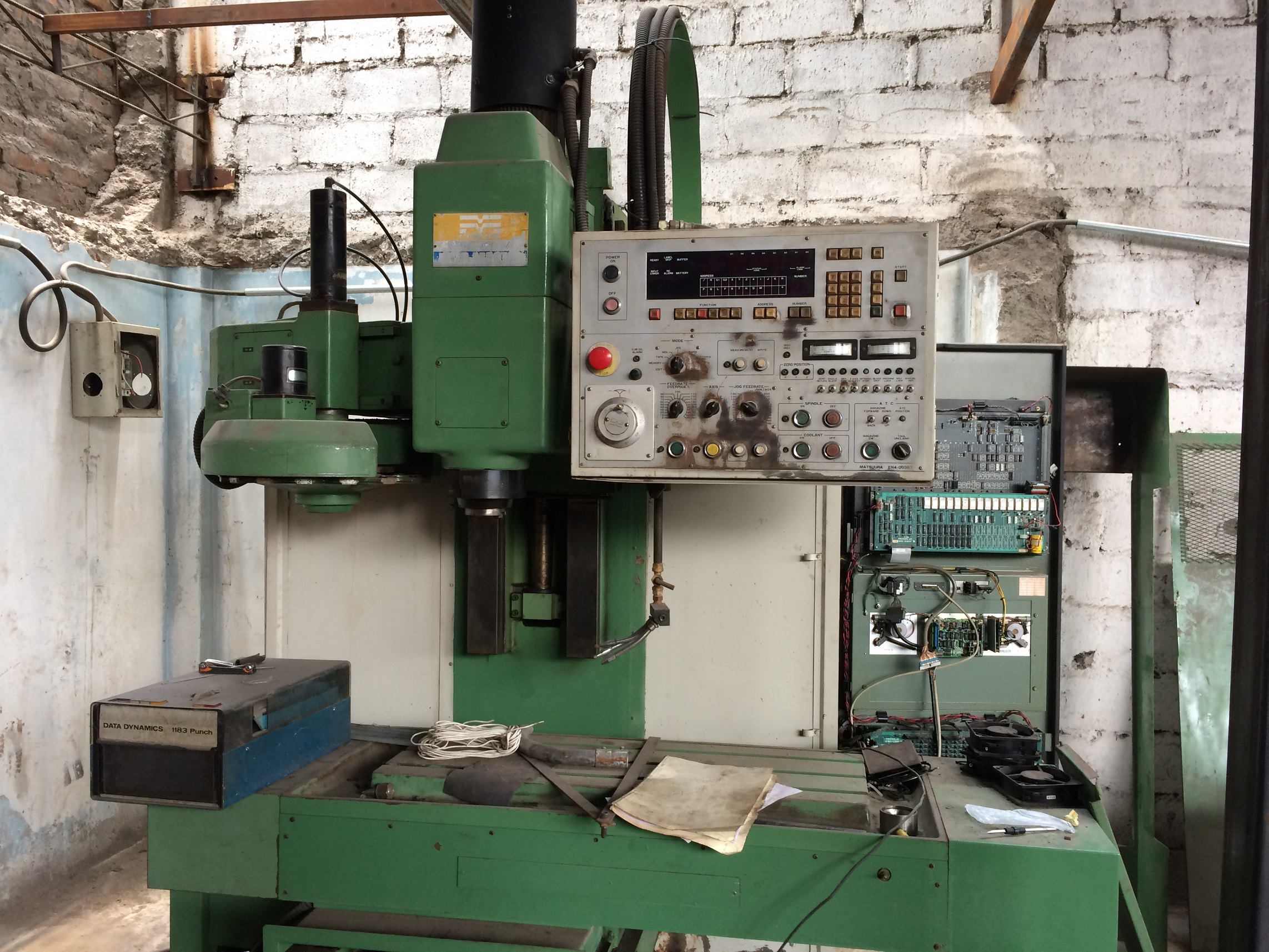

Hello, dear forumers
I am going to retrofit a (new to me) 1980s matsuura MC-500v (picture attached) whose control system is broken (yasnaq 3000g).
Axis servo drives and xyz servomotors are ok, however spindle controller is broken.
This time I am going to use mesa cards 7i92M + 7i77 which I have no previous experience with. I have done a retrofit before using steppers (Optimum BF20 vario) and pc parallel port which seems to be a lot simpler than this retrofit. This time I'm working on closed loop servos , tool changer, spindle control, coolant pump, etc.
I know, there have been similar retrofits before in this forum.
Right now I'm gathering all the information related. And every advice from you guys would be very valuable to me.

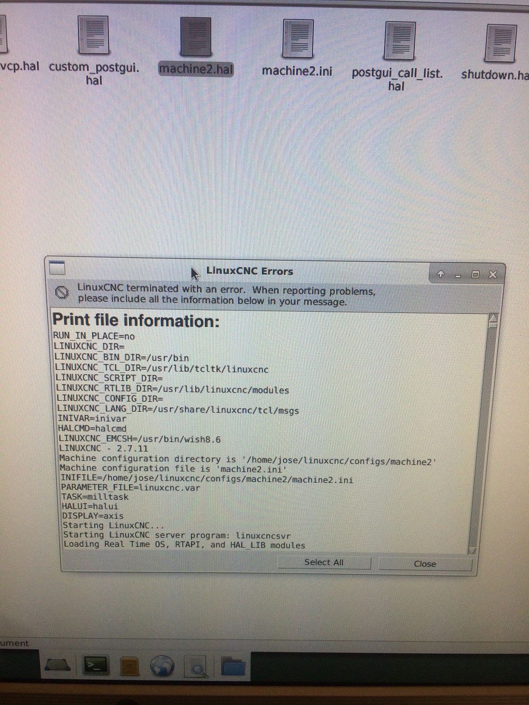

03 Aug 2018 04:10 #115483 by kt600v
Replied by kt600v on topic Retrofit Matsuura MC-500v
Cards arrived a week ago, as of today, I flashed the bit file 7i92_7i77x2D.bit then I've created a very quick configuration using pncconf (for testing purposes coz there are many parameters I'm not sure about) ,edited and replaced any hm2_pci for hm2_eth,
and 5i25 for 7i92 in the hal file, also in the ini file.
when launching linucnc using my configuration I get the error attached .
I'm not sure what i missed so far.... I'm stuck
03 Aug 2018 09:03 #115495 by andypugh
Replied by andypugh on topic Retrofit Matsuura MC-500v
We need more than that.
Can you press the "select all" button in that error report box, then Ctl-C to copy it all to the clipboard, then paste it in to a message here?
The important information is likely to be off the bottom of the dialog box.
03 Aug 2018 15:54 - 03 Aug 2018 16:00 #115529 by kt600v
I have attached the error log , hal and ini file....

Starting LinuxCNC...
Found file(REL): ./machine2.hal
Running HAL shutdown script
Killing task linuxcncsvr, PID=4534
hm2_eth: HostMot2 ethernet driver unloaded
hm2: unloading
Debug file information:
Note: Using POSIX realtime
./machine2.hal:9: parameter or pin 'hm2_7i92.0.watchdog.timeout_ns' not found
4534

03 Aug 2018 16:04 #115530 by andypugh
is the problem.
Line 9 in the file machine2.hal
This might mean that the 7i92 driver has not found the 7i92. Try commenting-out that line and see if it errors-out at the next mention of the 7i92.
The following user(s) said Thank You: kt600v
03 Aug 2018 16:06 #115531 by andypugh
Your "loadrt hm2_eth" line in the HAL seems to lack the "board_ip=" entry. This is probably the problem.
03 Aug 2018 16:17 #115533 by tommylight
Replied by tommylight on topic Retrofit Matsuura MC-500v
loadrt hm2_eth board_ip="10.10.10.10" config=" num_encoders=6 num_pwmgens=0 num_stepgens=0 sserial_port_0=000xxx"
That is the complete line for 7i92/7i77
