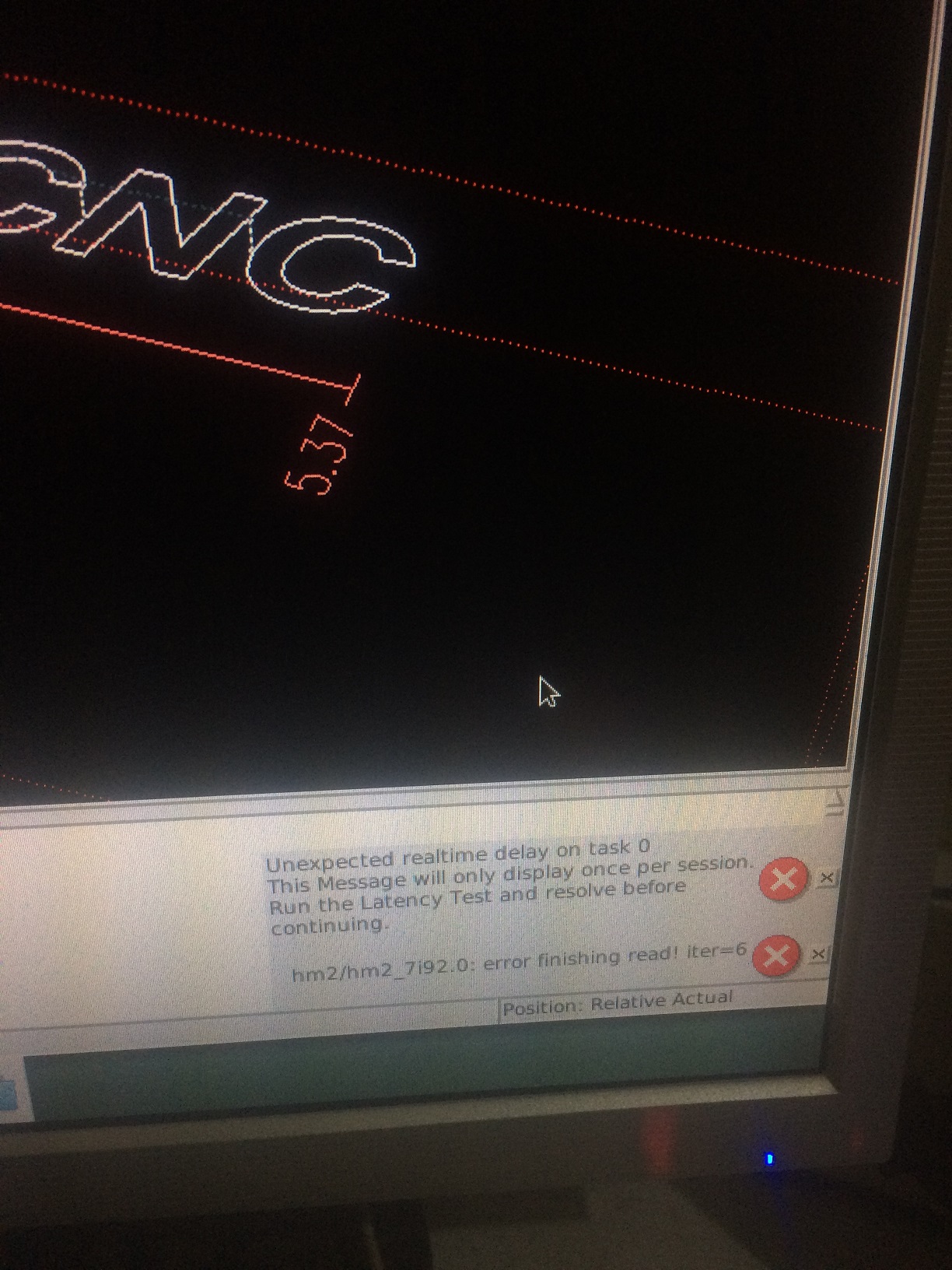

Many thanks for your answer andypugh and tommylight, It was really helpful.
added "board_ip=192.168.1.121" and it launched apparently well.
but These problems appeared: CR16 led is always ON (it just blinks once when I re-launch linuxcnc), plus two error messages (picture attached).
When I run the latency test I get 8999 base thread.
maybe It has something to do with the fact I've installed linuxcnc on an USB stick?

in you .ini file:
SERVO_PERIOD = 15000
should be
SERVO_PERIOD = 1000000
( 1 ms period = 1 KHz servo thread )
should be

Many thanks PCW the problems dissapeared
may I ask what SERVO_PERIOD value means? why is it 1ms?

The servo period is LinuxCNCs "slow" thread and is the update rate of high level LinuxCNC operations like the trajectory planner and PID loops. On systems with hardware stepgens/analog outputs/encoder counters, no high speed "base" thread
is needed so only the slower servo thread is created.
The thread can run faster than 1 ms depending on interface hardware and the CPU
but unless you have a very high performance machine, a 1 KHz servo thread is usually adequate.

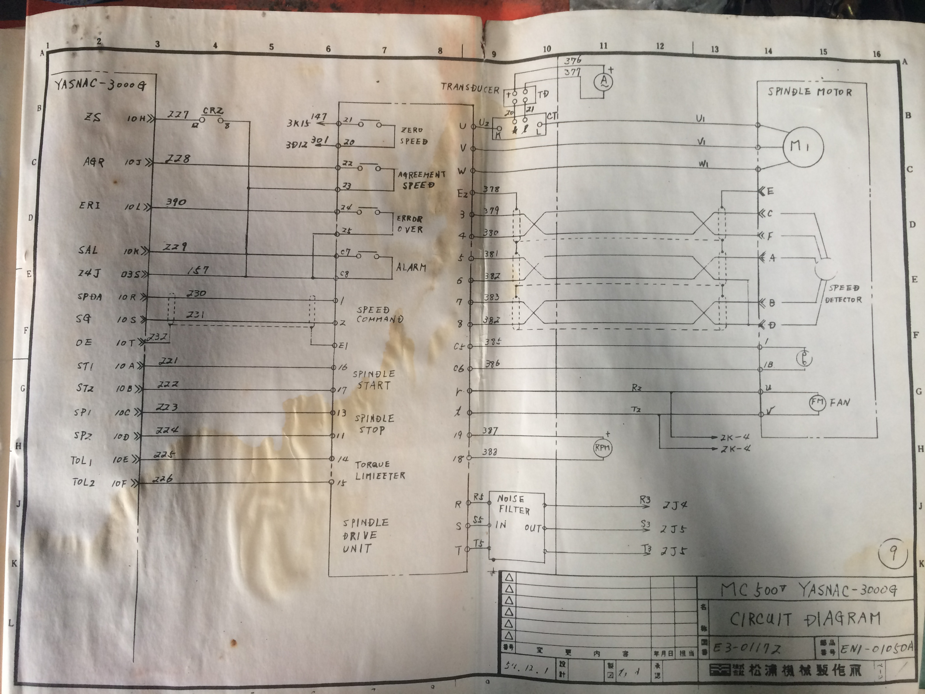

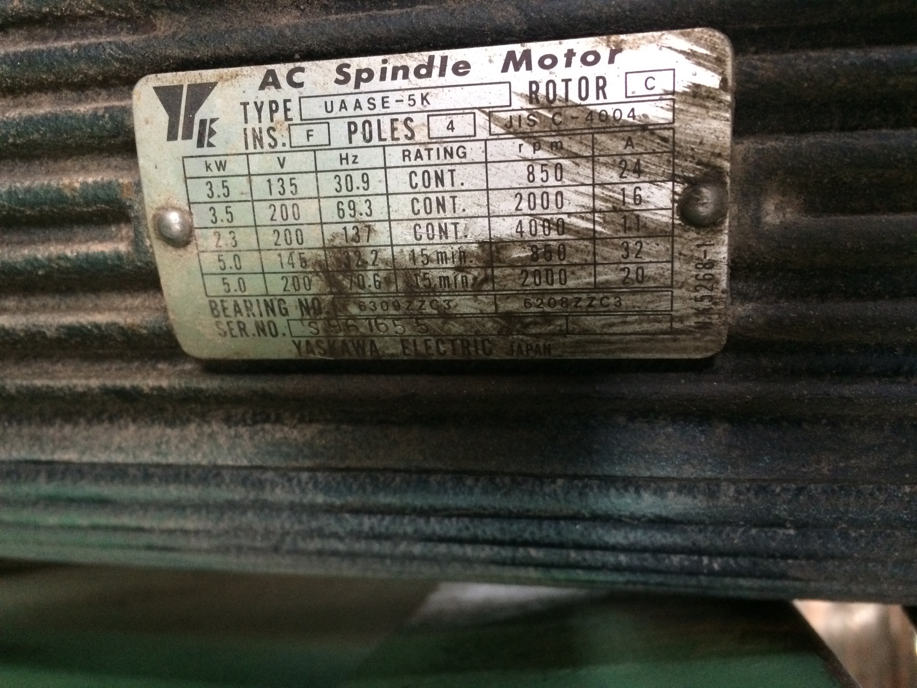

I've been looking for a spindle drive unit replacemente since the original one is broken. My local market offers some models with independent control but I couldn't find any I can control throught a speed command (0-10V) , (and other signals like spindle stop, spindle start, etc).
At this point, any advice about how to control this spindle would be very welcome.

It looks like a motor that can be driven by a 5kW VFD?
What sort of drives are you looking at that can not be externally controlled?
Sam has made the Matsuura changer work with LinuxCNC

I'm looking for a 5KW VFD that can be driven through a +/-10 V (speed command), The ones i've found have a manual frecuency set.
