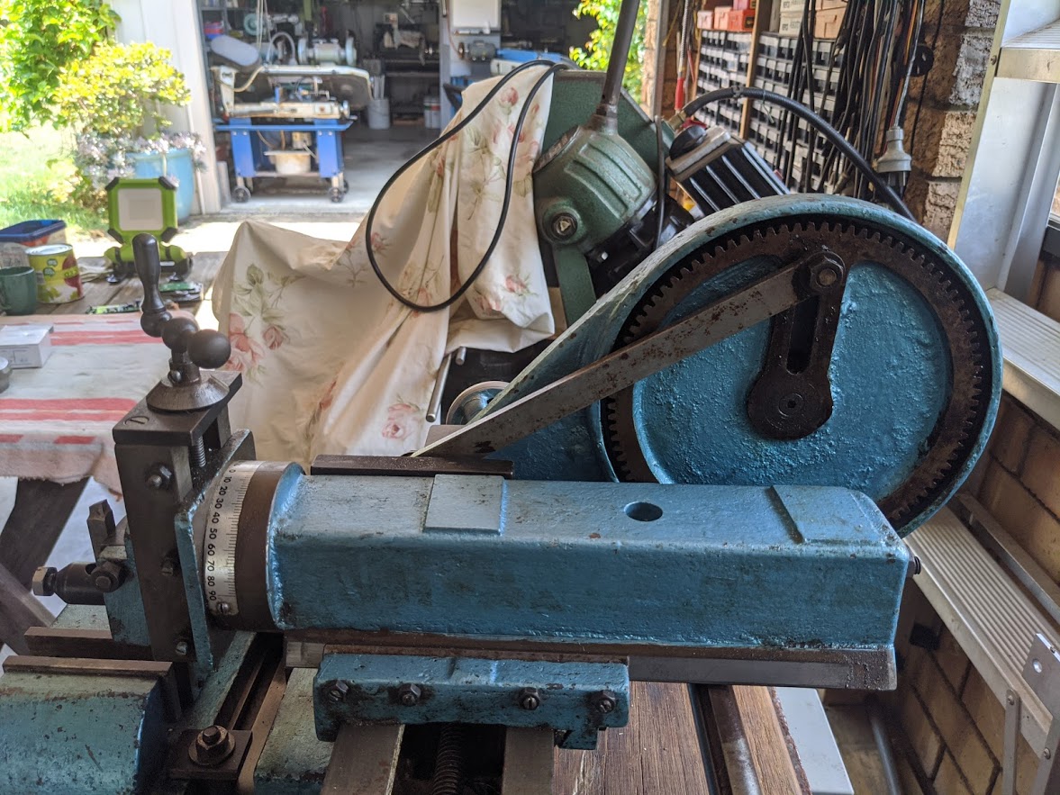

So now have this clear in my head. Here is a couple of photos of a shaper and a CAD design for one courtesy of my mate Chris..
This one uses a bolt in a slot as Andy proposed, nice and easy.

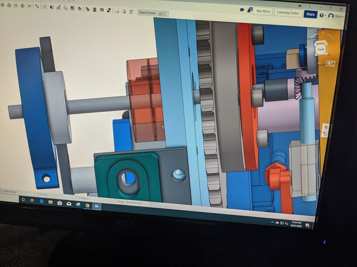

And here is Chris's CAD design in OnShape using bevel gears to adjust the stroke with some parts supressed.

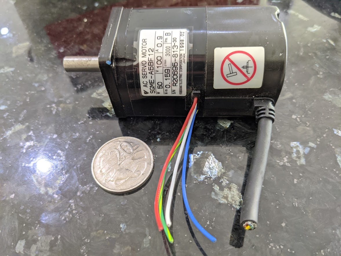

And the little servo I have that is looking for something to do... Aussie 20c piece for size reference.
This is very cool to watch the animation running.

That's a slightly atypical shaper. Bigger ones have a handle that allows you to adjust the stroke while the machine is running (though the handle typically rotates, and the operator has the job of turning the handle faster or slower than the "natural" speed to adjust the stroke. Which is pretty much what the servo needs to do, but using encoders.
I have had a think on the way in to work today, I think you can retain the crank-on-motor design and still have CNC stroke adjustment.

There were some 6 wire ones with thicker wires (5 amps they said), good for 800 rpm. I'll look a bit more. Simple is good but a couple of zigbees maybe? Just send Gcode to a Grbl controller.
Next thing you'll want to be using an AC servo with mutiplexed step and direction signals somehow.
BUt if the stepper was under Linuxcnc control, life would be easier as it could be calibrated as if it was just another axis.

10 Jan 2020 13:25 #154547
Replied by andypugh on topic I had this crazy idea - Lets build a shock dyno with Linuxcnc
a360.co/2scAC2g
Bevel gear on the leadscrew (not shown) that moves a "big end" on a plate mounted to linear rails (not shown).
The mating bevel gear is carried on a bearing (possibly double row) pressed on to the taperlock hub.
A toothed belt drive (not shown
) from the stroke adjust servo rotates the bevel gear.
But the bevels themselves look pretty costly:
www.hpcgears.com/pdf_c33/14.16-14.22.pdf

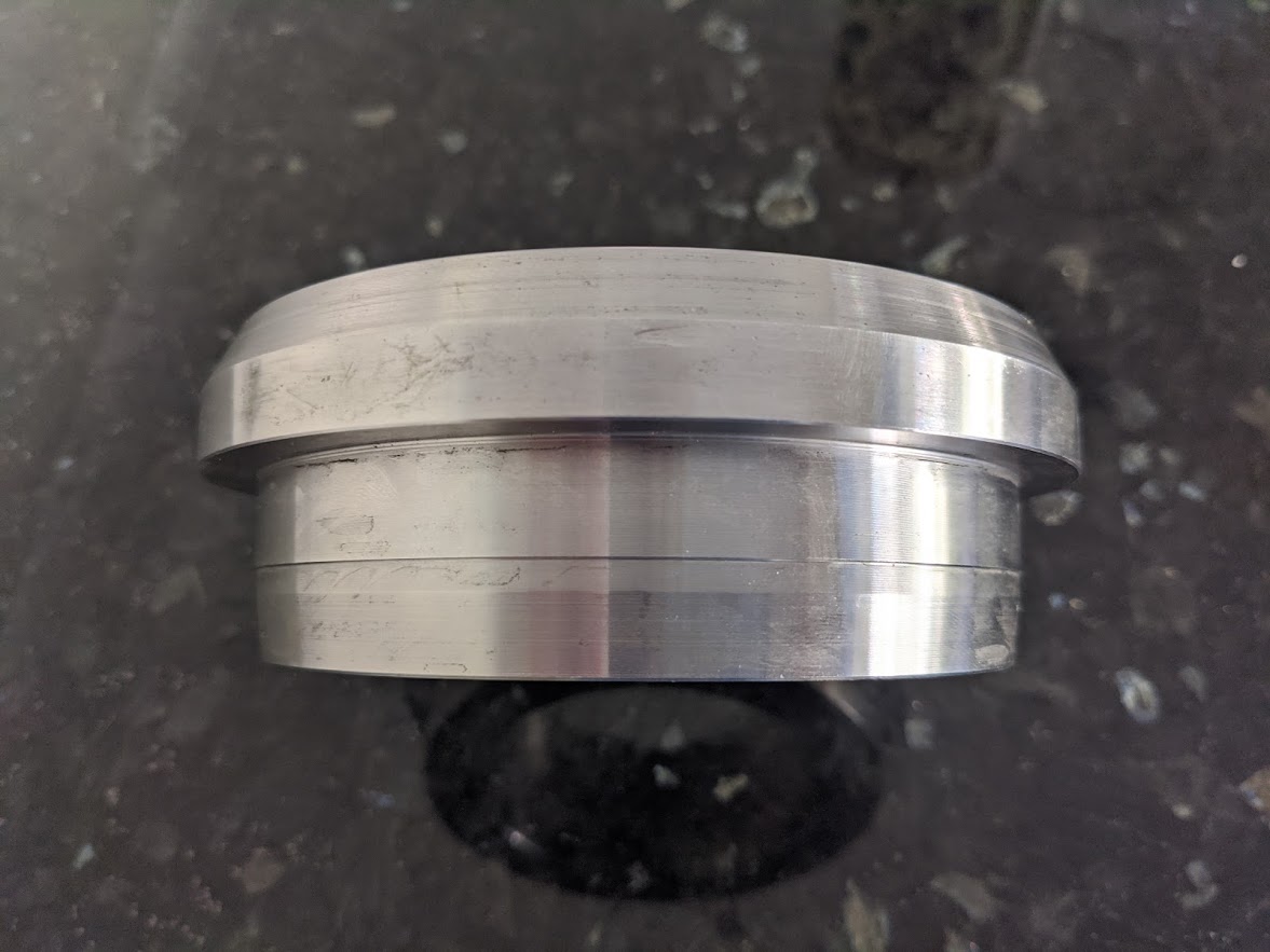

Andy thanks. Took me ages to workout what you had done. After I dug in to your assembly I found a taper flange.
Here is what the side profile of my flange looks like
So welding a 16mm plate (with a hole in it) flush with the top face of the flange would be nice as there would be a groove for the weld.
The wide part of the flange is 20mm thick so it will protrude on the rear (motor side) 4mm and there is a 12mm parallel section to press your bearing assembly too. I think it needs to carry an encoder for the motor too so it might be a big bevel gear.
Pretty sure I could source them from Ronson Gears heare in Aus.
There will be about 35mm of room behind the flange so there is plenty of room.
