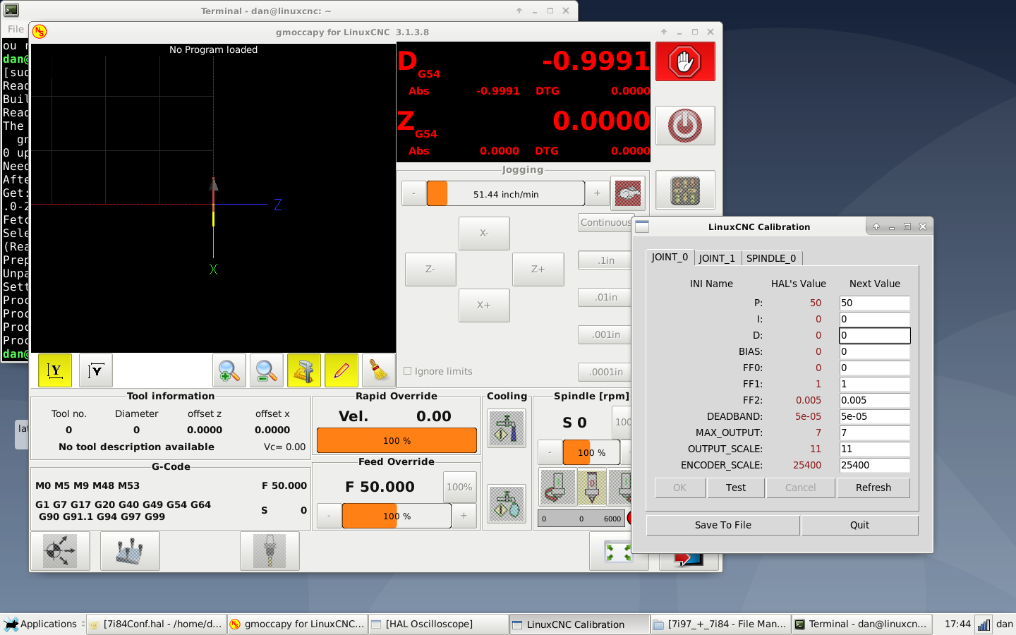

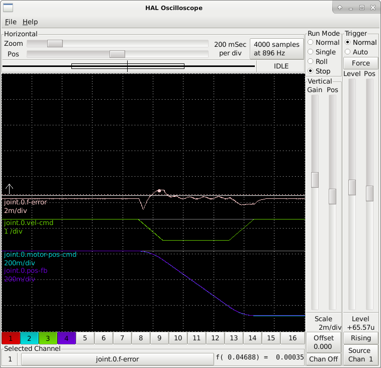

So good news, i figured some more things out.
Sometimes i think about things too much and totally miss important pieces of information.
I hooked up the machine drive so i could power the actual axis. I had a deadman switch for E-Stop so if anything began moving in a way i didnt like, i just let go of the button and everything loses power.
I verified my encoder scale. Which i was super happy about.
Upon moving the axis around i still had strange error in Halscope. So i played with the P gain, and the FF2, but it just didnt seem right. I had P gain up to 120 and still seemed like it was just lagging and not happy.
Then it happened, a big realization i came to was setting my output scale. I had my output scale set to "35".
I came to 35, because my Yaskawa servo drive was set to a scale of 210/Volt.
So i did 210 * 10 volts = 2100, 2100/60seconds, 35inch/sec.
However, i completely disregarded the fact that the drive only knows SPEED, and not linear motion.
SO its 210RPM/volt * 10volts, 2100RPM. 2100RPM, is equal to 661inches/min based upon the gear ratio and leadscrew pitch. 661/60seconds = 11.01 inches/second.
This was the Ah HA! that i needed. Upon setting the scale properly, the drive tracks sub 0.001 error.
I just dont know how perfect this should be so im posting images of the setup and the halscope plot.
I do see some oscilation in the "cruise phase", so i belive i need to lower my P gain, but i figured i would post it here to get some more experienced opinions.
04 Sep 2023 09:49 #279809
Replied by andypugh on topic Bridgeport/Romi EZPath S Retrofit Planning
Do you have pid.N.command-deriv connected to joint.N.vel-cmd ?
That might be worth trying.
- TurboStreetCar
- Posts: 40
04 Sep 2023 11:48 #279814
by TurboStreetCar
Replied by TurboStreetCar on topic Bridgeport/Romi EZPath S Retrofit Planning
I've seen that mentioned before. Is there a pro and con to having that in the HAL file?
Is there a reason it isn't there by default?
Does my error look acceptable? Its peak is about 0.0005 inch.
The halscope trace was made by doing a G1 X-1.0 F50 from X0.0 position.
04 Sep 2023 11:53 #279815
The velocity pin is marked as "debug" so possibly it is not used by default as there was a worry that it might be deleted in the future (it won't be)
Your f-error is probably OK, bearing in mind that it is a positional error _along_ the path rather than perpendicular to the path.
- TurboStreetCar
- Posts: 40
06 Sep 2023 01:10 #280041
by TurboStreetCar
Hmm ill have to add that to the HAL file and see what kind of difference it makes.
What do you mean by along the path, rather then perpendicular to the path?
