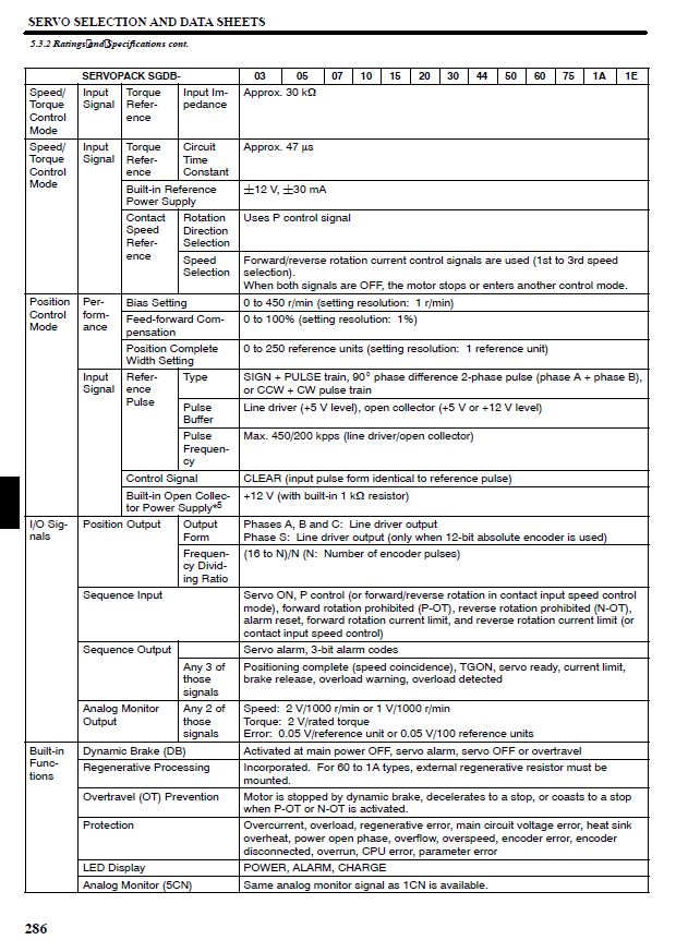

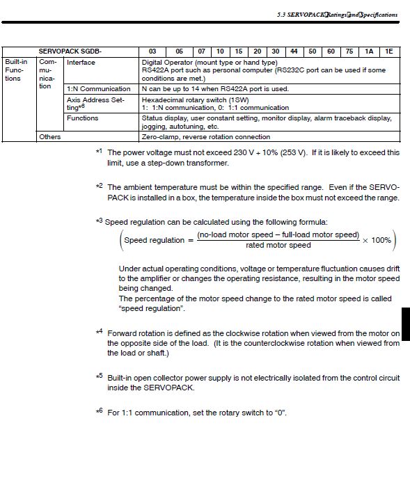

18 Jun 2023 19:02 #273800 by MobilierGuibert
Replied by MobilierGuibert on topic Retrofitting SCM Record 121
The NUM controller is good, can I use linuxcnc to communicate directly with it?Not likely as linuxcnc would actually replace the controller.First thing you'll need to know for a refit is what interface those yaskawa drivers are using. Could be analog  (eg -10V), digital (step/direction) or some serial communication protocol. If you can upload some pictures of the driver plates and/or relevant schematics there may be users who can tell you that if you don't already know.Thanks,The servos drives are Yaskawa SGDB-10-VD for X and Y, I think SGDB-20 for X.SGDB series drives documentation
Thanks,
Servo drives are Yaskawa SGDB series (SGDB-10-VD for axis Y and Z), (SGDB-20-VD for X axis).
If I understand the specifications it is driven by analog +/-12V. Am I right? Or it seems there are other types of controls.
These pages are from the TSE-S800-16E pdf available online.
18 Jun 2023 22:32 - 18 Jun 2023 22:40 #273811 by Aciera
Replied by Aciera on topic Retrofitting SCM Record 121
I'm not familiar with yaskawa but it looks like you can use step/dir for position mode and use the encoder output of the drive for positional feedback for the linuxcnc digital readout. This would be rather easy to interface to.
What about the spindle, does that use the same servo drive?
[edit]
the (+-2V to +-10V) analog input would be for torque/speed mode where you would have to close the PID loop in linuxcnc. I presume your motor encoders go directly to the servo drive as the drive has an encoder output so they are probably already running in step/direction (ie positional) mode. The spindle drive may be different. A look at the schematic may give clarification here.

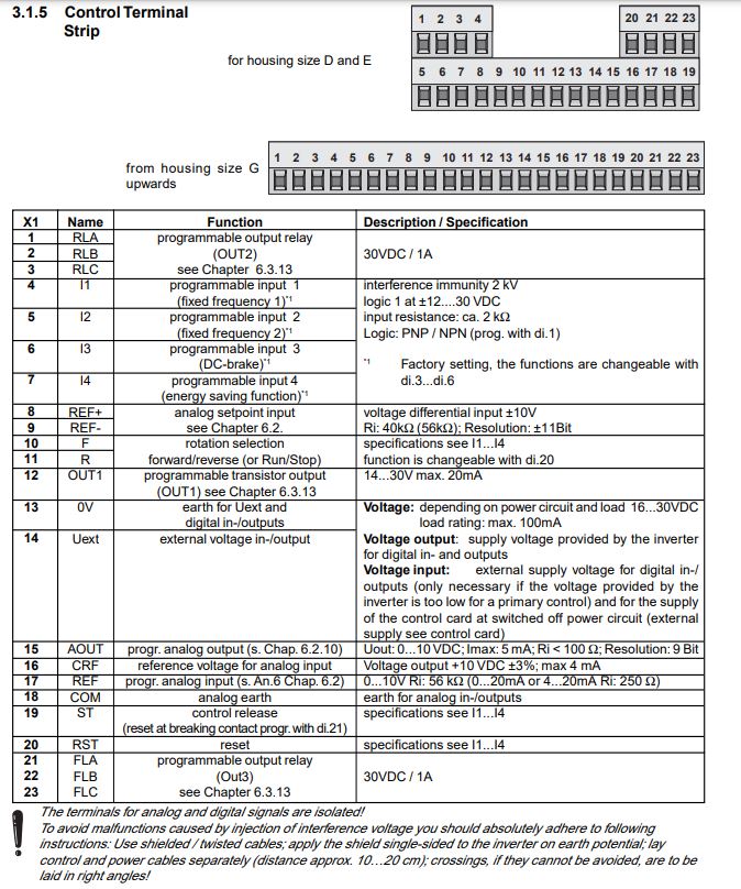

@Aciera the Spindle drive is a KEB Combivert F4 (I attached the page of terminal wiring).

19 Jun 2023 11:40 #273844 by Aciera
Looks like the spindle is a regular analog command. I'm not certain about the most recent mesa hardware but with most boards a max voltage swing of 15V (eg -7.5/+7.5V) used to be possible so for -10..+10V you might need to use a relay to switch the analog output voltage from the board. Your KEB Cmbivert might also provide parameters to scale the spindle speed to other voltage ranges like 0..10V or -5..+5V or a reversal using digital inputs.
