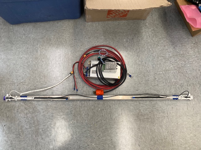

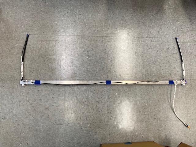

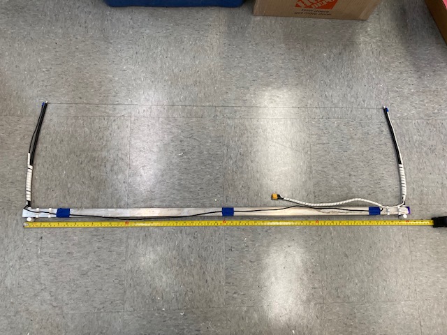

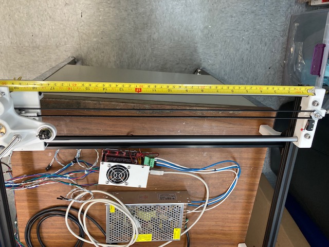

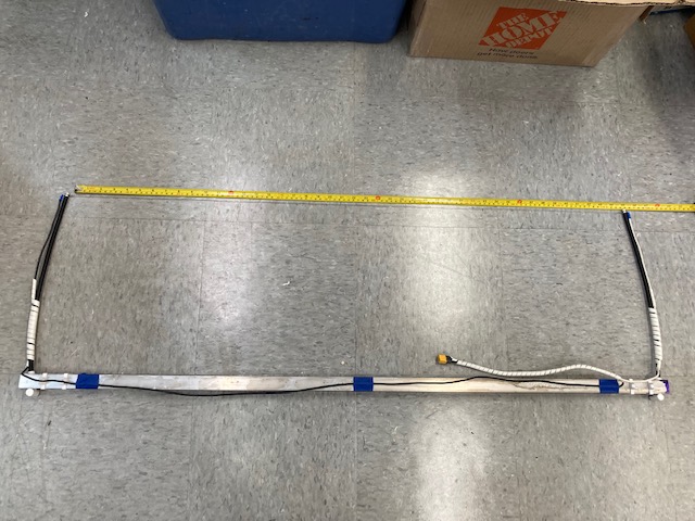

so basic travels are
450mm or 17.7in. in X travel
350mm or 13.78in. in Z travel
and when equipped
700mm or 27.56in. in Y travel
Though the photos don't show the machine in full setup configuration
it will be 1000mm wide X 600mm long x around 500mm tall.
current control is for now GRBL 5X
and RAMPS 1.4 break out board
The bow uses a 48in. long 1in. X 1in. X 0.0625 wall aluminum boom
I 3D printed the Isolator adapters out of PETG and used 2
carbon fiber arrow shafts cut in half for the tensioner posts.
I retained the threaded ends for the wire attachment and electrical
connections. I use a 22ga. nichrome wire for the hot wire.
For power supply I use a 450 watt 24 volt std power supply
and I use a 30 amp PWM brushed motor speed controller
to dial in the energy needed for the wire. That also means
I can use thinner nichrome wire if I so choose.

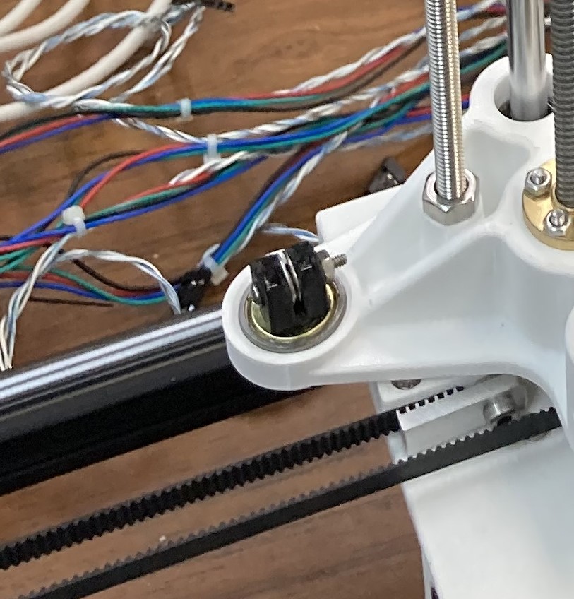

2 years 5 months ago - 2 years 5 months ago #300882
by my1987toyota
Replied by my1987toyota on topic Mostly 3D Printed CNC Foam cutter
I actually will be using it in 4 axis configuration. Though my Slow ultra stick will be using straight wing cuts.
That's why I am using a bow to handle the wire tension. The attached picture shows the wire yoke. It's designed
to keep the wire mostly in place but will allow it to slide between the two metal washers and also deal with the angular
alignment when the two Z axis are not parallel to each other . the bearings will also allow
for angular misalignment of the two X axis. As I am typing this I am starting to realize that I may need to do a video
showing the misalignment capabilities of how the system works. Fortunately I have time this weekend to do it. image missing /media/kunena/emoticons/cool.png
