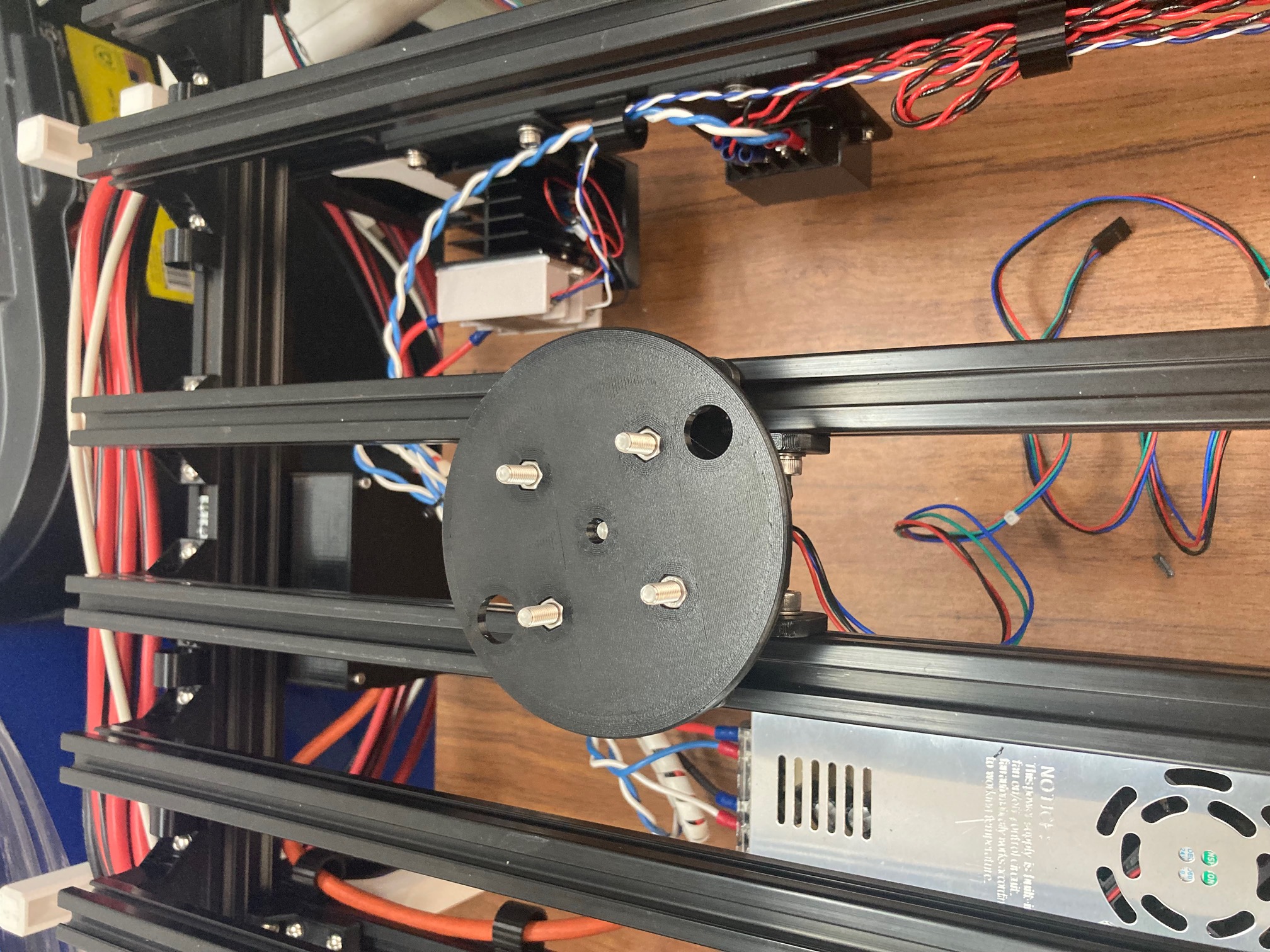

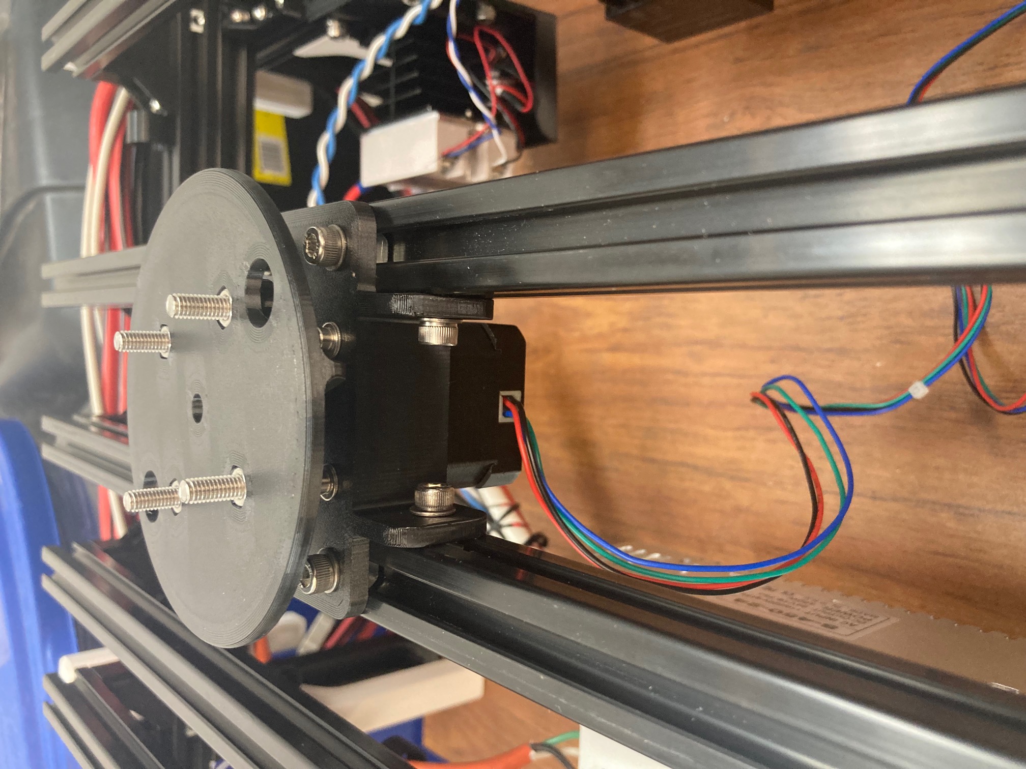

  So it's been a few weeks since an update  and I figured I would post a few pics of my recent progress.
Did someone say 5th axis? Because that's what this is

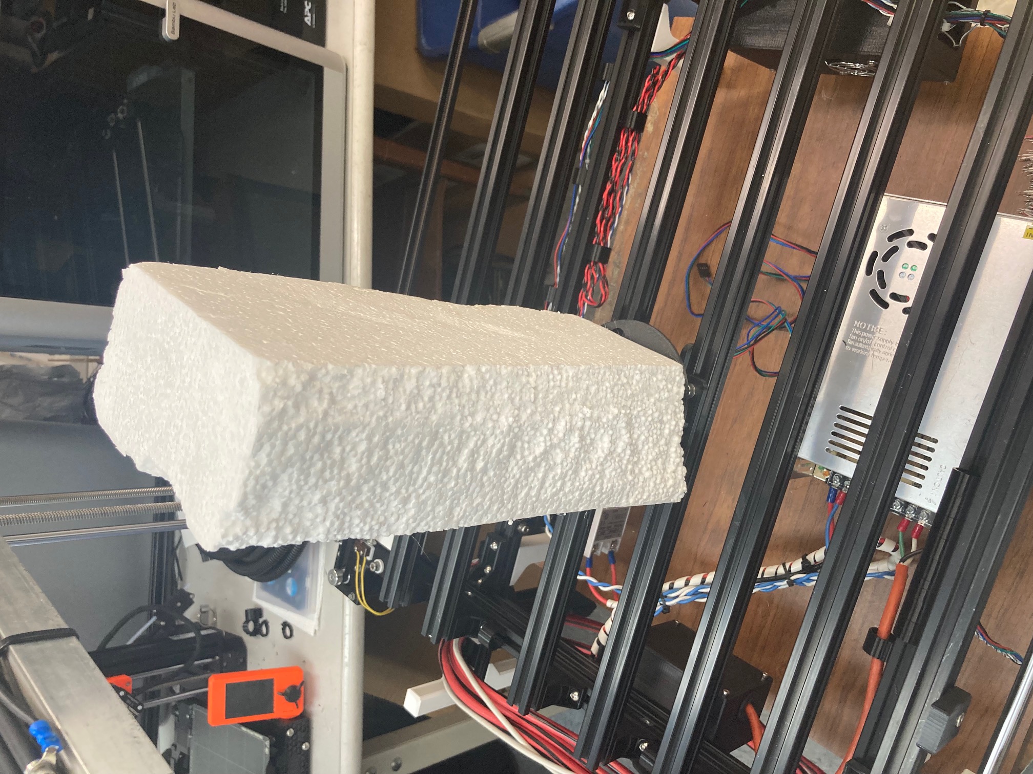

And with a piece of foam mounted on it

I still have to figure out exactly how to get the GRBL controller to work with it but that's a different matter altogether.
I may be at the point where I have to switch to the Marlin firmware.  but we'll see.

16 Jul 2024 23:15 #305433 by tommylight
Replied by tommylight on topic Mostly 3D Printed CNC Foam cutter
Yay, it's spinning ! :)
I did build one of these some 15 or more years ago, dimensions are 1X1X2 meters (2 meter wire length) with all independent axis and a rotary table that can spin me, easily. Still working, the only issue it ever had is a lighting strike killed the old Dell PC so yanked the HDD and put it into a new-ish one, still working, still using Ubuntu 10.04 i had installed when it came out, it had 8.04.
It can do 3D stuff at 1X1X1 meter at once, so it did a lot of decorations for some fancy hotels around here.
As for GRBL/Marlin, sooner or later you will have to move to LinuxCNC, although i do recall vaguely there was a software for wings, no idea what exactly it did, but pretty sure it was open source.
