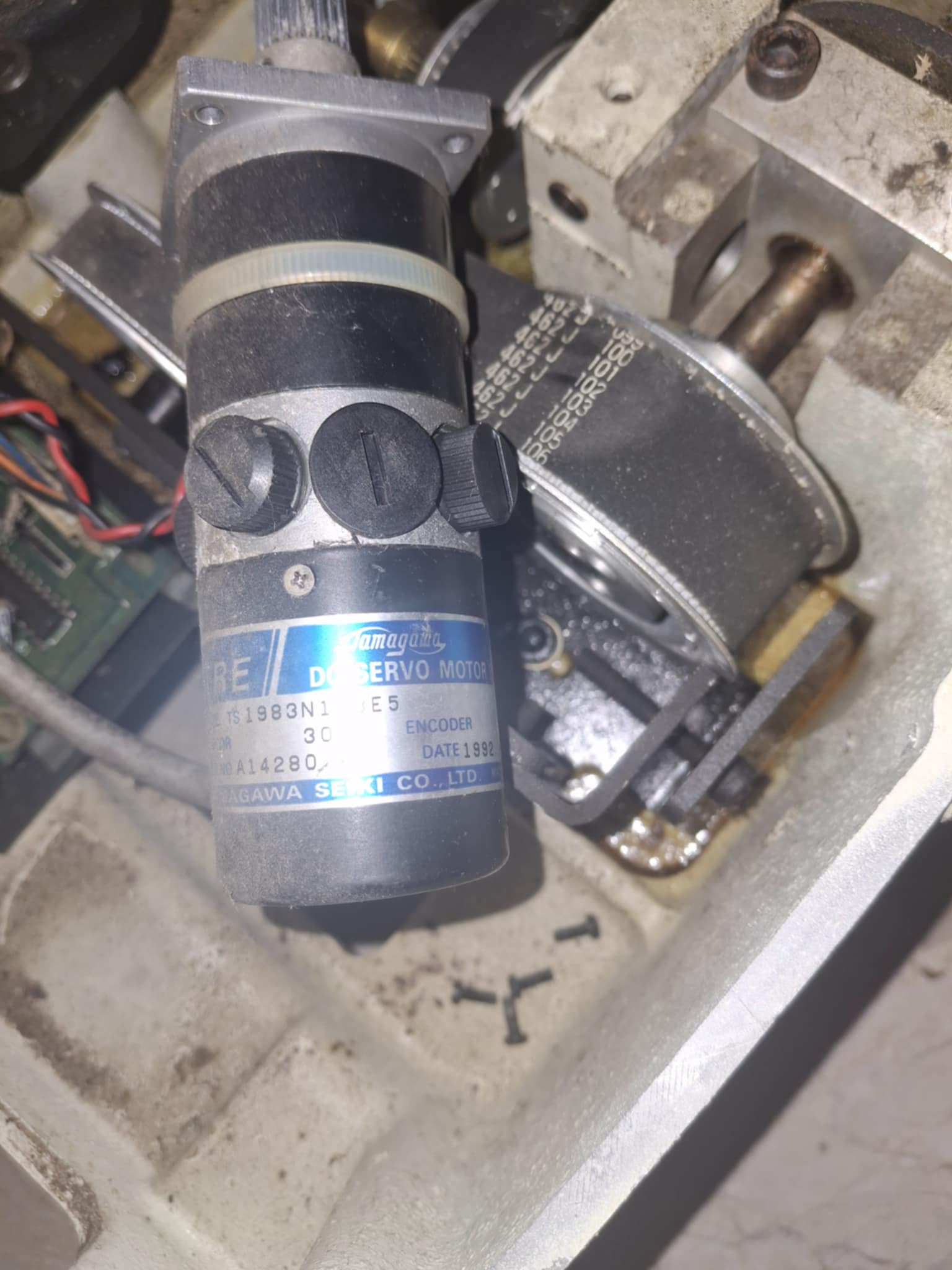

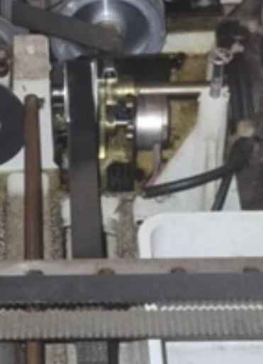

I've managed to recover a Toyota ESP embroidery machine, but it's broken down to the level of the electronic board, I have the impression that it has lost all its parameters, there's a ‘-’ on the screen and then nothing.
I'm going to retrofit it and drive it with linuxcnc.
Following the dismantling of the casings, I have a few questions:

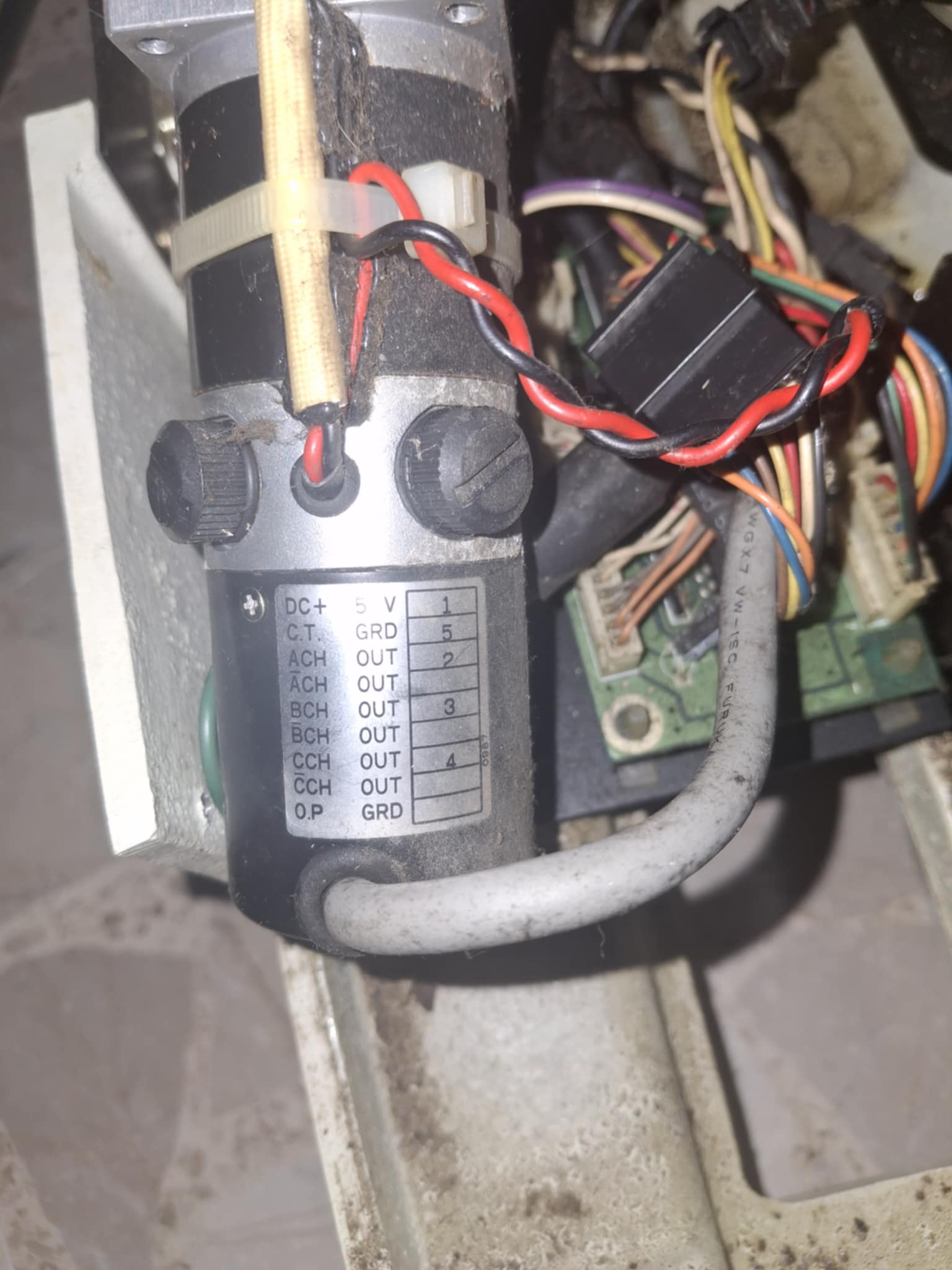

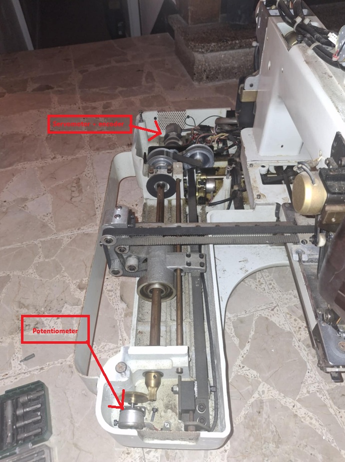

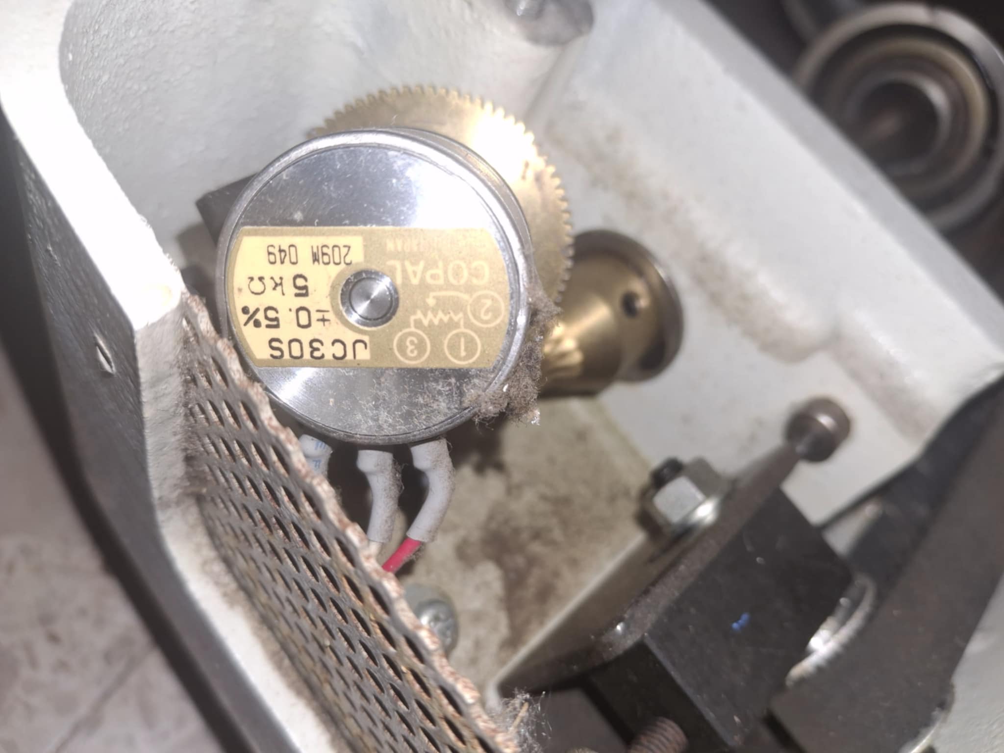

-1: I have a DC 30W servomotor with 500 pt encoder in single ended 5V. and at the end of my axis I have a Copal JC30S potentiometer. Does this potentiometer correspond to a tacho (speed control)?

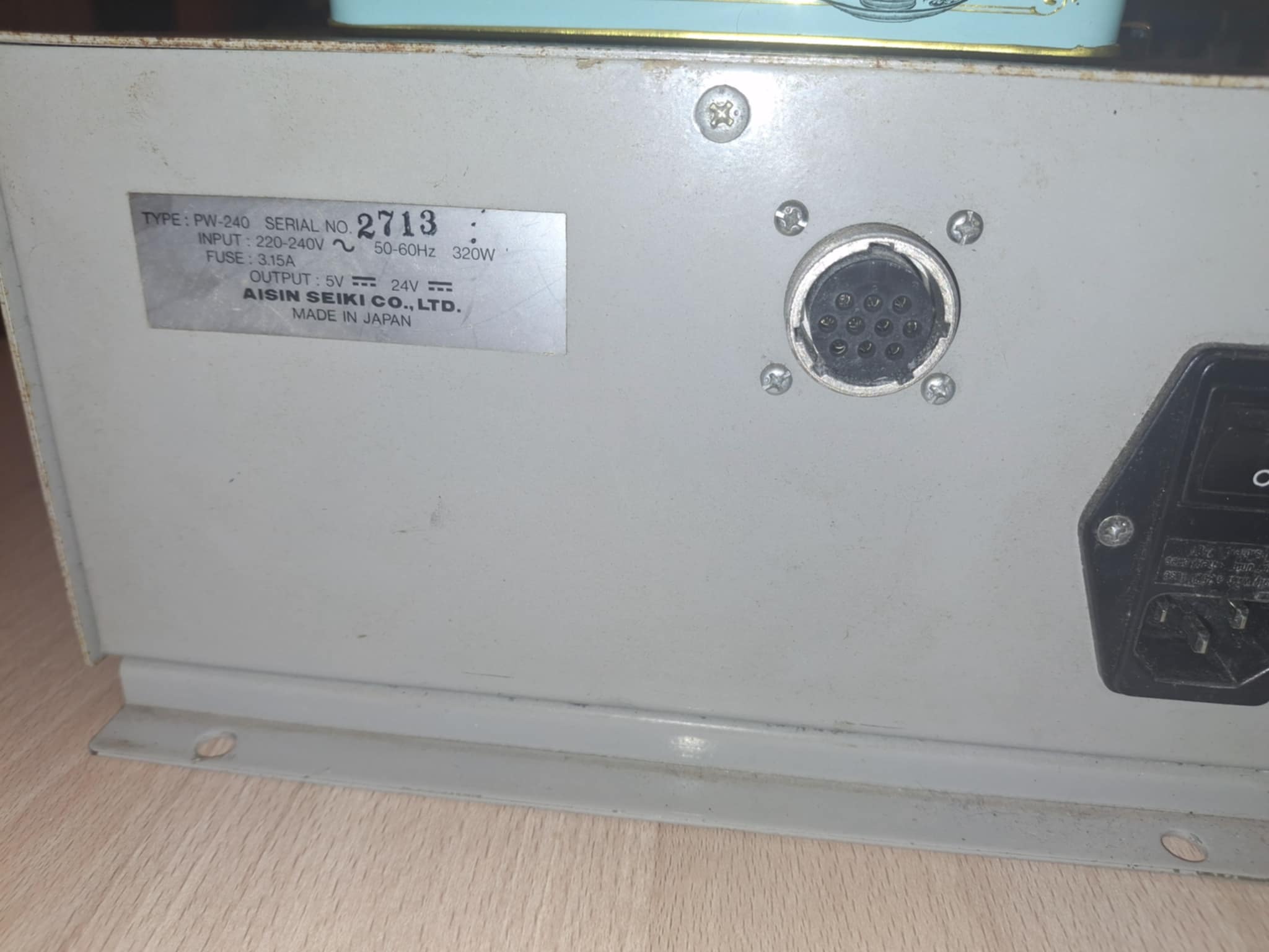

-2 : On my motor, the maximum voltage is not indicated. To power my machine, I use a power supply that mixes 5V and 24V DC. I assume that its motors are powered by 24V DC, correct? Do you know of any DC driver references for this motor power with tacho (if the potentiometer has one)

02 Jun 2025 17:29 #329573 by PCW
Replied by PCW on topic Toyota embroidery machine - retrofit
I think the potentiometer is being used as an absolute position feedback device.
(probably meaning that the long shaft only turns a few times)

03 Jun 2025 16:40 - 03 Jun 2025 16:41 #329634 by greg23_78
Replied by greg23_78 on topic Toyota embroidery machine - retrofit
OK, I understand.
But what is the operating condition of this potentiometer?
- Is it precise enough for me to use it for position control and the encoder for speed control?
- it only allows the machine to be homed without moving to a homing switch (the embroidery machine doesn't have a home and limit switch).
- does it allow homing and limit switches? If so, would a potentiometer for travel limits be useful in addition to the soft limit, or is the soft limit enough?

03 Jun 2025 17:07 #329636 by tommylight
Replied by tommylight on topic Toyota embroidery machine - retrofit
Does the pot have hard stops?
How many turns does it take to hit those stops, if any?
How many degrees can it turn, if it does less than 1 turn?
03 Jun 2025 17:40 #329640 by PCW
Not sure how the potentiometer was used but It could replace home/limit switches
(and since it's absolute no homing cycle would be needed at startup)
The encoder is possibly used for both position and velocity feedback
Is there another motion axis?

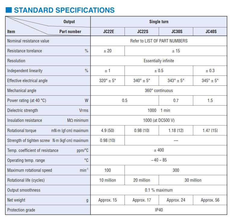

04 Jun 2025 02:26 #329669 by Aciera
Replied by Aciera on topic Toyota embroidery machine - retrofit
www.alldatasheet.com/datasheet-pdf/view/862058/COPAL/JC30S.html
04 Jun 2025 02:31 #329670 by Aciera
There is and it seems so be using the same potentiometer setup:
04 Jun 2025 05:12 #329679 by andypugh
Replied by andypugh on topic Toyota embroidery machine - retrofit
I think that if you scale the potentiometer voltage to position, and latch it in HAL (you can do this with a mux component, with the output wired to the input, and triggered by machine-is-on) and add that to the scaled encoder position from the motor encoder, then you would have a "good enough" absolute encoder emulator.
Then configure HOME_ABSOLUTE_ENCODER in the INI
04 Jun 2025 05:13 #329680 by andypugh
You might want to set feed-hold when the needle is down, and release it when the needle is up...
