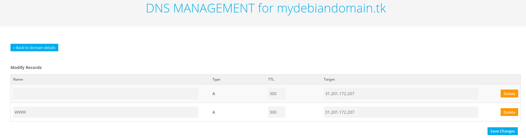

15 Apr 2019 18:18 - 16 Apr 2019 00:48 #130913
by Grotius
Replied by Grotius on topic C coded dxf to g-code converter, the building process...
@Tommy,
Indeed. I was fucked up for 2 day's with this problem.
For the webserver candidates i made a short file patron. It can be used for the nginx webserver configuration.
It think it will work for apache in the same way. To store this info, other users that are building webservers can take a look at the files in the future. And that is nice. Open source.
It took me over 2 day's to find out what i was doing wrong. And finally the conclusion was i think a lack of a good tutorial.
There are good tutorials, but the etc/host file is very important. Also my router must forward internet traffic to pc.
This is on the modem : forward DMZ. how to
At last i switched from apache2 to nginx. Attached files will bring luck to your configurations.
For the free website name, i used freenom.com
For debian / ubuntu / mint, you can use this on your desktop pc, change your ip. How to is in the user commands.txt file.
The nice thing about this.
I made a test website with .cgi extensions, that i will bring back online soon.
For cgi i will provide the additional info to enable.
cgi extenstions are based on pure c code driven by the server.
By the way. At this day's server's are not providing this anymore. I think it has to do with safety issue's.
The power of this .cgi code (pure c) related to the linuxcnc (environment) has almost unlimited capabilities.
Much more then Java can do. We can move the cnc machine from a host website.

The site mydebiandomain.tk is a test site. It is only online when my pc is online.
mydebiandomain.tk
I will make a second domain for the c coded (cgi) interfaces. This i tested and works very nice to do additional tasks to provide info.
