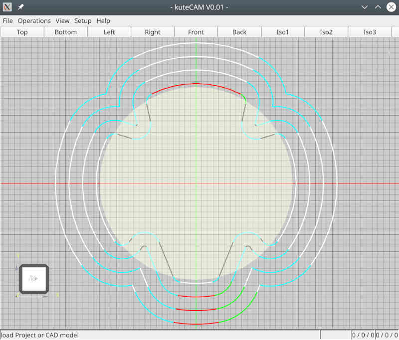

For retrieving the parameter i looked at the sketch lib of the Russian guy.
There was a lib called ELClib. This ELClib is huge, many functions.
For the line the function could look like:

//! for the equivalent Geom or Geom2d curves.For the line the function could look like:
#include <Geom_Line.hxx>
#include <Geom_Circle.hxx>
#include <gp_Pnt.hxx>
#include <AIS_Shape.hxx>
#include <BRepBuilderAPI_MakeWire.hxx>
#include <BRepBuilderAPI_MakeEdge.hxx>
#include <ElCLib.hxx>
void OcctQtControl::on_pushButton_line_pressed()
//! The line example :
gp_Pnt a{0,0,0};
gp_Pnt b{100,100,0};
double linelenght=a.Distance(b);
std::cout<<"linelenght:"<<linelenght<<std::endl;
//! A non normalized line direction :
gp_Dir dir(b.X()-a.X(), b.Y()-a.Y(), b.Z()-a.Z());
//! Question is : how to calculate the "param" from given position.
//! Input position : x50, y50, z50.
//! Output
gp_Pnt givenpos(50,50,0);
const gp_Ax1 Axis(a,dir);
double param=ElCLib::LineParameter(Axis,givenpos);
std::cout<<"param:"<<param<<std::endl;
}Output :

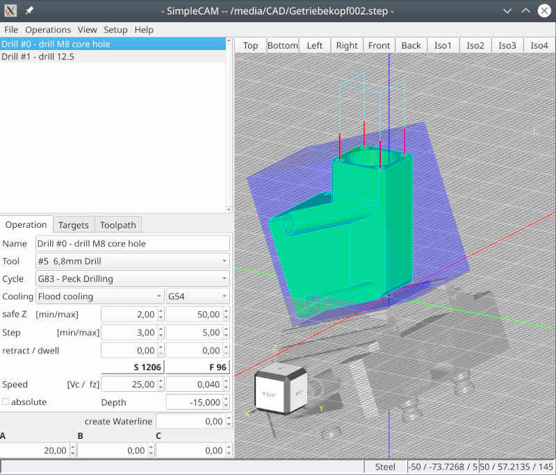

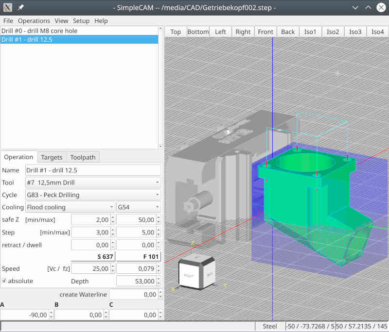

I just finished the workflow for drill operations. I know - the most easy part.
Anyway - the steps from cad model to postprocessor output are there, so I can start with more challenging parts.
My 5axis test model - just the main drill operation for each side:
and resulting gcode file from Fanc-postprocessor (Fanuc because I know that dialect best):

( Drill #1 - drill 12.5 );
( T7 12,5mm Drill - D:12.5 L:150 );
N20 G0 G90 G54 X40.000 Y15.000 S637 M3 T5;
G43 H7 Z50.000 M8;
G83 Z53.000 R2.000 Q5 F100;
X40.000 Y95.000;
X-40.000 Y95.000;
X-40.000 Y15.000;
G0 G80 G90 Z150 M5;
M9;
G91 G28 Y0 Z0;
M30;

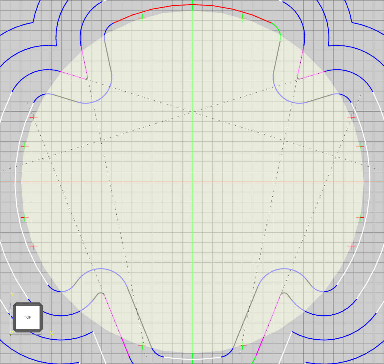

I don't know what to do anymore.
Here's the result of calculations. At first step I dedicated to cutting straight lines only (rendered in purple).
6 lines so 12 possible cutpoints. The cutpoints calculated are the little crosses at circle border.
To understand what's going on, I loaded a screenshot in incscape, where I extended the lines to cut.
4 lines seem to got the correct cutpoint, but only at the wrong side. The other cutpoints have no visual relation to any curve segment.
Does anybody have an idea, what I did wrong?
- Reinhard
- Posts: 508
- Thank you received: 94
09 Apr 2022 05:02 #239707
by Reinhard
Replied by Reinhard on topic simple linux cam
... and here's the code:
Handle(Geom_Line) line = Handle(Geom_Line)::DownCast(c);
qDebug() << "cutCurve (line):" << first << " | " << last << " <> " << orientation;
double dx = p1.X() - p0.X();
double dy = p1.Y() - p0.Y();
double gf = dy / dx;
double cf = rMaster / sqrt(1 + gf * gf);
double dr = sqrt(dx * dx + dy * dy);
double D = p0.X() * p1.Y() - p1.X() * p0.Y();
double res = rMaster * rMaster * dr * dr - D * D;
double cx0 = cf * gf;
double cy0 = -cf;
double cx1 = -cx0;
double cy1 = -cy0;
if (res <= 0) qDebug() << "OUPS - fine calculations means no cutpoints?!?";
qDebug() << "cutpoints: " << cx0 << " / " << cy0
<< " and " << cx1 << " / " << cy1;
Core().view3D()->createAxisCross({cx0, cy0, 0}, 2, nullptr, Quantity_NOC_BLACK);
Core().view3D()->createAxisCross({cx1, cy1, 0}, 2, nullptr, Quantity_NOC_WHITE);
double param0 = ElCLib::Parameter(line->Lin(), {cx0, cy0, p0.Z()});
double param1 = ElCLib::Parameter(line->Lin(), {cx1, cy1, p0.Z()});
if (param0 >= first && param0 <= last) {
qDebug() << "first cutpoint is part of line segment ==> "
<< first << " <> " << param0 << " <> " << last;
// edge = BRepBuilderAPI_MakeEdge(c, {cx0, cy0, p0.Z()}, p1);
else if (param1 >= first && param1 <= last) {
qDebug() << "second cutpoint is part of line segment ==> "
<< first << " <> " << param1 << " <> " << last;
// edge = BRepBuilderAPI_MakeEdge(c, p0, {cx1, cy1, p0.Z()});
else {
qDebug() << "?!?!? - none of the calculated cutpoints is inside of line parameters?!?"
<< first << " <> " << param0 << "|" << param1 << last;
edge = BRepBuilderAPI_MakeEdge(c, first, last);
}Please Log in or Create an account to join the conversation.
