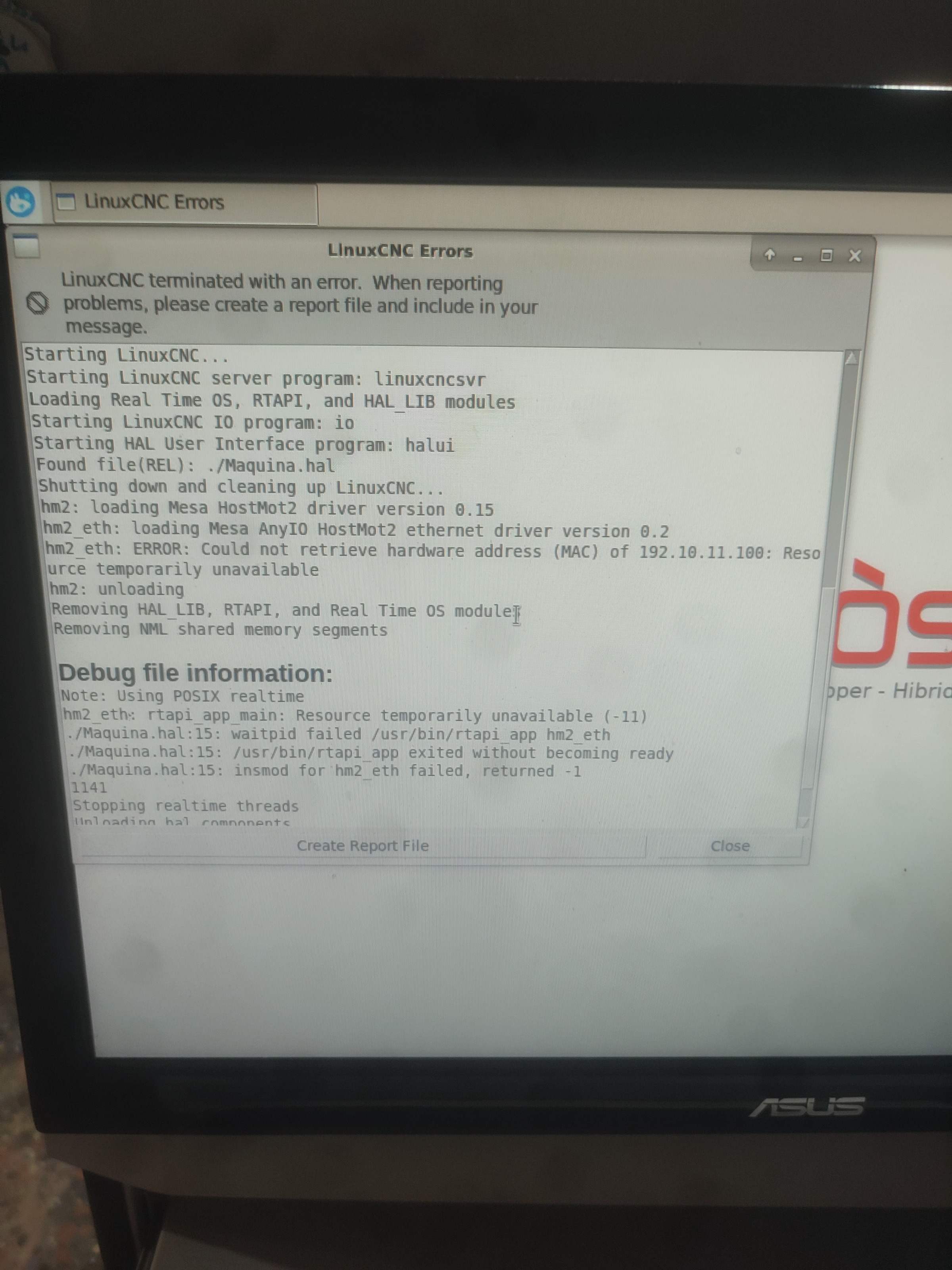

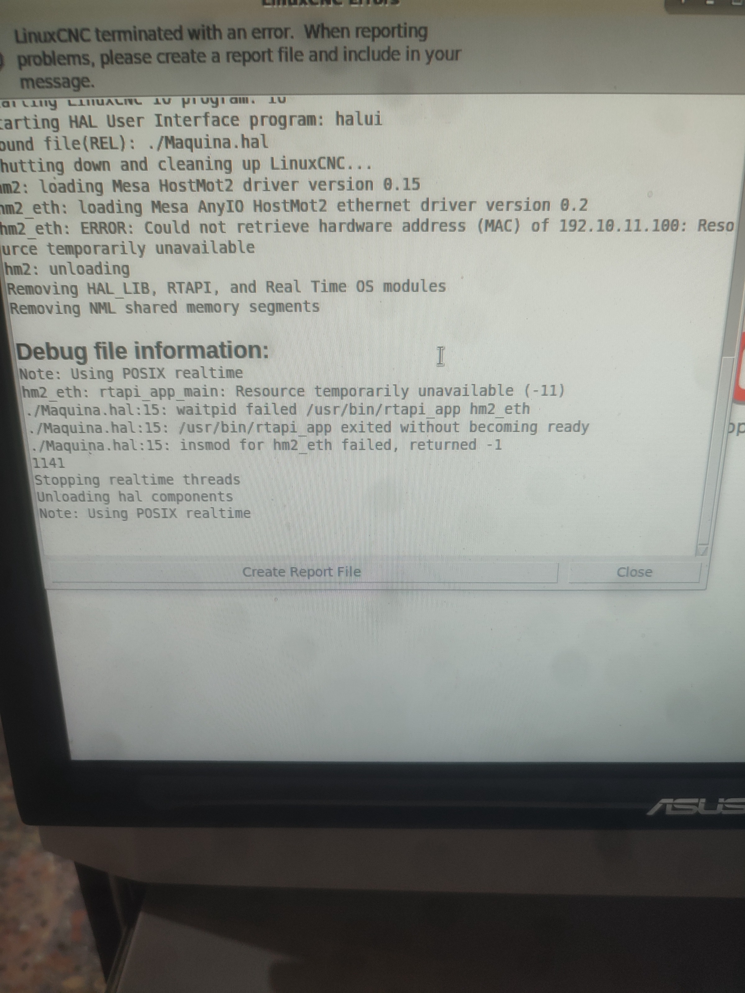

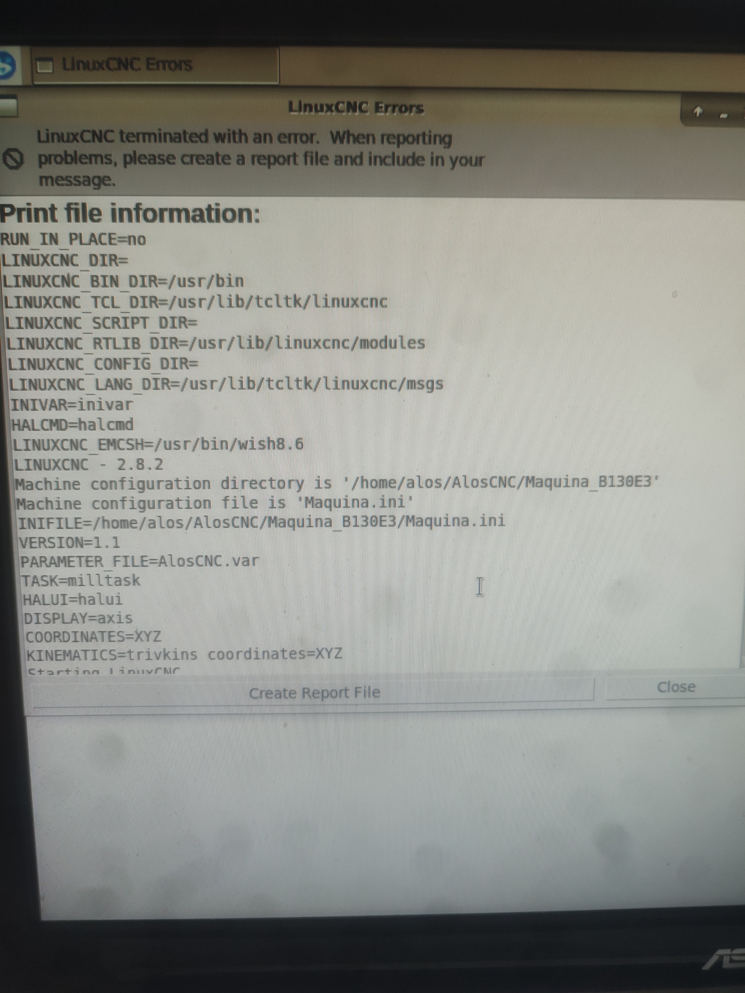

Buenas salta un error en mi cnc
- Posts: 21998
- Thank you received: 7488
01 Aug 2024 13:23 #306612
Replied by tommylight on topic Report of work
1. Mesa must be wired directly to PC
2. set up the networking using network-manager:
forum.linuxcnc.org/27-driver-boards/3559...ethernet-mesa-boards
