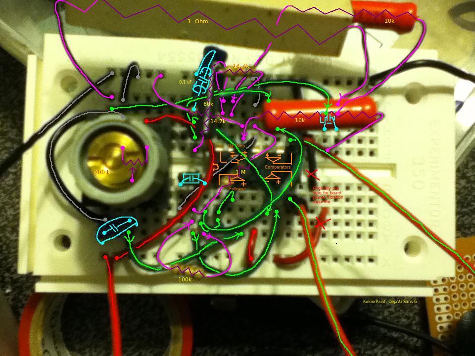

29 Jan 2012 01:04 - 29 Jan 2012 01:12 #17246 by dsoodak
I took a break from looking at LinuxCNC documentation to actually build the spindle motor current monitoring circuit. This ended up being much harder than expected. Both power and ground had high frequency noise from the switching power supply plus a noisy sine wave as it tried to keep up with the varying current draw of the DC motor.
It's been so long probably noone is looking at this thread anymore, but here's a picture of the bread board rat's nest after I finally found a configuration that worked. The board has its own power source (a battery), and the voltage/current set point is doubled and each sent out to a different output comparator so that I have a hysteresis to work with.
