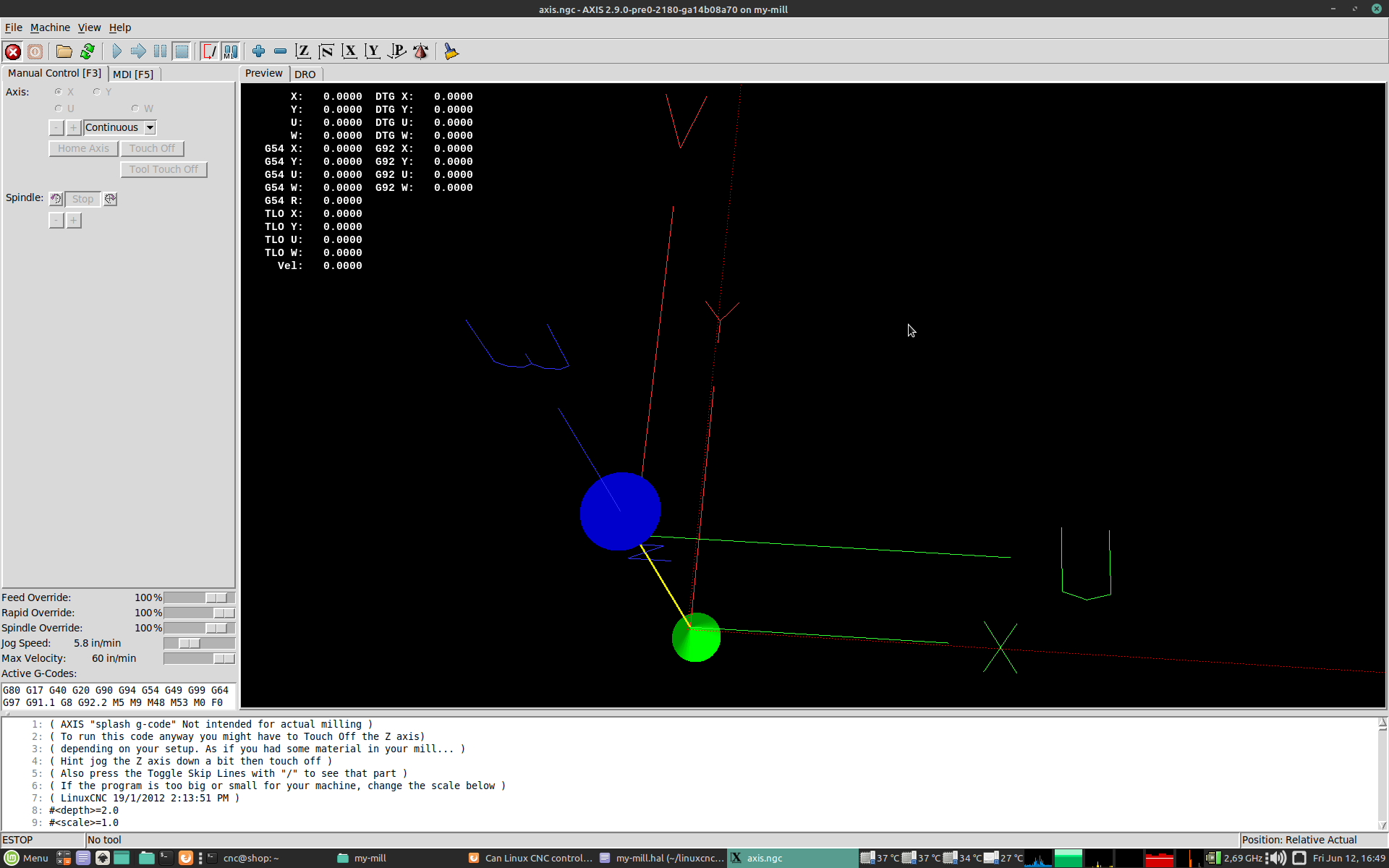

Replied by bbsr_5a on topic Can Linux CNC control twin turrets?
Hi
you need to set in Display
GEOMETRY = XY;UV
FOAM = 1
to get 2planes
GEOMETRY = XY;UV
FOAM = 1
to get 2planes
- Posts: 4819
- Thank you received: 2177
12 Jun 2020 05:19 #171242
Replied by Aciera on topic Can Linux CNC control twin turrets?
That would be what andy was referring to:
The AXIS GUI can handle XYUV foam cutters but I don't think anything does a preview for XZUW.

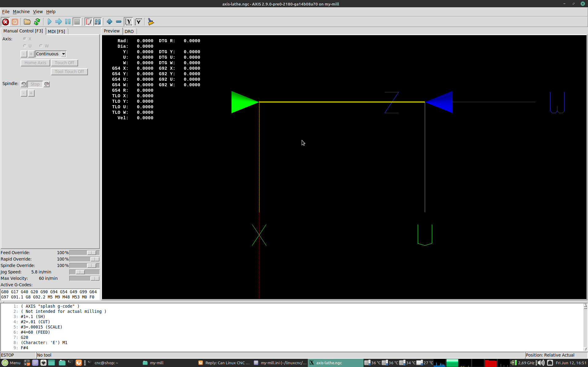

12 Jun 2020 09:30 #171255
by bbsr_5a
did you check if you set
GEOMETRY = XY;UW
FOAM = 1
LATHE= 1
GEOMETRY = XY;UW
FOAM = 1
LATHE= 1
- Posts: 22051
- Thank you received: 7509
12 Jun 2020 09:52 #171259
While adding LATHE=1 results in this:
Nice.
Replied by tommylight on topic Can Linux CNC control twin turrets?
That results in this :did you check if you set
GEOMETRY = XY;UW
FOAM = 1
Nice.
