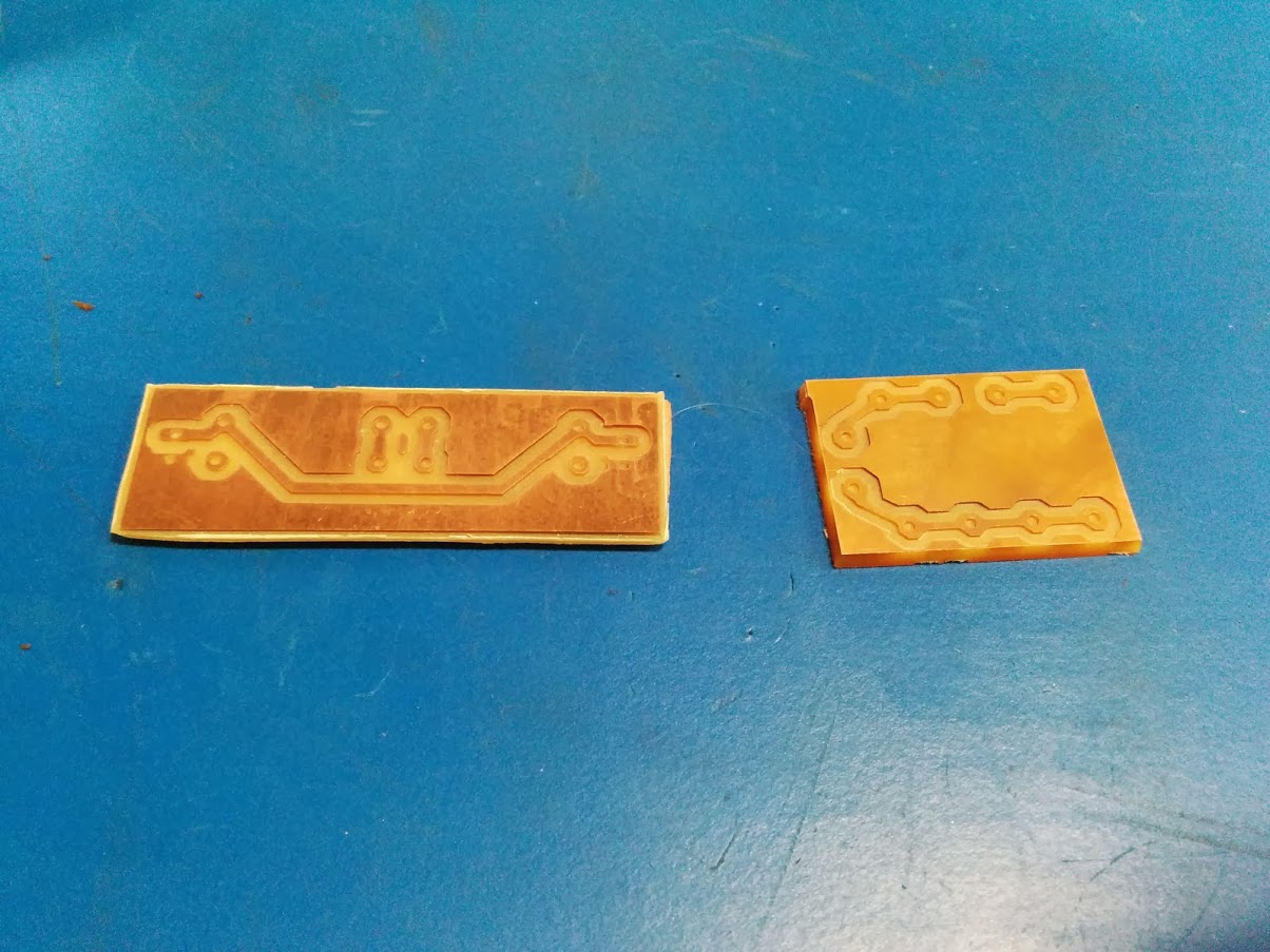

Hey. So I've gotten a few things made. Still so much to learn and it feels overwhelming! I've made a pc board and now i need to just keep moving along. Next is height probing and also the touch off using EMC. I think that is what you call the touch off part...
Anyway, i thought i'd let you in on what I've done.
21 Feb 2014 18:46 #44040 by DaBit
Replied by DaBit on topic Dell Optiplex 745, test axis fails!
Looking good! I like the clean edges. This was my first PCB-milling attempt :
One tip: try to only mill the copper and hit as little glass fiber as possible. The glass dulls the endmills and engraving bits quickly.
You've got some very fine vias in there! What program are you using? I've been using EagleCAD with the PCB2Gcode pluglin but my shapes don't look like yours one bit! What's this board of yours for? looks like some higher voltages, what's the max voltage and current you've been running through these boards? also temp you've seen it withstand...
Agreed, and I've read many many many posts about this, this is the reason i'd like to have a cheap height probe to map the heights of the PCB before milling. I'd like to have a simple conductive probe and only use it for when doing PCB's for now. Later if i really feel like it and actually know how to use everything i have so far i'll get the nice probes or build one by then.

The board has also been made using Eagle. The holes you see are not via's (board is single-sided) but 0,6mm drills for the components. Many of them are SMD though; I hate bending and clipping off the legs of every resistor I need. SMD is much easier.
Schematic
Board
And indeed, it uses 350VDC at 5Amps to control a Kress FME1050-1 router spindle.
For processing it to G-code I used CamBam. I was not very satisfied with the Eagle pcbgcode plugin. The separate 'PCB2Gcode' Linux program is a bit better, but it still doesn't match CamBam's flexibility. CamBam also allows me to draw in the extra isolation distances needed, for example.
I like CamBam; it's a lower-end CAM program but so far it handles all 3-axis milling work well and it is affordable.
