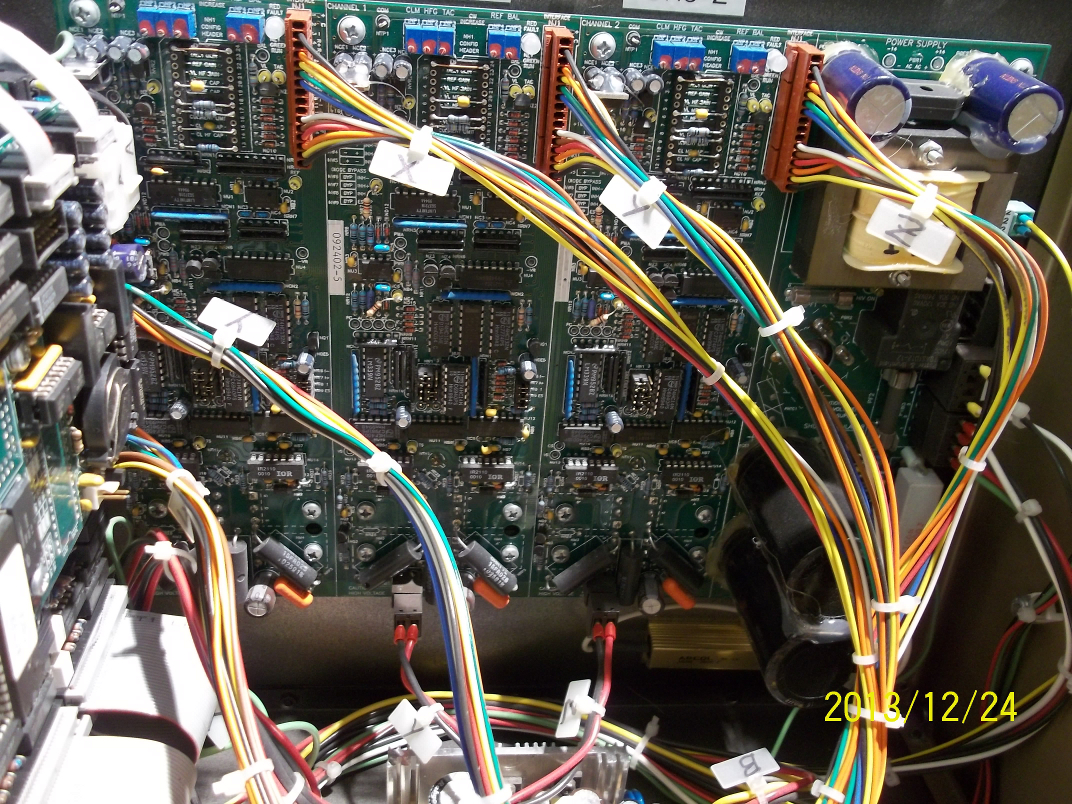

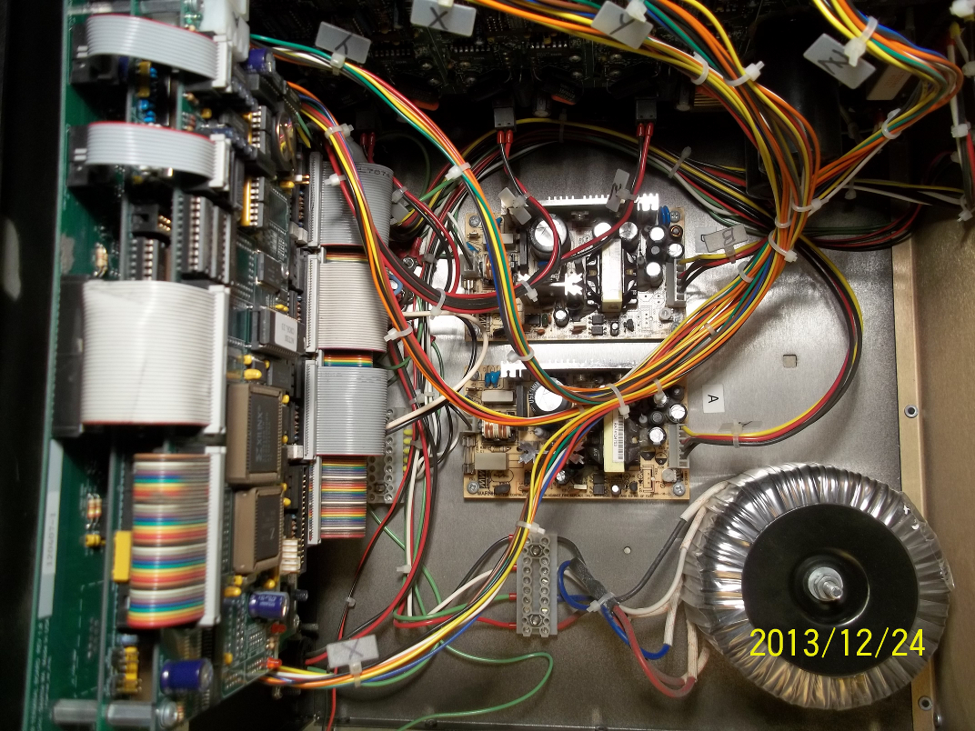

20 Feb 2014 02:05 - 20 Feb 2014 02:12 #43986
Replied by PCW on topic CNC Router Rebuild
100_0620.JPG looks like a custom but fairly standard 3 channel analog velocity mode
drive for brushed motors. The main motor power supply is also included on that card
(the large toroid transformer in 100_0622.JPG is part of the motor power supply as well)
The trick will be finding the locations and types of the analog and control
signals needed to make the drives/power supply work.
Any block diagrams/schematics/manuals or at worst, close ups of any terminal markings
can help here

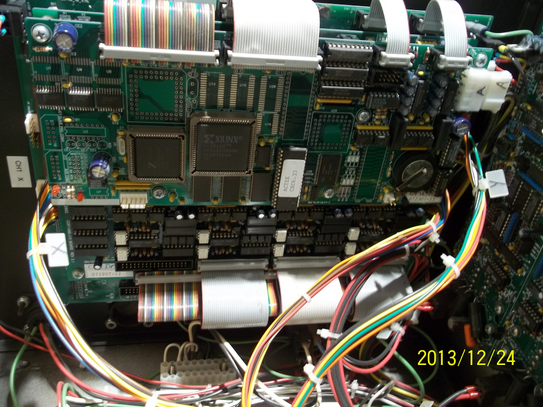

- Todd Zuercher
- Posts: 4782
- Thank you received: 1472
20 Feb 2014 03:23 #43987
Replied by Todd Zuercher on topic CNC Router Rebuild
The amps/drives are on board 100_0620.JPG, the old controler in pic 100_0621.JPG
The red and blak wire pairs at the bottom of board are probably the power to the motors (what makes them turn).
The 3 bundles of 10 wires at the top are probably feedback and control wires. The questions are whay type of feed back and what kind of control?
It isn't looking like you are going to easily find any documentation for integrating these amps with LinuxCNC. It might be easier, to start fresh with different amps/drives. Not that it can't be done.
Like Peter said close up pics of any labeling on the boards near the wire connections could be quite useful and give good hints to what they might be. Check the labeling, both where they connect to the drives, and where the other end of the wire goes (ei the lableing on the old control boards). If some of these wires go directly to the motor or if they all go to the old control board.
